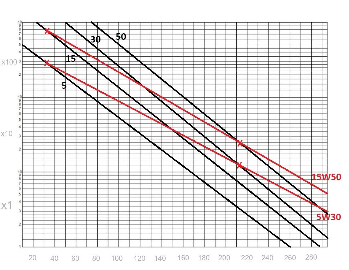

Originally Posted by 67:72
Thank you for the introduction to centistokes — I had never heard that term before, so hit Google. Feel free to PM me your reply if you are willing to answer but do not wish to do it here. Alternatively, a link to a website explaining in layman's terms would suffice.
Does a multi-grade oil exhibit the characteristics of all of the weights in its range depending on temperature it's being subjected to? For example, will a 15w-50 behave like a 30 weight at moderate engine temperatures and only behave with the 50 weight characteristics when the temps reach 200°+? Is it like a sliding (no pun intended) scale of characteristics from cold start to full operating temp? If it is a continuous variability, wouldn't a 15w-50 and a 10w-30 show the same characteristics at 200° and only become distinct above that where the 10w-30 would fail?
You are almost correct, but the temperature scale doesn’t slide. The W number is always taken at 32F and the upper number is always taken at 212F. Viscosity plots as a straight line on semi-log graph paper. That’s a slight fib because it’s never a dead straight line, but it’s close enough for this discussion. The black lines on the plot at the bottom of this post show the mid points of the ranges for 5, 15, 30, and 50 single grade oils. The horizontal axis is temperature, spaced in normal, linear fashion. The vertical axis is viscosity in centistokes, spaced in logarithmic fashion, hence the name semi-log since only one axis is plotted logarithmically. The red lines are multi grade 5W30 and 15W50. To plot them, you mark an X on the appropriate lines at 32 (for the W number) and 212F (for the upper number) and connect them. The result shows that in a multi-grade oil like the red lines, the viscosity does not change as fast with temperature changes as it does in a single grade oil like the black lines.
For additional background which you did not ask about, but might find interesting, prior to the 1970’s, almost all oils were single grade dino oils. The exception was Pennsylvania grade oil such as Pennzoil and Quaker State. For reasons best known to Mother Nature, oil deposits in Pennsylvania had by far the highest concentration of isoparaffins of any oil every found anywhere in the world, and isoparaffins have very high VI (viscosity index, a measure of how well an oil resists viscosity change with temperature). So Pennsylvania grade crude oil would make a 10W30 multi grade oil right out of the ground without use of VI improvers. The Pennsylvania grade crude oil is now pretty much gone, so Pennzoil and Quaker State (now owned by Shell) had to find other ways to make multi grade oil. There are two: VI improver additives and use of synthetic base stock, both developed in the 1970’s.
Of the two current day methods, synthetic base stock is better because it will generate a 25 spread in W and upper viscosity grade numbers (like 5W30 with its spread of 25) without using VI improver additive. VI improvers have the problem that they shear with time. The best way to visualize that is by the octopus analogy. VI improver molecules look like an octopus. When cold, the tentacles wrap tightly around the body, so they flow normally through the oil. But when they heat up, the tentacles extend, interfering with flow, and thus raising viscosity. So that counteracts the tendency of the oil to thin out as it heats up. Trouble is, the tentacles can shear off, and once they do, the VI improver molecule has lost its ability to prevent the oil from thinning out with rising temperature. So any multi grade dino oil, and any synthetic with spread between W and upper number greater than 25 (such as a 0W40 with spread of 40) may lose viscosity at high temperature as it wears. Hope I answered your original question and that you found the VI improver info of interest.

I run 15-50 synthetic because I live in Florida and it gets what one might call hot. Synthetic oils flow easier than conventional oils. Also. GM did indeed recommend the weight I run in hot climates

Originally Posted by LDB
I have already admitted that I do not have real world experience with engine mods, racing, or rebuilding. I’ll add that I do not have any direct experience with 1979 L82 Vettes. But oil selection guides from major oil company websites, which are drawn from original GM recommendations, all say either 5W30 or 10W30 for street use in that car in normal climates. So I can’t find any evidence from GM or oil company data that the clearances in that car’s engine are enough higher to matter. I’ll also admit that in 1979, most oils still had zinc which helps flat tappets, so either finding a street grade oil with high zinc or using a zinc supplement is probably wise. But I continue to believe that going to 15W50 to get the zinc is unwise for the reasons outlined in my various posts which you say are irrelevant. So I guess we’re stuck with disagreeing, and the OP and other readers will have to decide for themselves.
I have never built an engine to GM spec. I build them for .002-.0025 on the rods, and .003-.0035 on the mains....for most applications. GM specs are much tighter than that. So your whole basis of your conversation is shot to **** almost immediately.......
Bearing clearance and lifter restriction are the major two points of controlled leak in most V8's of the pushrod regime.....Pro Engine builders open up the clearance from GM spec to improve flow, which reduces temperatures and keeps a good meniscus of oil on the bearing to handle loads.....
If I set a Gen 1 small block to .0025 on the rods and .003-.0035 on the mains, with a flat tappet lifter.....with 15w40 oil I will have 30psi at idle and 60 psi at 5000rpm.....if I go to 5w30 those numbers go down to 25/55....if i run 20w50...those numbers go up to 35/65......
Centistoke ratings are great as a comparison for hot and cold flow but says jack and **** about the oil flow in my Small Block compared to say, a Honda CBX 1000 6 cylinder bike engine that runs .0015 rods and .0015 mains as a sweet spot (These are the clearances of the last one I built a month ago)....so the Centistoke rating is not a viable number to gauge what oil you should use from engine to engine.....it is but a guide....loose clearances require thicker oils and tight clearances require thinner oils......because it is about the flow....and the flow creates the cushion.....cushion is how bearings stay alive. It is a balancing act......so your ranting about Centistoke numbers is pointless here and is a better conversation for 2 Car Guys or some brainless overwrought auto "enthusiaist" platform.....go pitch it to new Jeep owners.....they love that kinda ****.....
Pro engine builders give two ***** about centistoke ratings......they care about Oil Pressure and Oil Flow.......that's the tell.
Jebby
I may be missing something, but I don’t see any serious disagreement between us. As far as I understand this thread, the OP’s car is stock, to typical GM clearances. Obviously, if you have modified the engine to looser clearances, you need heavier oil than GM recommends. I think that in a stock engine on the street with frequent warmup cycles, choosing the right grade of oil for the frequent temperature cycles it goes through is the most important factor because I view the clearance issue as being chosen by the factory and beyond my control. But I concede that if I were building engines and could choose the clearances myself, I’d probably think like you do. So it seems to me like what differences we have can be explained by the fact that you view clearances as something you can choose as you build the engine, and I view them as being fixed at the factory. That in turn means we are both correct for the applications we are talking about. Am I still missing something?
