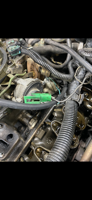

While doing valve cover gaskets, I found the green plug right side of engine near air pump. Comes out of a wire harness that runs along right side of engine. The wire was wrapped around a vacuum hose several times to keep out of the way. Anyone have an 81 automatic that has this green connector? I can't find any loose wire where this connector would plug in. I really have to buy an 81 Corvette shop manual.

Here's a wiring diagram to get you started.

you hook a dwell meter to that and adjust carb mixture
