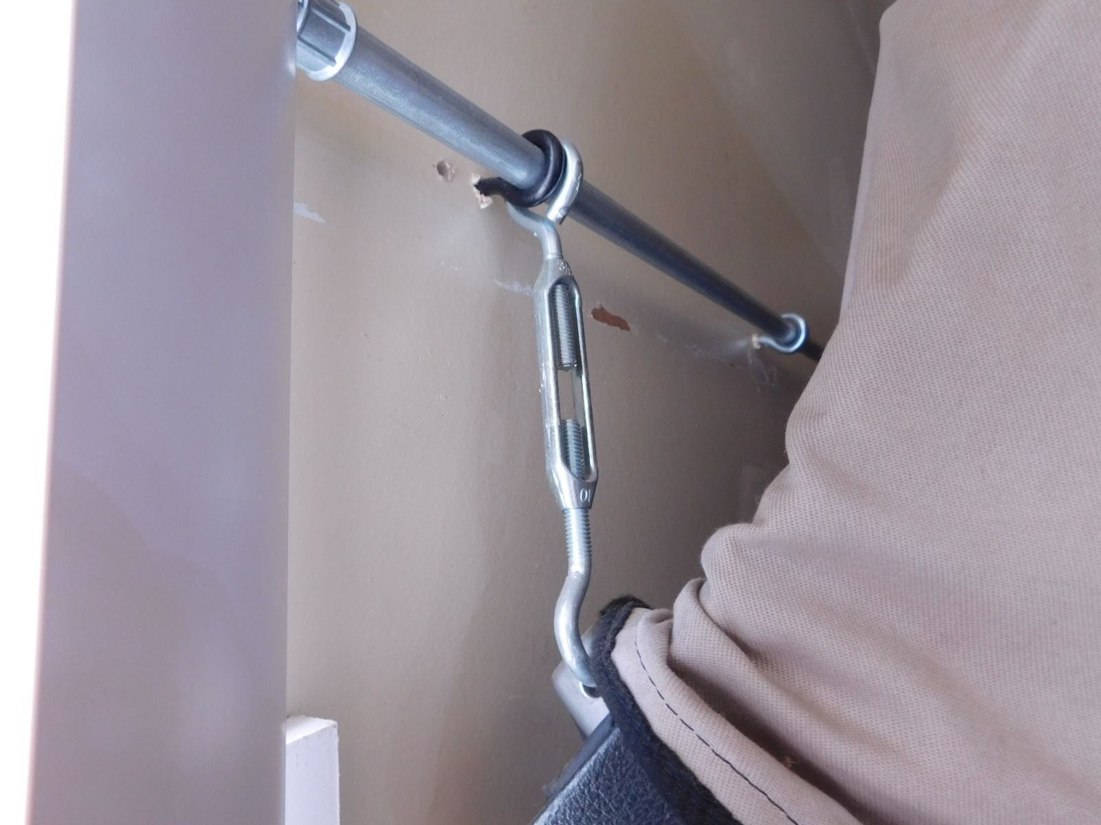

Default Wall HT
I used 1/2" electrical conduit. It is 56" long. I used 4 "eye" lags screwed into the wall studs. The conduit connectors screwed onto the conduit end are simply to prevent it from sliding off the lags.
The HT hangs off turn buckles which have an "eye" through the conduit and a hook, which goes through the HT bolt brackets on the lower end.
I have to lift one side to remove one hook then the other hook to take it down.
