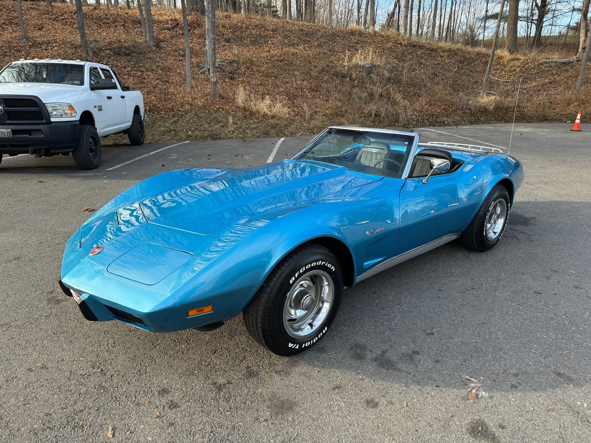

The L48 does not have emblems only the L82 does.
The pics are a 1975 L48
