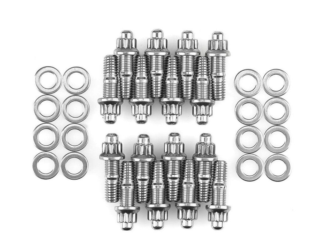

So is this the correct recommended ARP Stud kit for a BBC?
BBC Stud kit
It looks to have 38/" coarse thread studs with the smaller 5/16" fine thread 12 pt nuts on top. Takes 7/16" 12 pt socket vs 9/16" hex.
I love Gkulls idea of a dab of silicone for an anti-vibration locking effect! Genius.
BBC Stud kit
I don't do 12 points unless your primary pipes are designed to be able to get a 12 point socket on them. Which is not the case with 1 3/4 inch SBC. I'm not sure about the posters BBC headers. If the pipes are big you can't even rotate 12 point flare nut wrenches. my head studs are 12 point so the smaller socket will clear the valve springs.
Summit has the vendor catologs which show more stuff than on line, or you can call ARP and get the part number to order from summit. But I use the little 5/16th hex nuts black oxide. 3/8ths hex are so big that they don't clear my pipes.

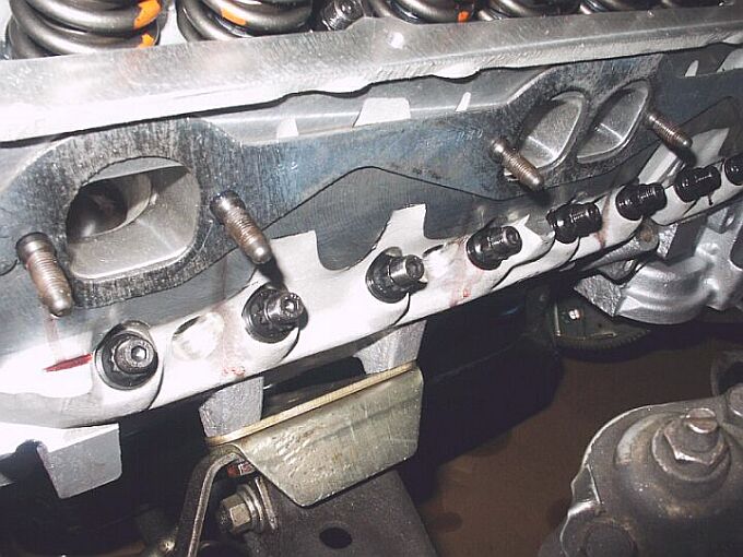

Reusing a felpro blue steel header gasket from the motor I pulled out. You can see red locktight running down the head. The nuts are shouldered is another reason for doing the smaller nuts. SBC exhaust studs are right next to the port on bigger CC aftermarket heads.
Looks like I had to beat the solid engine mount to get it on the frame. They get crushed in from the previouse engine
The 5/16th is even too big for some of my tubes and I had machine off the shoulders for a couple of cylinders. Spin them in a lathe

I get what you are saying. The 12 pt design prevents you from using an open head wrench if needed.
But the only other ARP BBC stud kit I can find, with hex nuts, uses the much larger 9/16" hex nuts, and is 3/8" bolt thread on both sides. Although I believe the nut side may be fine thread,
I do not see a version with the 5/16" nut thread, that also has the smaller hex nuts.
Maybe that version is only offered for SBC and not BBC?
Actually I do not see that listed by ARP at all.
Did you do something custom? Or order the small hex nuts separate?
That is why I said to call. Summit has Vendor parts books that the tech guys can look through or call ARP

What your engine builder was talking about for BBC is that you can't just install all the studs and then fit the headers over them like a SBC.
What we have had to do is to put one or two studs on the front cylinders. Then the gasket and headers. Then through the header flanges holes run the studs in. studs only go in finger tight. I've also double nutted them to get them snug. The whole Idea of a stud is that it doesn't hurt the threads and pull on all of them equally
