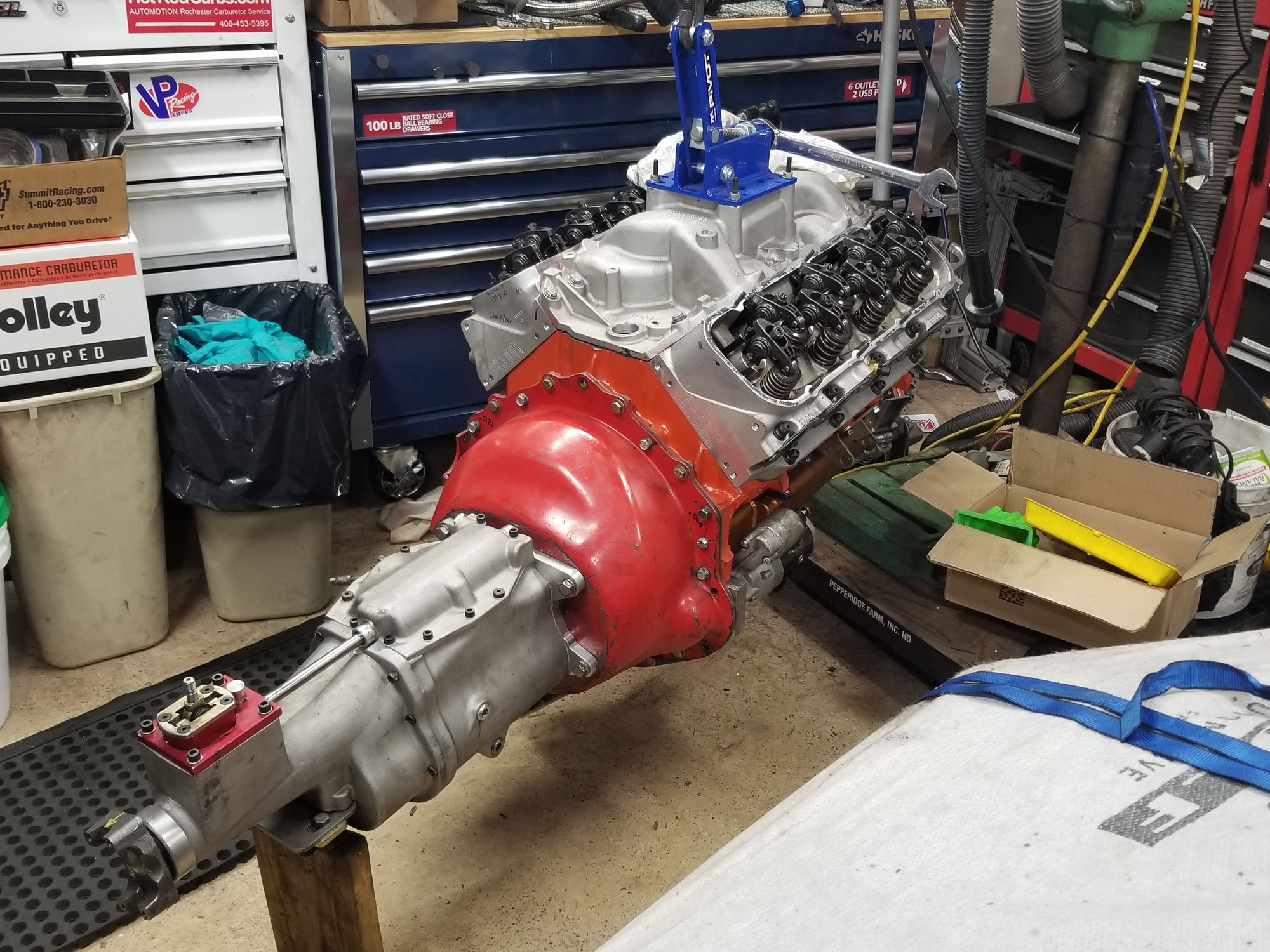

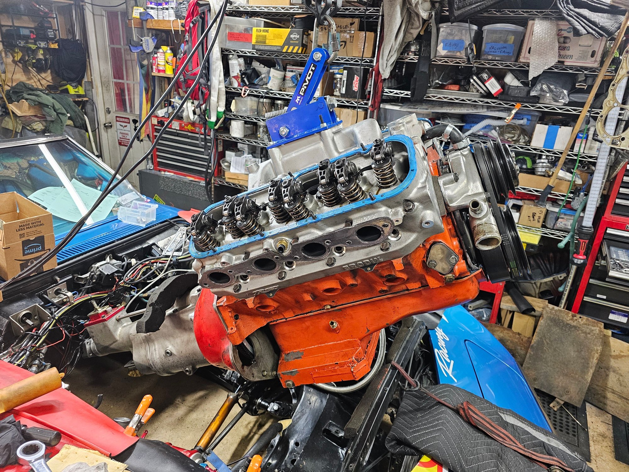

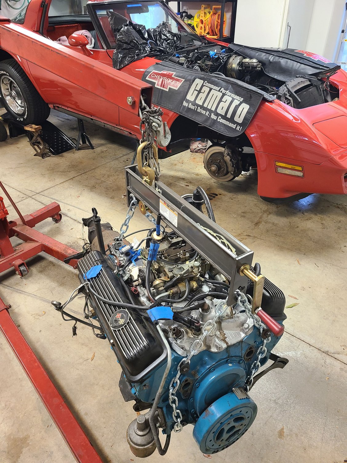

Use heads in front, manifold in back. Tilt radiator support forward by pulling the 2 bolts on each side out from inside the front wheel wells. Might have a center support under front of car attached to the radiator support.
This is attached at the back of the heads which does work but the rear manifold attachment gives you a little more room to work.

Yes you do have room to remove bokts but it is tight and you will drop them...the tilter on the manifold will support a long block motor with tranny and steel bell housing...i did it to a 427 which would be 150lbs heavier than a small block

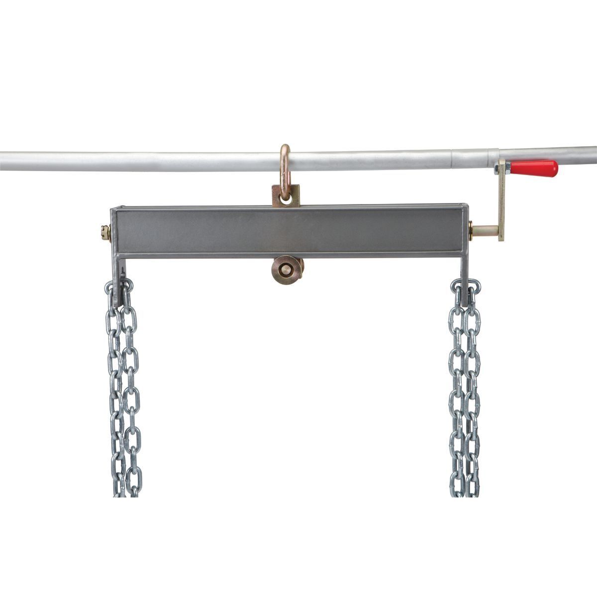

$45 at Harbor Freight. You can get the cheaper one to save $5 but its not near as stout. Be sure to lube up the drive screw with lithium grease before the first use. Its not super high quality but it gets the job done. Very heavy.

Also replace the handle as it will coninually fall off. Also buy an additional weight approved caribiner or shackle to attach to the chain of the hoist if the hook isnt big enough....And i also bought lift brackets for the block so i wasnt trying to stuff a bolt through the provided chain and it didnt dig into the aluminumheads....
https://www.amazon.com/NOVINO-Lifting-Capacity-Levelers-Colorful/dp/B0BKFDVDVH/ref=asc_df_B0BKFDVDVH&mcid=3792b59e94303 c859603bab14e17ea1e?tag=bingshoppinga-20&linkCode=df0&hvadid=80882915732967&hv netw=o&hvqmt=e&hvbmt=be&hvdev=m&hvlocint =&hvlocphy=&hvtargid=pla-4584482478100945&psc=1
There are many reasons i got rid of that pos and bought the correct tool for the job from Macs

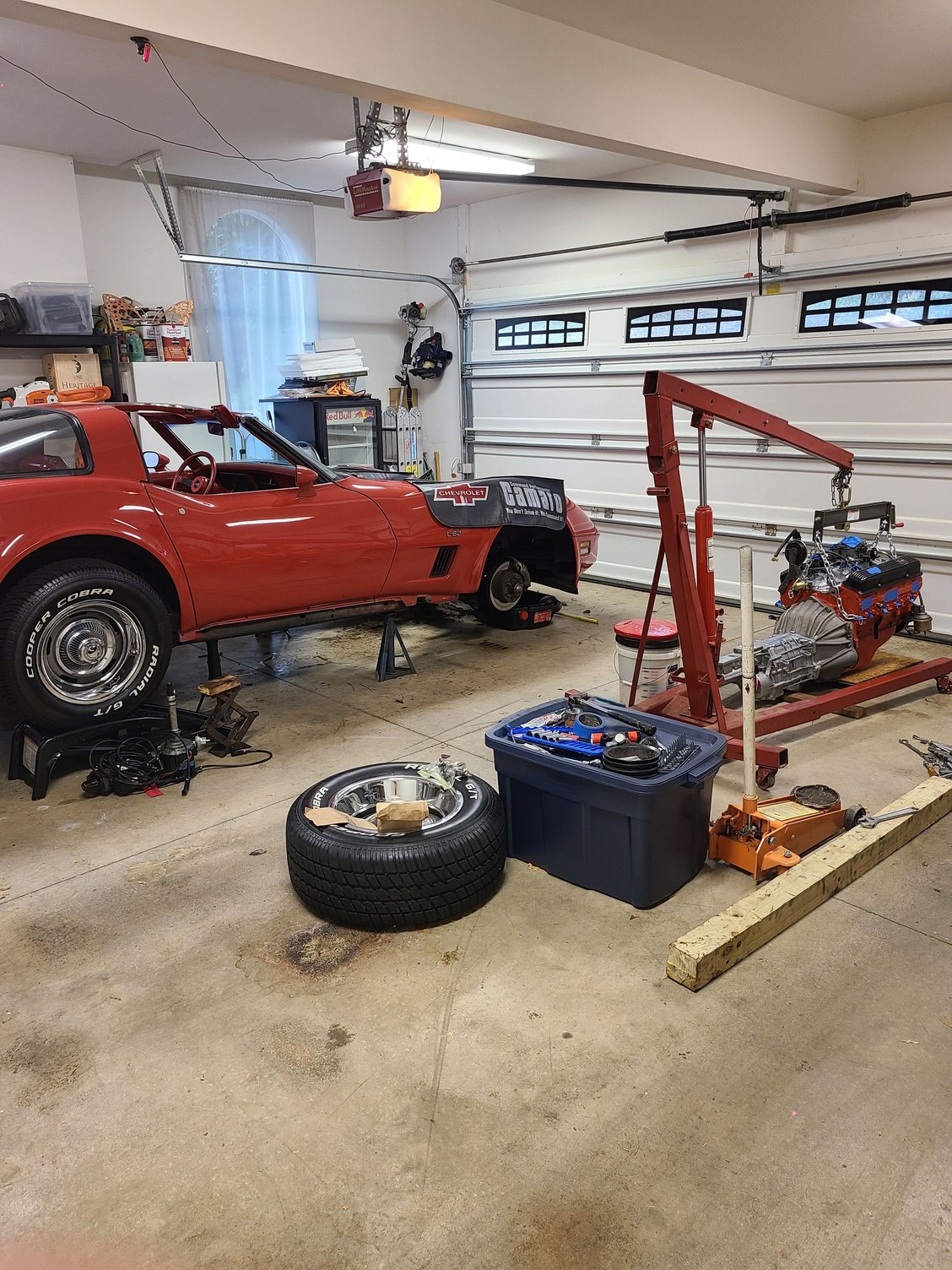

I've owned my Vette for 25 years and have had my engine and 4 speed out and in 3 times as a unit without issues other than the hoist I rented wasn't long enough to go from the front so I went over the fender. I do have a screw type leveler seen above but it's a good one not from Harbor Freight. Makes it easy. I do suggest you get another set of eyes to help.
