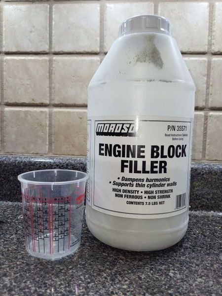

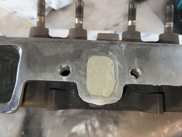

Old Mar 30, 2024 | 12:11 PM
Tech141's Avatar
Tech141
Joined: Oct 2022
Posts: 1,063
Likes: 170
From: Buckeye Lake, OH
Filled the exhaust x-ver ports on the heads with block filler this morning. Used duct tape to block the ports in the cylinder head combustion chambers, and jammed some paper towels in the bowls to give some support/backing to the tape. Propped the heads up so the port is level as possible. Mixed up 6.5 oz of Moroso Block Filler to cake-batter consistency so it will flow down the passages. 24 hours will tell the tale if I did this correctly.
X-Over bowl port
Port covered with duct tape
Jammed paper towels in the bowls for tape support
Moroso block filler
6.5 oz in a cup
Mixed to cake batter consistency for flow.
Filled. Waiting 24 hours for curing.

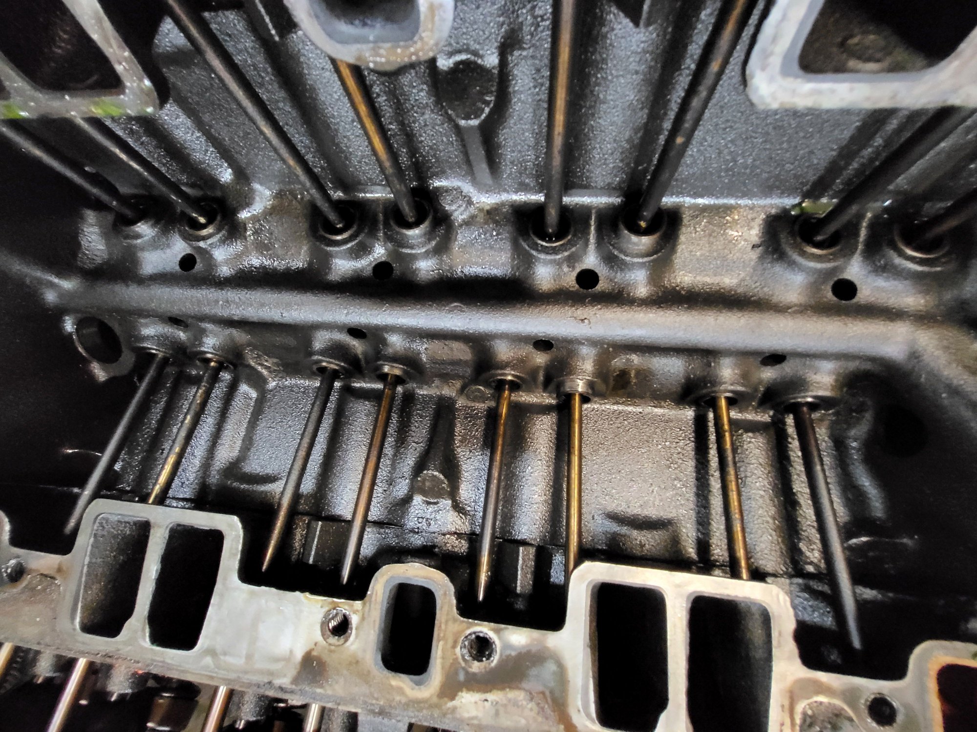

Old Mar 30, 2024 | 05:21 PM
  #33
Tech141's Avatar
Tech141
Joined: Oct 2022
Posts: 1,063
Likes: 170

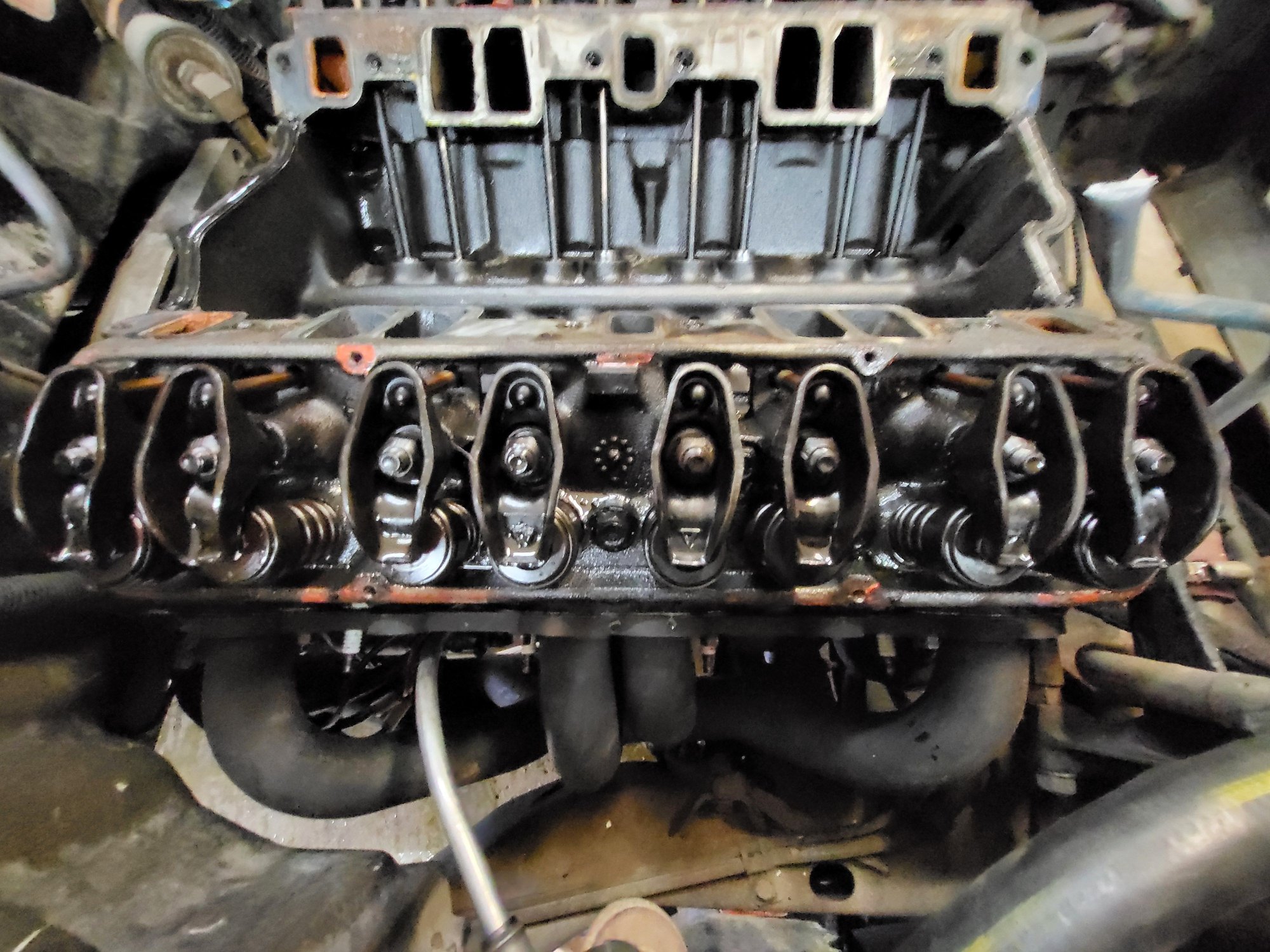

Here are some pics of the heads and lifter valley taken right after the intake manifold and valve covers were taken off. I was happily surprised that there was no gunk/crap that you usually find in a 44 year old engine.
No gunk after 52K miles.
Clean lifter valley. All I did was dip a paper towel into the standing oil puddles around the lifter bore holes. Outstanding!

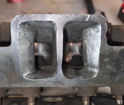

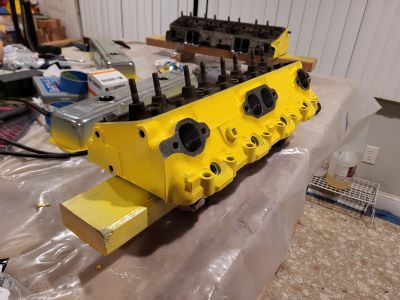

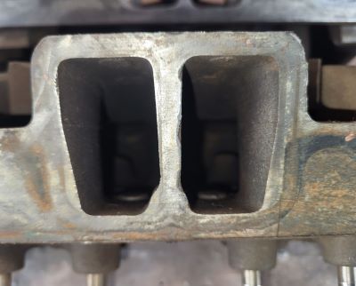

Old Apr 9, 2024 | 01:52 AM
  #34
Tech141's Avatar
Tech141
Joined: Oct 2022
Posts: 1,063
Likes: 170
Finished the heads as far as painting/porting. Still have to put the valves/springs/etc... on.
I think I opened the ports/runners pretty good.
Original intake ports/runners. lots of extra stuff that needs to go.
After grinding. Opened them up pretty good. This is a pic of the average set.
And after priming/painting. I know how folks here love Yellow.

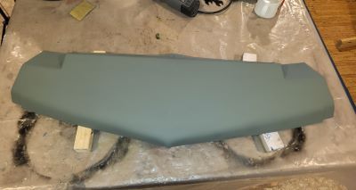

Gave the Front Lower Valance some love while it was out of the car....
Went from this....
To this.....
And finally this. Daytona Yellow.
