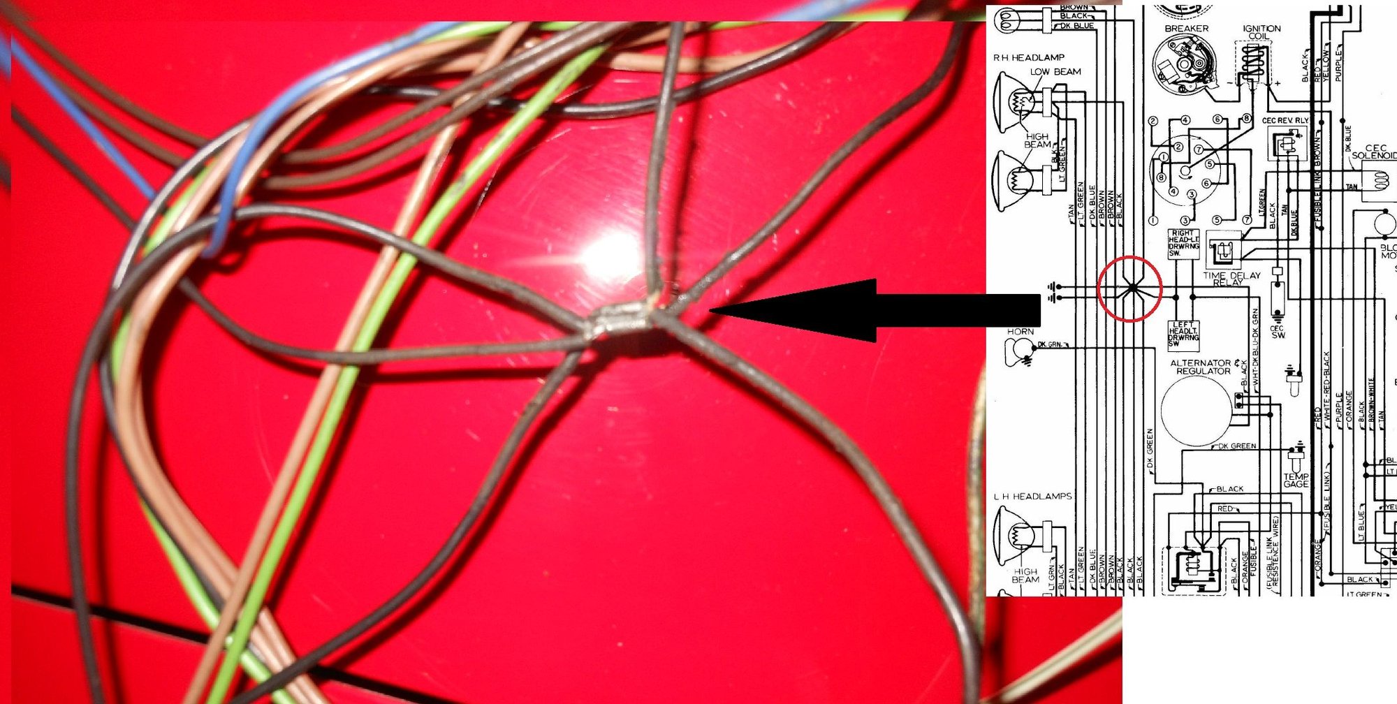

The headlight switch is grounded at the switch itself- only to operate the courtesy lights. The only other ground for the headlights is at the front of the car-
A loose ground on the headlights usually causes funky issues- not turning off the headlights off and on.
The headlights will "see" a ground through the other bulbs- lights will be dim- the turnsignal indicator will light in the dash etc-
Electricity not only takes the path of least resistance - but all paths
Looks like OP has found the problem- repo switch-.
GM's cost effective way to ground the whole front electrical system-
