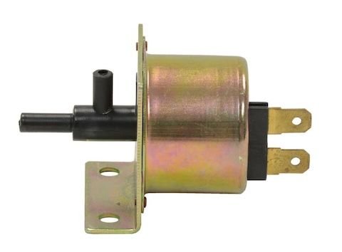

Behind the tach is a solenoid/vacuum switch. When the dash wiper switch is activated, it triggers the solenoid to change the vacuum to open the wiper door. Once the door is open, an arm in the linkage triggers an electrical switch on the firewall that allows the wiper motor to begin cycling. You may have a wonky solenoid???

I removed the wiper vacuum solenoid from behind the tach, what a PITA. It tests good, holds a vacuum seal until voltage is applied. It’s a sealed unit but should be a simple solenoid winding inside with continuous continuity. Power just activates the solenoid and valve. Don’t see how it could be grounding the system.

The tach solenoid doesn't sound to me like it could be the issue- it just operates the door when it sees a power and a ground.

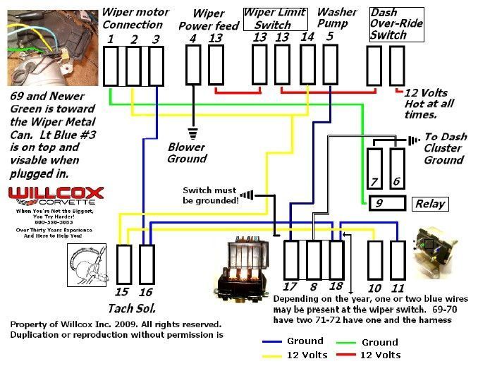

this is the schematic i was referring to
To Random wiper operation

Found this..its has more diagrams and input from Wilcox that may or may not help,,its posted as a different issue but th ediagrams was what I was after
https://www.corvetteforum.com/forums...th-wipers.html

Thank you for the schematic and link, good information. I haven’t had a chance to drive it since I put it back together. For now I left the wiper switch disconnected to see what happens. If they do come on again I’ll pay attention to the speed. I may have a grounding issue because while aiming the headlights they started flickering on and off. The car is new to me and I had not used the headlights before changing the headlight switch which was defective on the air side. No idea if it’s the new switch or an existing issue. I’ll start troubleshooting the headlight wiring today.
