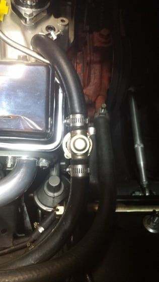

Don't overthink this. Get one of these and just route the heater hoses together. This is what I did and it's been like that for 20 years.
Damn I need to clean that frame rail!!!!

I want to be able to open and close the valve if needed. Your modification doesn't allow that.

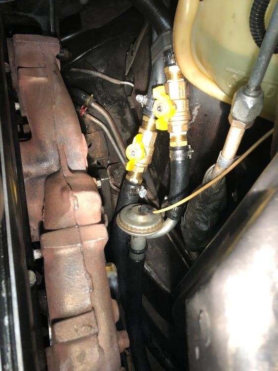

My 2 valves, and keeping original vacuum shut off
how about some pics?
https://www.corvetteforum.com/forums...e-79-w-ac.html

I don't think I have that vacuum control. My car doesn't have AC. I would need one 5/8" and one 3/4" valve. Your 2 valves are what I am looking to do.
Thank you

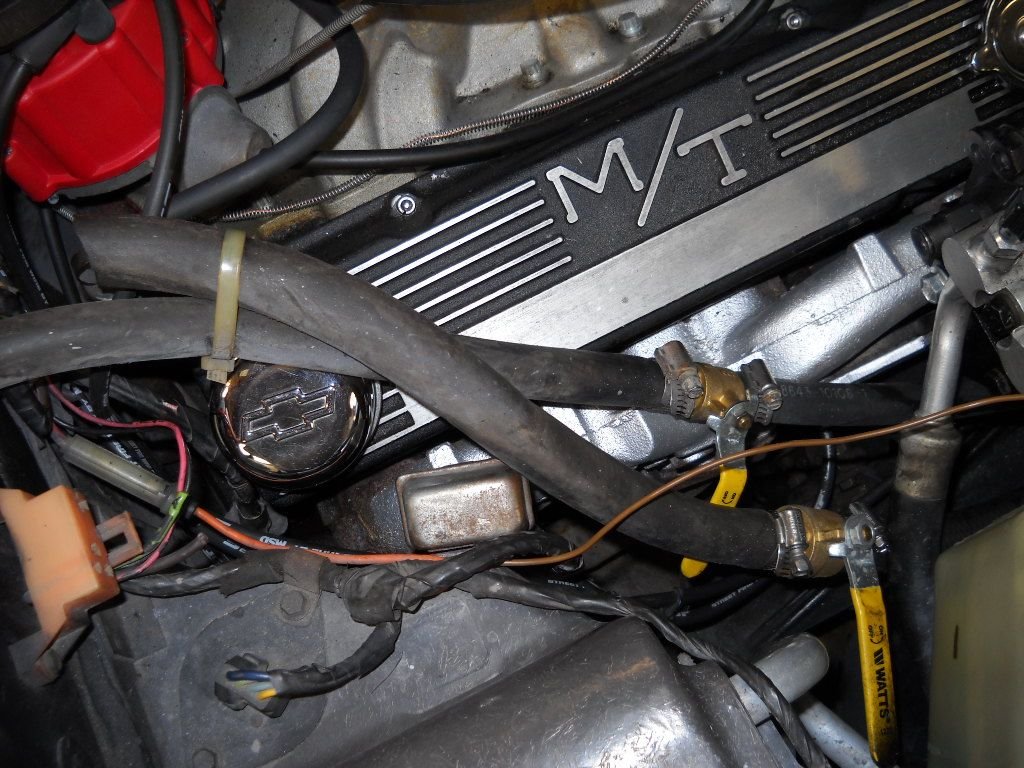

I got 2 shutoffs from Home Depot for about $15 and spliced them into the lines/hoses. I never use the heater but all I need to do is flip the levers if I want to.
