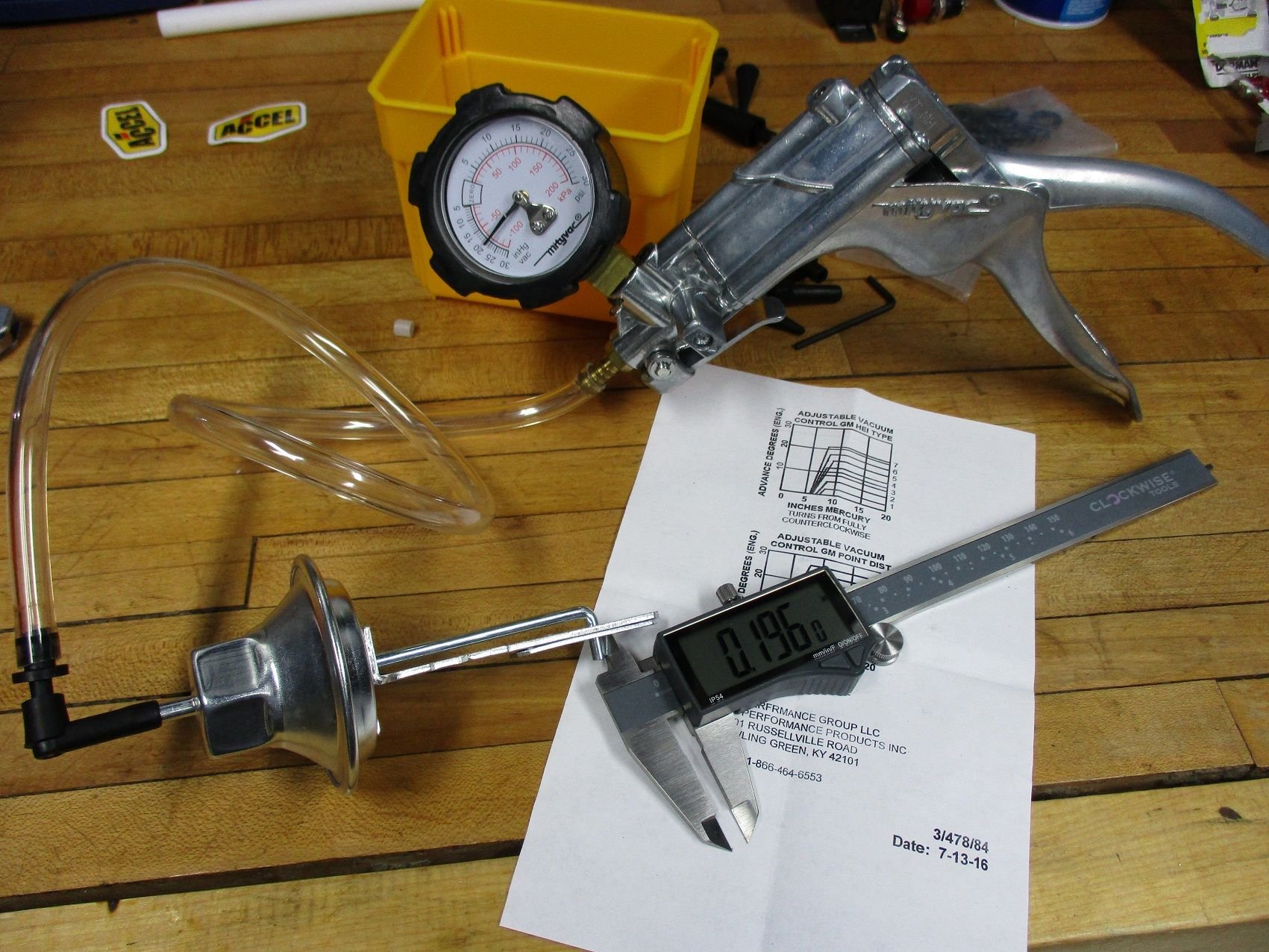

Once you have the mechanical advance nailed down, you can use a Mity-Vac to manually pull the vacuum can. This can tell you the max vac advance available, and confirm that it is working at all. But the mechanical advance must be done first, with the vacuum can disconnected (and the vacuum leak plugged, though that won't affect timing).
Here's a post where I was bench-testing an adjustable vacuum can. You can do the same on the car with a dial-back timing light, or timing tape.
Originally Posted by Bikespace
I have the same Accel vacuum can on my 79. Below is an image from the bench tuning, when I was confirming that full engine vacuum would result in only 12 degrees of vacuum advance (it did!). My application was a stock L48 SBC with a new ZZ4 takeoff distributor. The adjustable hard-limit method that Lars suggests may work just as well, or better, and will also work with different vacuum cans working in different vacuum ranges, for example on cars with a big cam. You can see in my image below the vacuum range the Accel can expects.
One additional thought. I replaced my stock, worn-out distributor because it was not advancing smoothly. I used the ZZ4 with the stock (to that dist) weights, and used one soft and one medium spring from a Mr. Gasket kit. I also shimmed a brand-new, out of the box distributor to minimize endplay. This gave me all-in at 2800 RPM or so, which I set to 36 degrees (stock SBC). Equally important, I got zero mechanical advance at idle. My total initial timing was 15 degrees BTDC: 36 full, minus the 21 mechanical. Add another 12 degrees from the vacuum advance for an actual 27 degrees advance at idle.
Were you able to confirm that your distributor is returning to "zero" at idle, with the vacuum disconnected? You had mentioned soft springs earlier, so it is worth confirming.

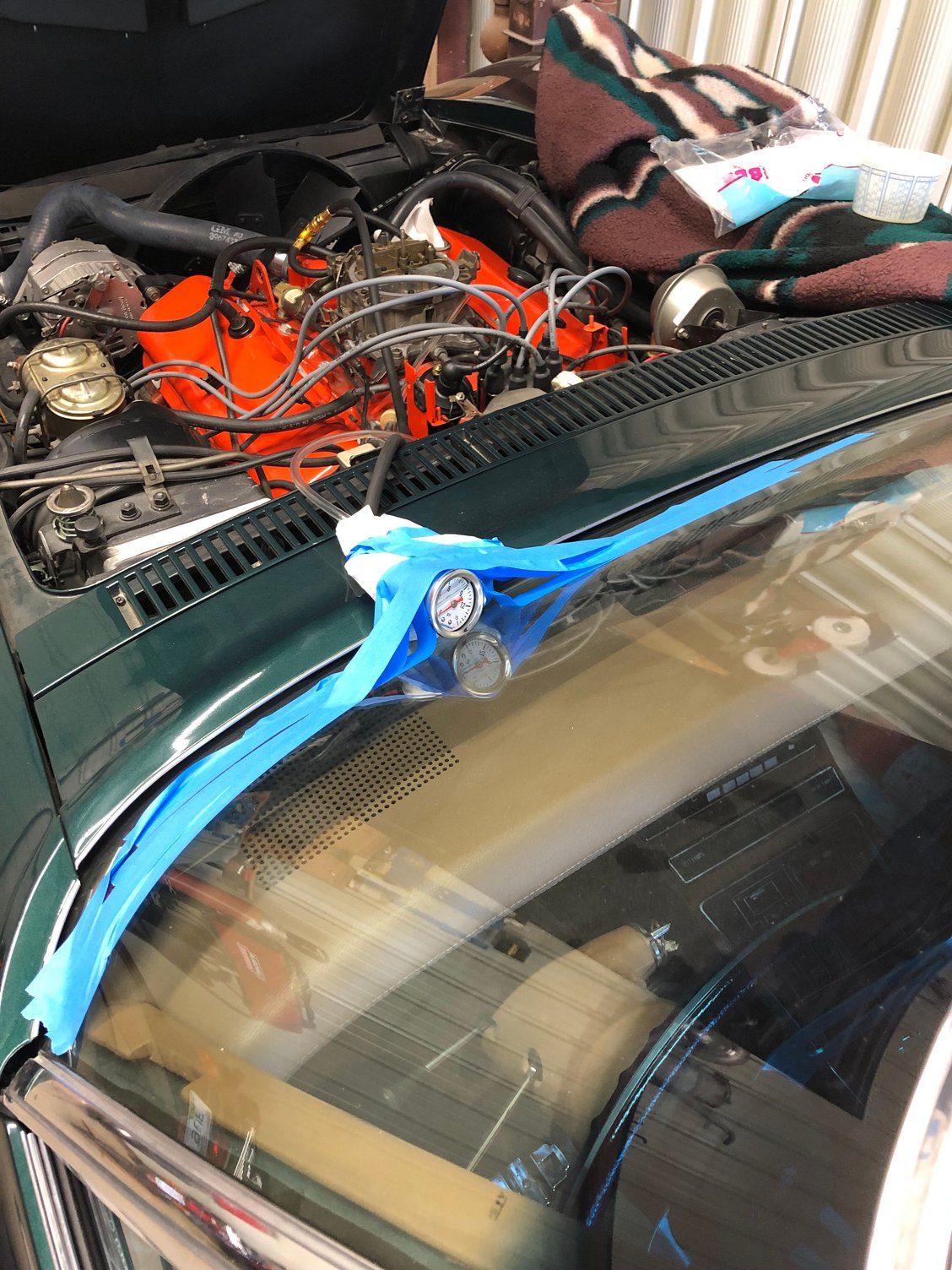

I set the fuel gauge up where I could view it while driving, the pressure is about 4 psi at idle and 4 to 4.5 psi while driving. There isn’t any large fluctuations under hard acceleration.
Please read the thread so we don’t have to go over every item that has been checked out to this point. For those that have followed, I’m thinking about sending the distributor back out to be looked at. I can’t find the receipt but think it went to Lars about seven years ago with only a few miles on it. Everything appears to be working on the distributor but I don’t know what else to check at this point.
I welcome your input!

Perhaps you are getting ignition wire cross-talk? Looks like your 3 and 7 wires are twisted together for much of their length.
Here's a summary you posted of what had already been done. I'd try replacing the coil with the old one, if you kept it, just to eliminate that.
