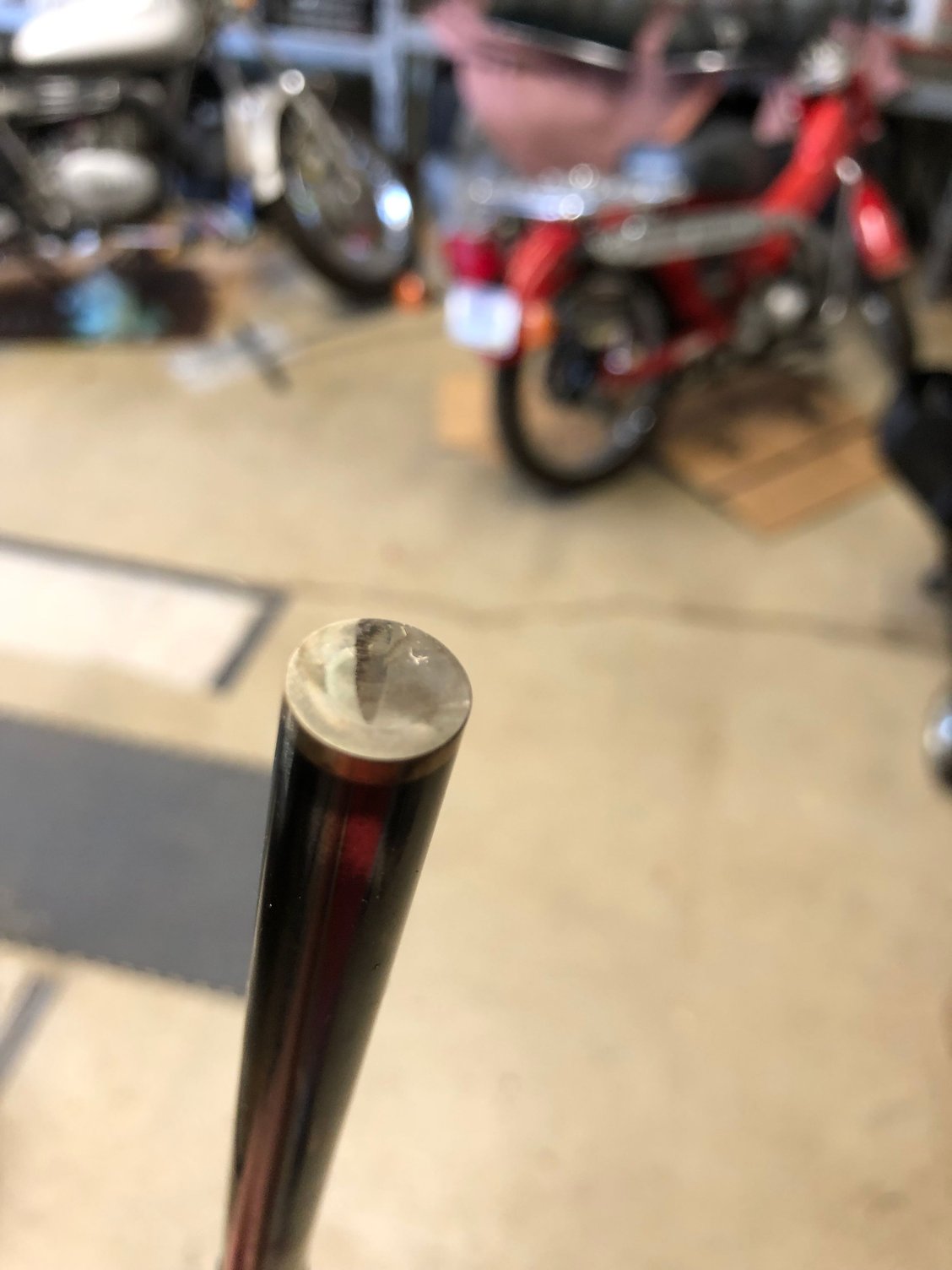

Can you post a pic of the fuel pump rod at the end where it may have been sticking?

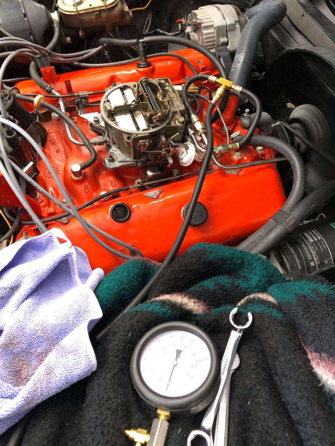

Can you post a picture of your test setup with the fuel pressure gauge?

Here is the requested pictures. I haven’t measured it but the end doesn’t appear to have mushroomed. The engine and pump rod only has a few miles.

You have a couple things to resolve.
  1. Why was the pump rod sticking?
    • Does it roll flat on a piece of glass?
    • That looks like a wear mark on the tip that suggests it was not rotating.
    • Is that a wear mark on one side only 1/2" down from the tip? Better pic?
  2. Why is the fuel psi low?
    • Double check the gauge with another gauge, or on another good running engine. You must know if it is accurate. Do you have an air compressor or hand pump or a Mity-Vac hand pump that you can use to double-check the fuel psi gauge with another gauge?
    • Is that a fuel injection gauge kit? It may not read at 5psi at all if the gauge goes to 100-150psi. You could put another gauge on it. 0-15 psi or 0-30 psi one. for a carb.
    • If 0 psi, it is either pump or cam lobe. The pump could have very low flow and do that.
    • Run the pump outlet into a container to be sure it also has good flow. Around 1 pt @ 30 sec. Fill the carb bowl thru the round vent on top and the engine should start and run fine for ~30 sec. with no fuel line attached. Maybe 1/2lid of a paint can spray lid of gas should do it.
    • Deadheading the pump should give you psi. If the bowl is full, the needle & seat should block flow, and you should get 5-7psi. Fill it with a squirt bottle or your paint can lid. You can even plug the pump hose outlet if necessary. The engine should run for 30 sec on the bowl and that is more than enough time to get a reading.
    • If you still do not have any answers, spin the engine (starter button) no gas or ignition, measure the pump rod lift with your finger or a tool, it should be near .330" Let's hope the cam lobe is not bad.
