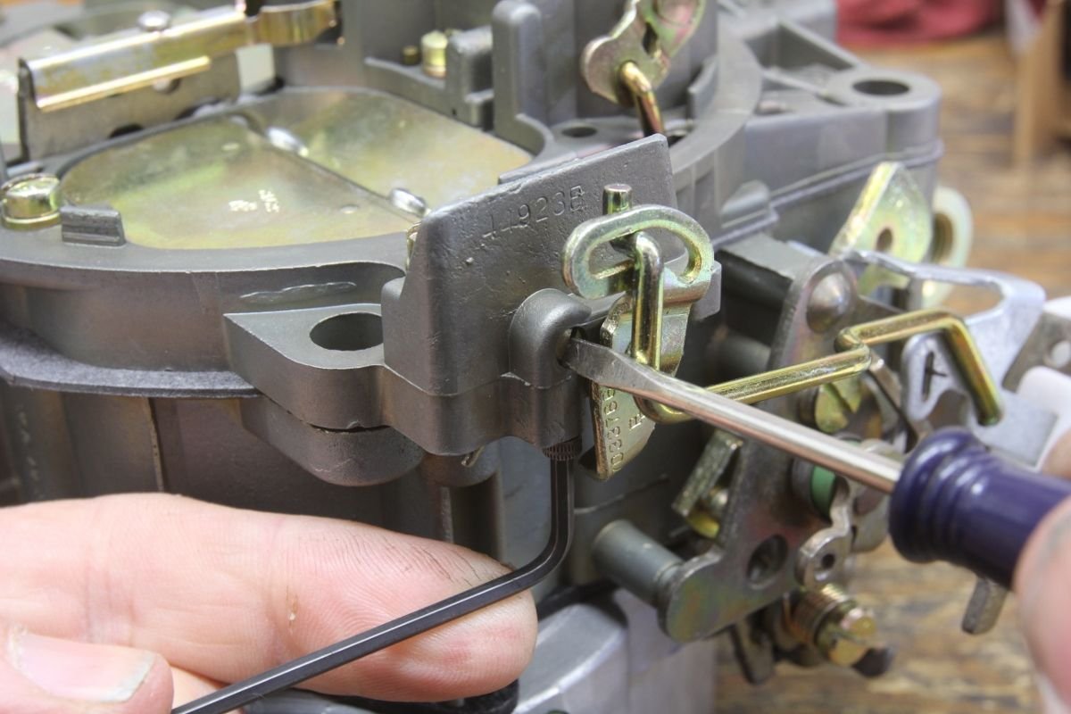

the air flap will only open with the engine under load. if you drive around with the hood off or put a camera in there you can see it open. It has a spring and a set screw that controls how much air flow/ engine vacuum signal it takes to open it which will also control how fast it opens. If you stomp on it and it flips open fast you get the quadra-bog that was coined in the 70's. It was just poor carb tuning. If it doesnt open at all under heavy acceleration then someone may have adjusted it to tight, you have to loosen the set screw which is an allen head then use a flat head screwdriver to adjust the spring....there was n old thread around here on how to do it..

stole the pic from this thread....the first 4 posts explain the choke lock out and the air flap......after that your in the weeds with opinions
https://www.thirdgen.org/forums/carb...djustment.html

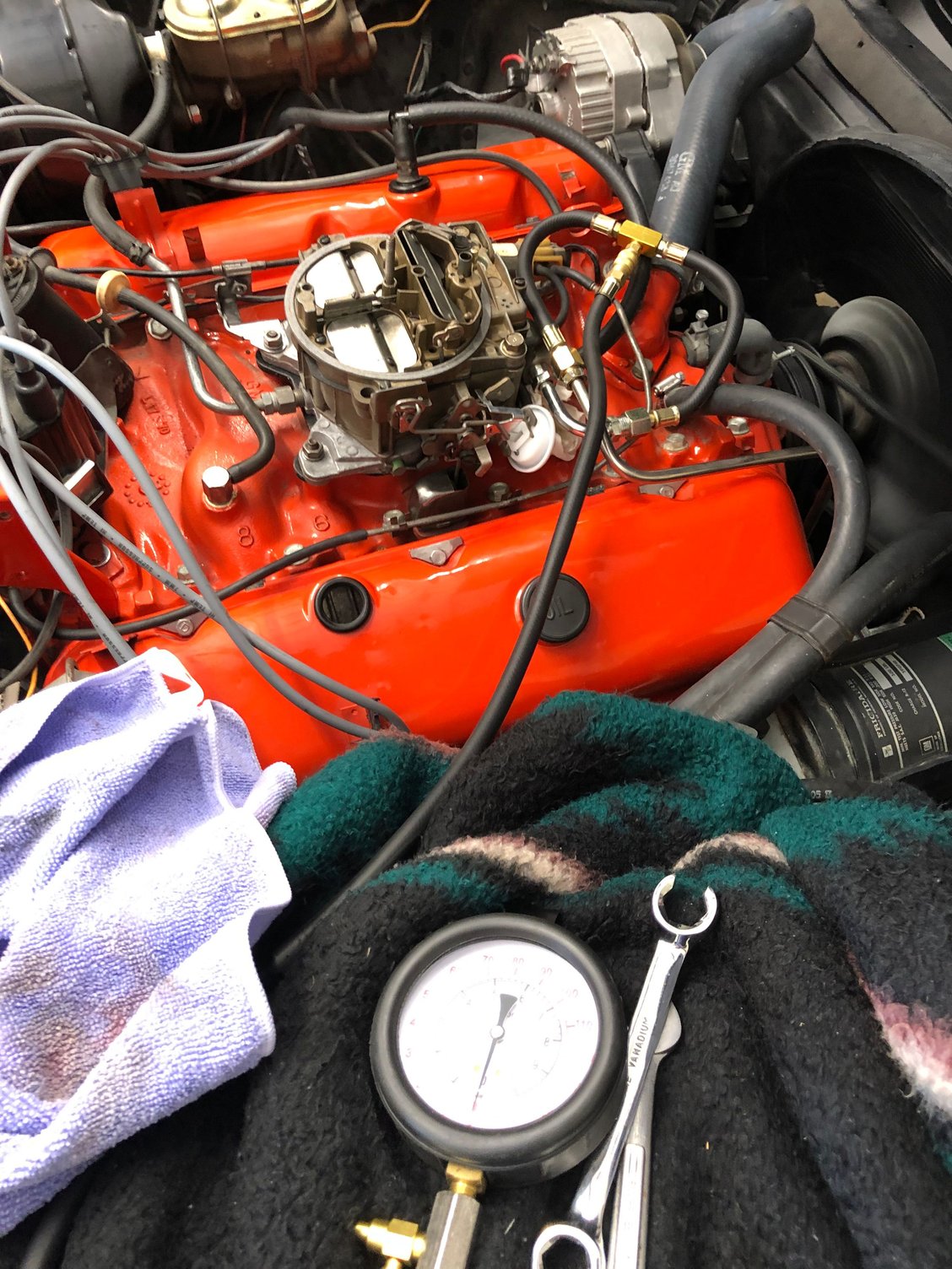

I purchased a fuel pressure testing kit and only getting 1 psi at idle and maybe 1.5 psi at 3000 rpm. Should I do a road test while the equipment is hooked up? I don’t know if much will be learned for the time.
From my research it sounds like I should be at 5 to 6 psi for the quadrajet, do most “stock” or OEM type pumps do this without a regulator?
Any suggestions for a quality OEM type of mechanical pump? I’m pretty excited to get this on the road with the new pump and see how it performs.

Well you certainly found your problem!
While you are in there I would check to see if the fuel pump cam lobe is wiped out, it happens.
The other possible cause is the fuel pump itself.
All the available replacement ones all seem of lesser quality than they were back in the day.
Either the diaphragms fail, they do not like ethanol type gas, or the pivot pins come loose.
If you need correct get what is hopefully a quality replacement.
If you need a really correct one, hopefully yours is an original AC. I would not throw that away, in fact they can be rebuilt, but not easily.
A more reliable choice would be an aftermarket Holley or Edelbrock mechanical pump, but they do not look very original.
But they are better built and the diaphragms can be replaced.
