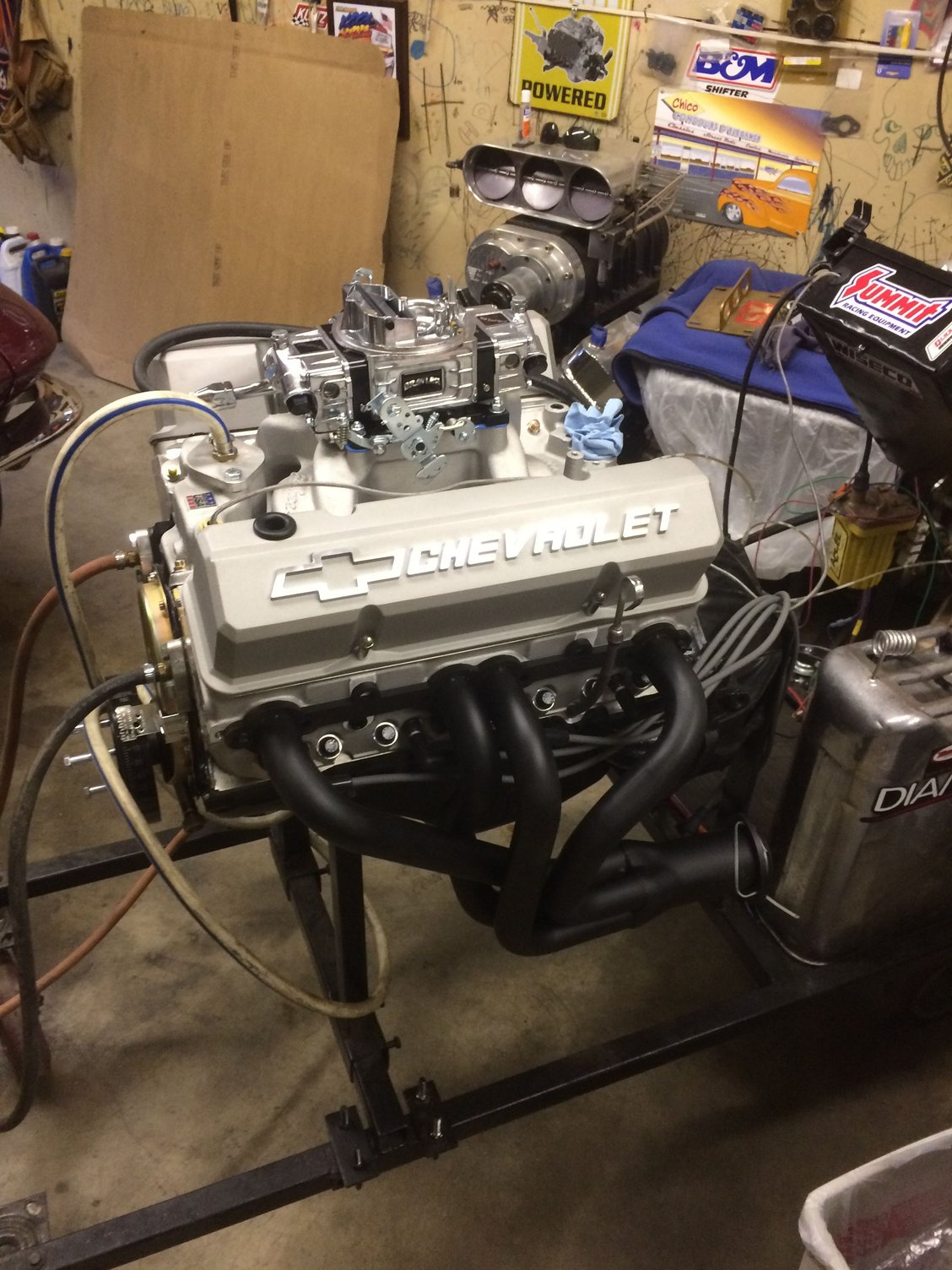

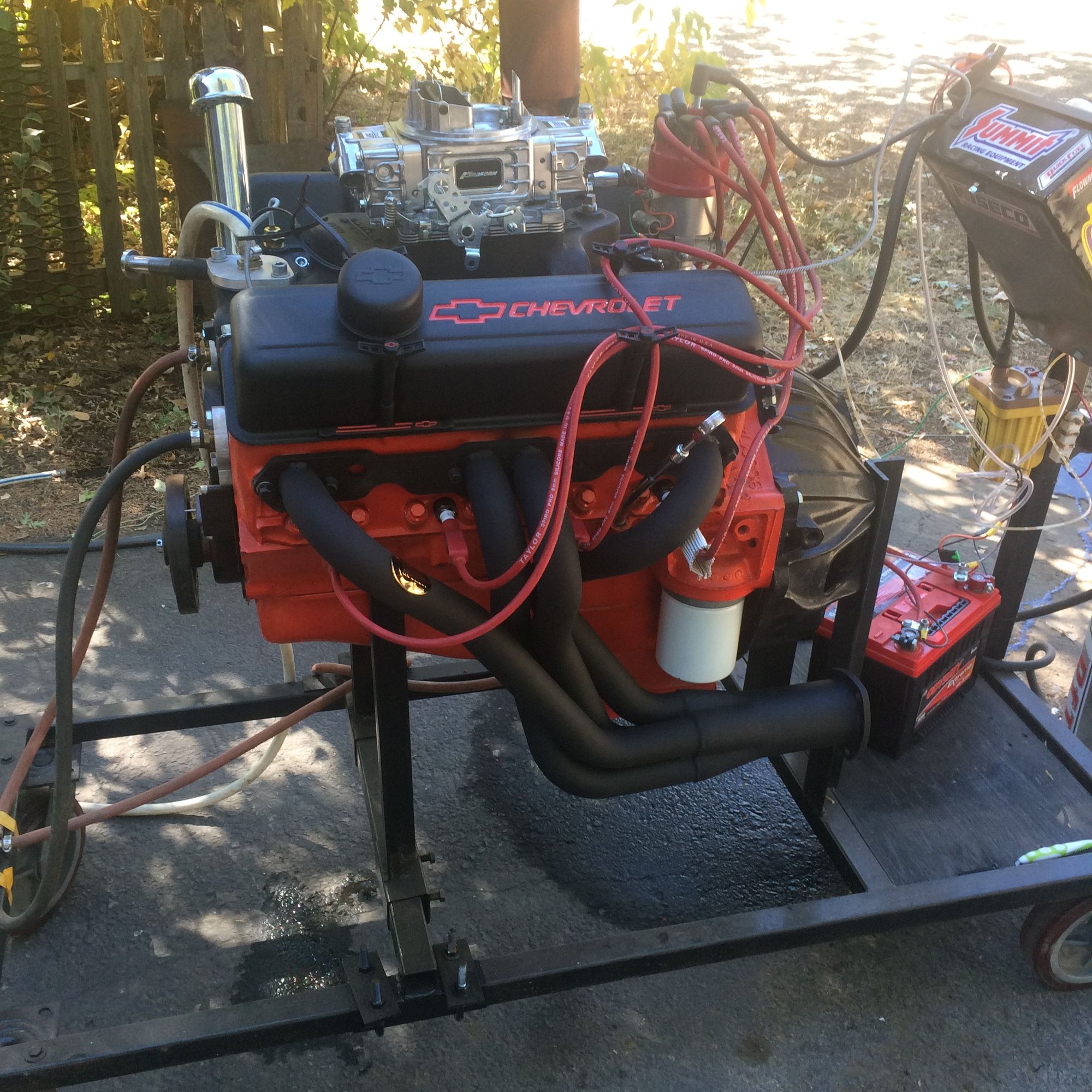

Summit brand are the best for the money and have zero issues. Good ground clearance starter clearance nice flange. Hookers aren't that bad either but summit are better
These are hookers.
Summit

Nice!
