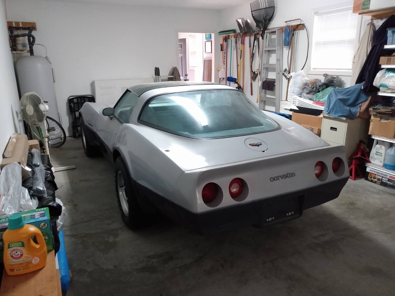

The purchase im working on...very dry storage, just stored away incorrectly. Very original, 35K miles.

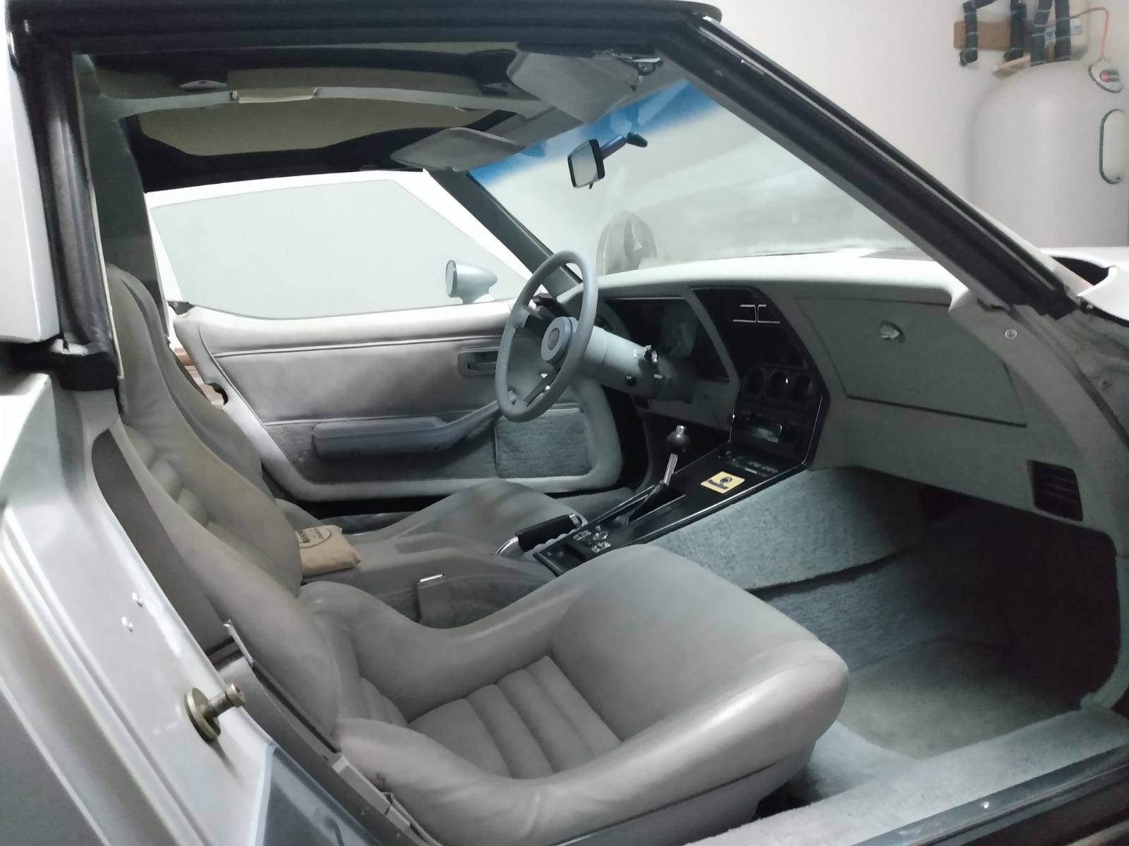

I’m going though one of those same color outside but your color interior is mint. Take your time and get it running. I still have to paint. Yours is mint. You look like your weatherstripping is in great shape to so no work there unless I’m wrong and you spring a leak.Your car was definitely not left outside. No sun fade. She’ll polish up nice.

Car looks very clean which is a good thing. All the rest can be sorted out in time. Hopefully we can get together this weekend and discuss this.
