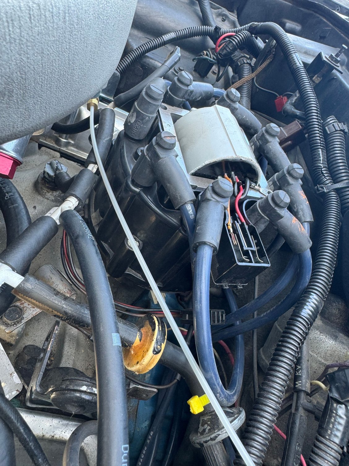

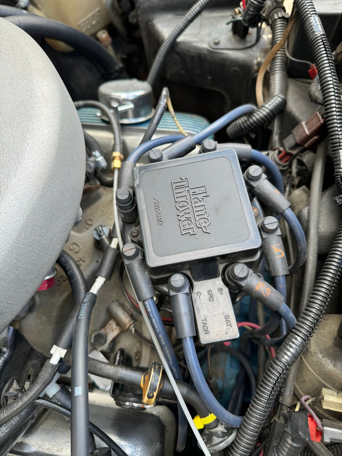

Is this the factory distributor for a 78?
Old Mar 17, 2024 | 04:45 PM
HeadsU.P.'s Avatar
HeadsU.P.
Joined: Aug 2017
Posts: 8,336
Likes: 2,810
From: Cool Northern Michigan
Ah, no. Aftermarket. Flamethrower.
But same concept, same innards.
On the top of that unit is a dust cover for the coil. Three little screws and the cover is off.
Now note one corner of the coil, which looks like a big magnet will have a black GRD wire going under one of the four coil mounting screws.
Make sure the coil, screw, wire, washer are all shiny. No paint or corrosion.
You will also be able inspect all the wire connections leading into the cap now, with the dust cover off. Are they tight?
Also note that your cyl #5 and #7 wires are crossed. Always keep those two plug wires well separated, from the dizzy cap ALL the way to the plugs.
Due to the firing order of Chevy V8s those two interfere with each other known as "Inductive Crossfire". Use your wire looms to separate those two.
Remove the four coil screws. Coil lifts right out. There you will see the bushing (spring) I spoke of in post 5.
All this is simple maintenance. You don't need a repair shop.
But you do need to separate plug wires #5 & #7.

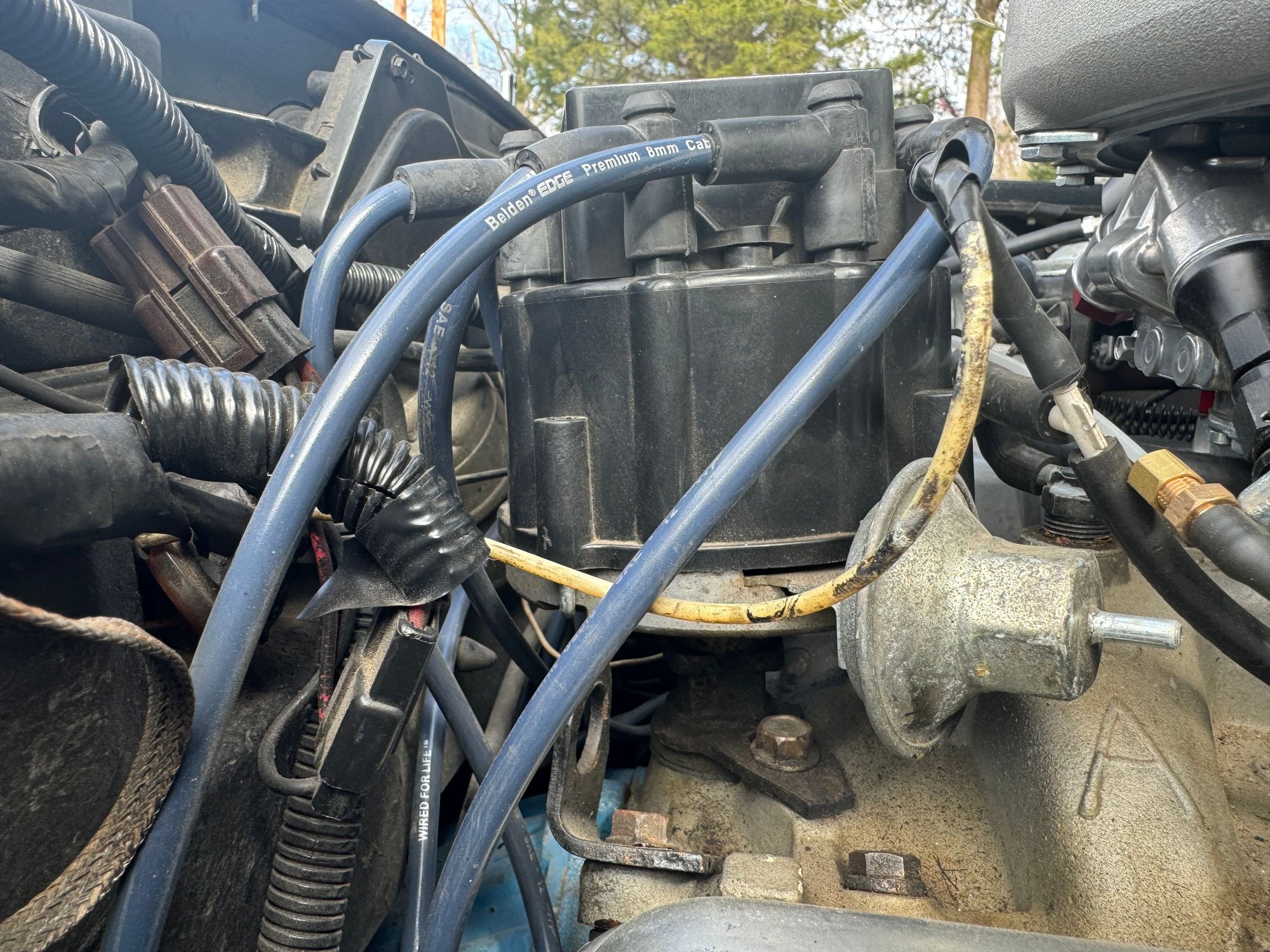

Actually, in that photo you put up about all we can see is the coil cover and a bit of the distributor cap. The distributor is under all that. And we really can't see it.
You could very well have a factory distributor under that cap and coil cover!
Or Not! Try to get a photo, standing on the passengers side of the car. Get down low and show us the side of this distributor from the clamp on the intake up.
Then maybe we can give you an honest answer as to whether or not you have a original distributor.

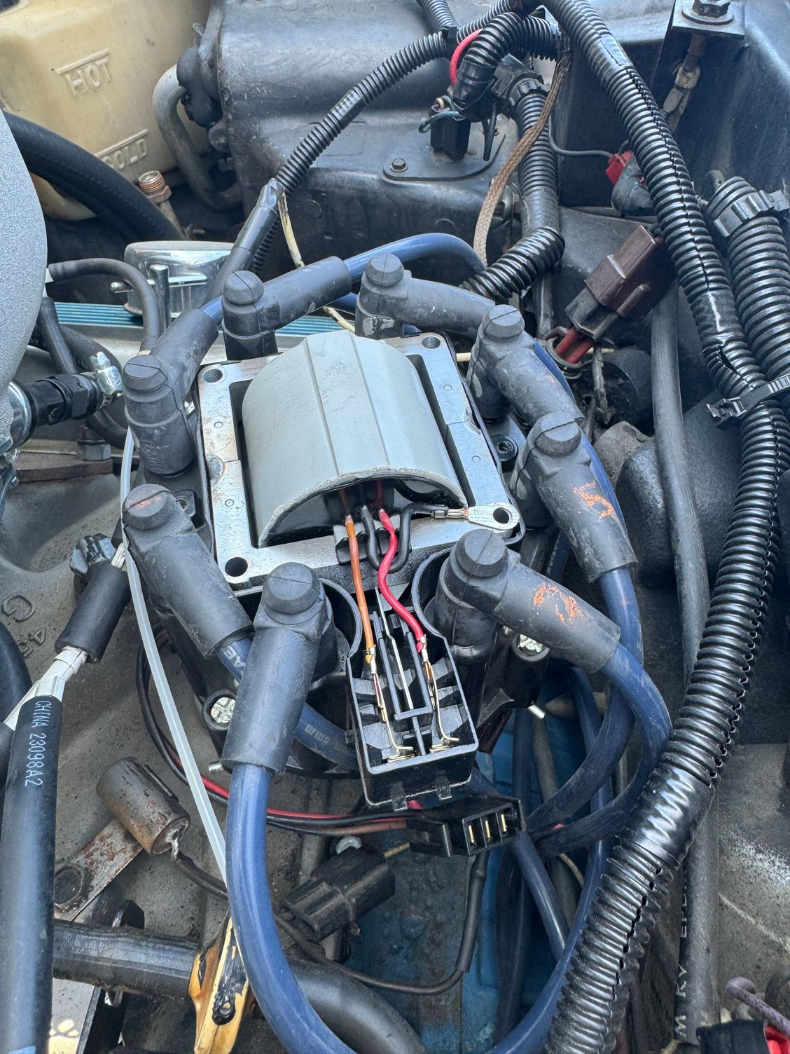

This is what I’ve got. Going to replace the coil and module while I’ve got it apart.

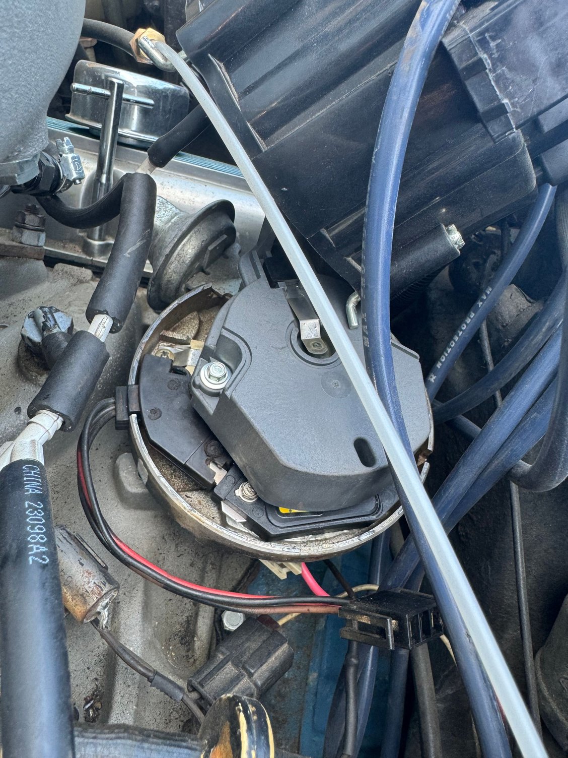

The coil is usually sold with the cap. Do you have a "before" picture?
Do you know what your timing is set to? It looks like your (adjustable) vacuum advance is not connected. Perhaps you don't have enough advance. Noticed any overheating, or run-on/dieseling at shutdown?

Well, some bubba sure likes to play with vacuum hoses. Good grief. More splices and poor connectors than needed.
And the second most important vacuum port, Intake manifold port, is capped off. ???????
And like Bikespace said, your distributor Vac canister appears nonfunctioning.
As I stated earlier, the black GRD wire under the coil cover: Wire brush that coil frame connection. Its an important GRD.
If your new module does not come with a tube of Heat Sink Compound, do not install until you find some.
Separate plug wires #5 & #7. Do not let them touch each other.

Let me pan out. This might explain the funky vacuum lines. All vacuum has to come from the manifold.
To 78 cutting out when warm
You really should have started with this picture, in your first post.

Now I see a vac line off the Intake from that angle.
Bad-*** charger.
Took some creative ingenuity on the upper rad hose too.
