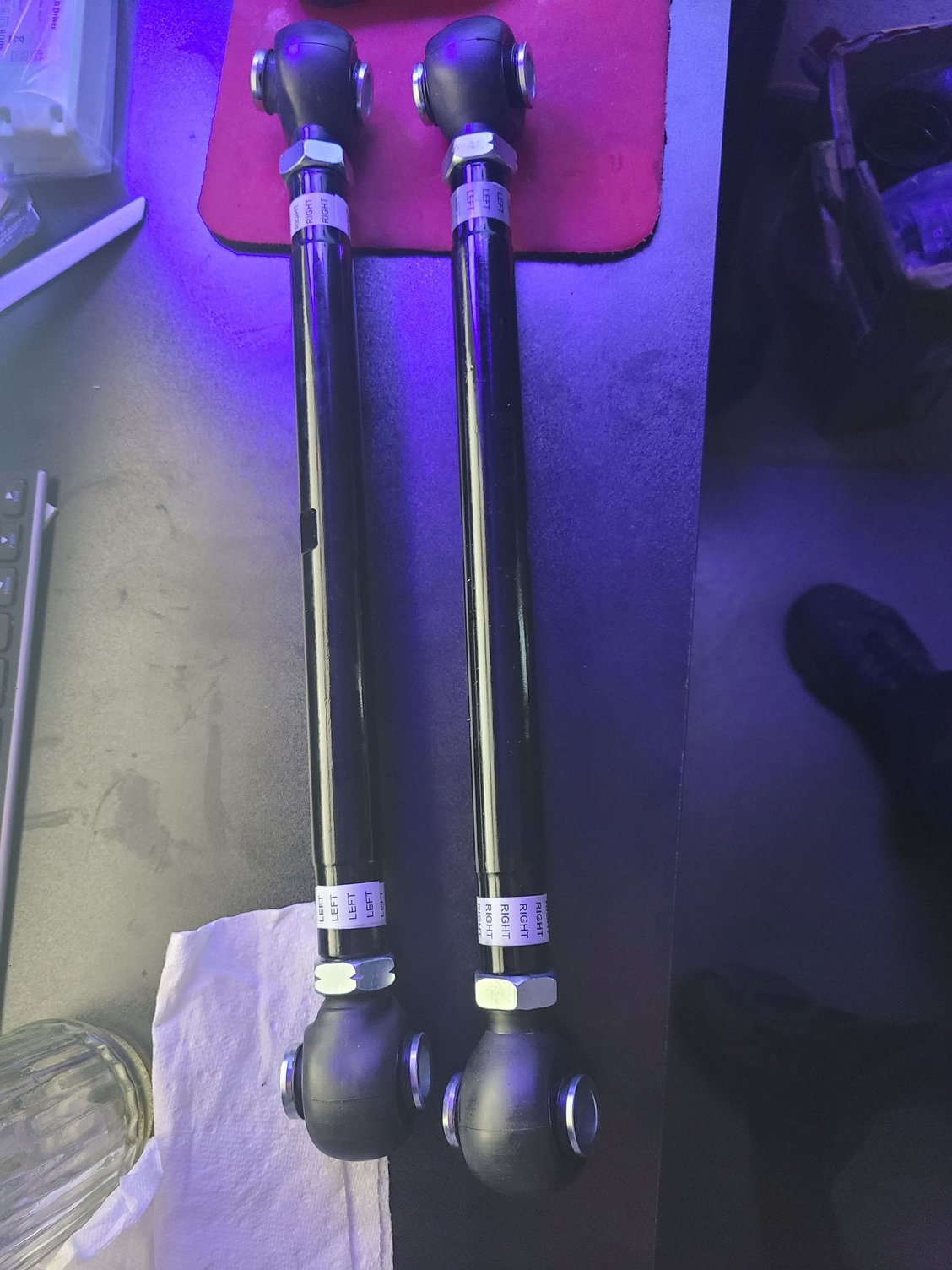

Thanks, I picked these up yesterday as well...

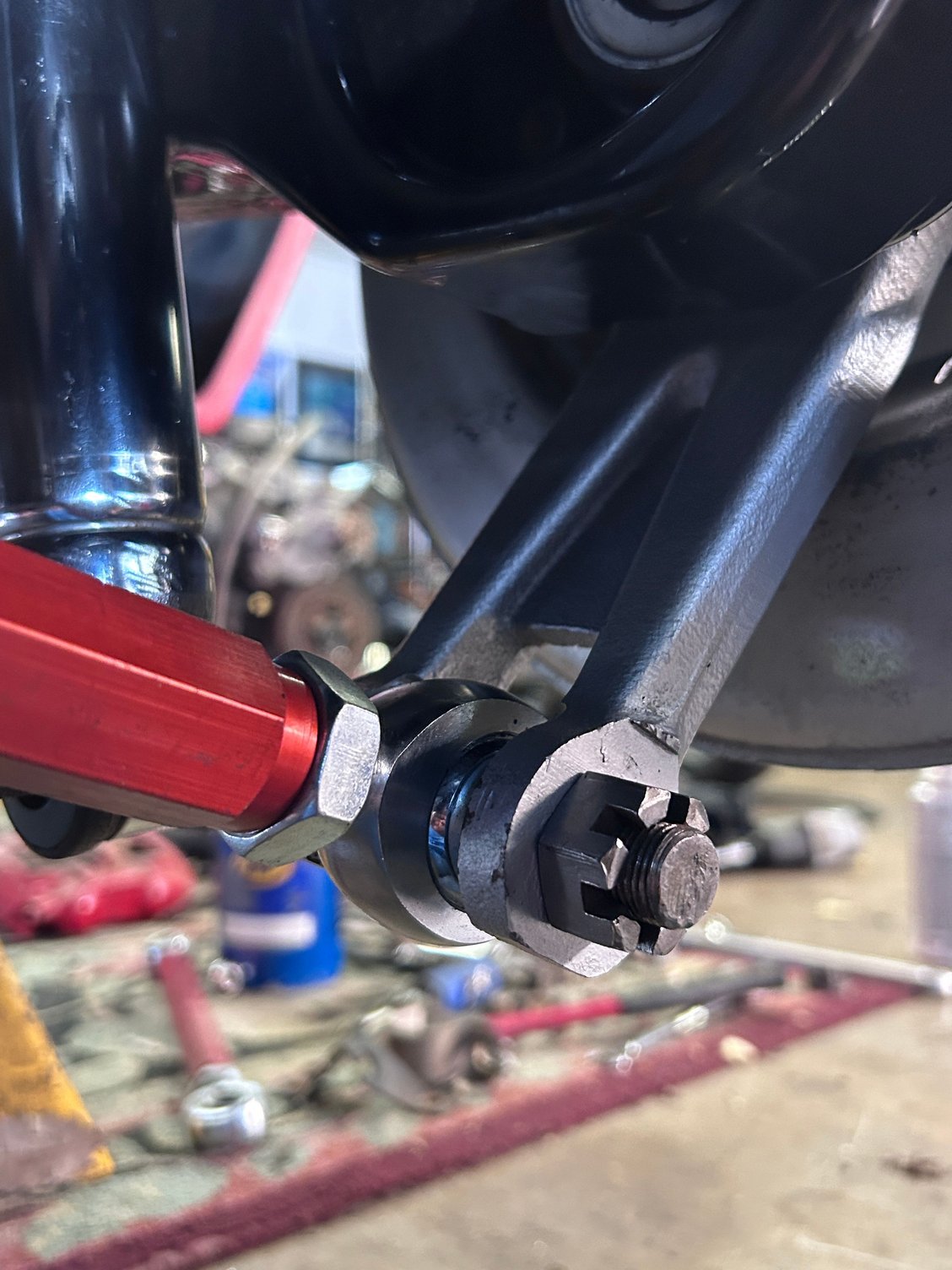

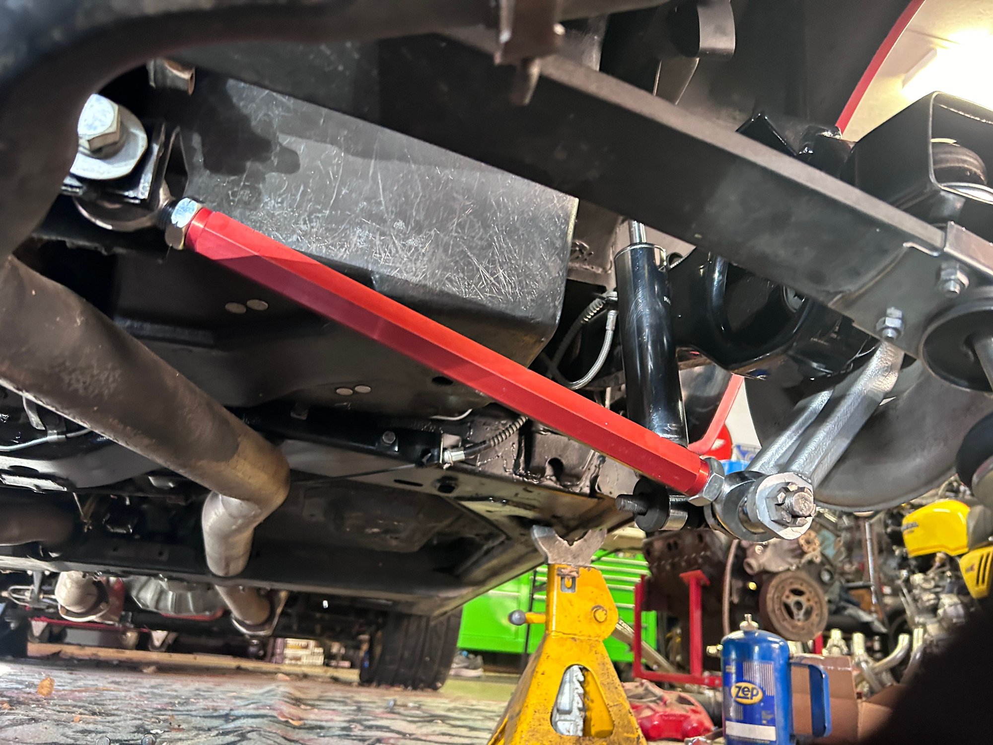

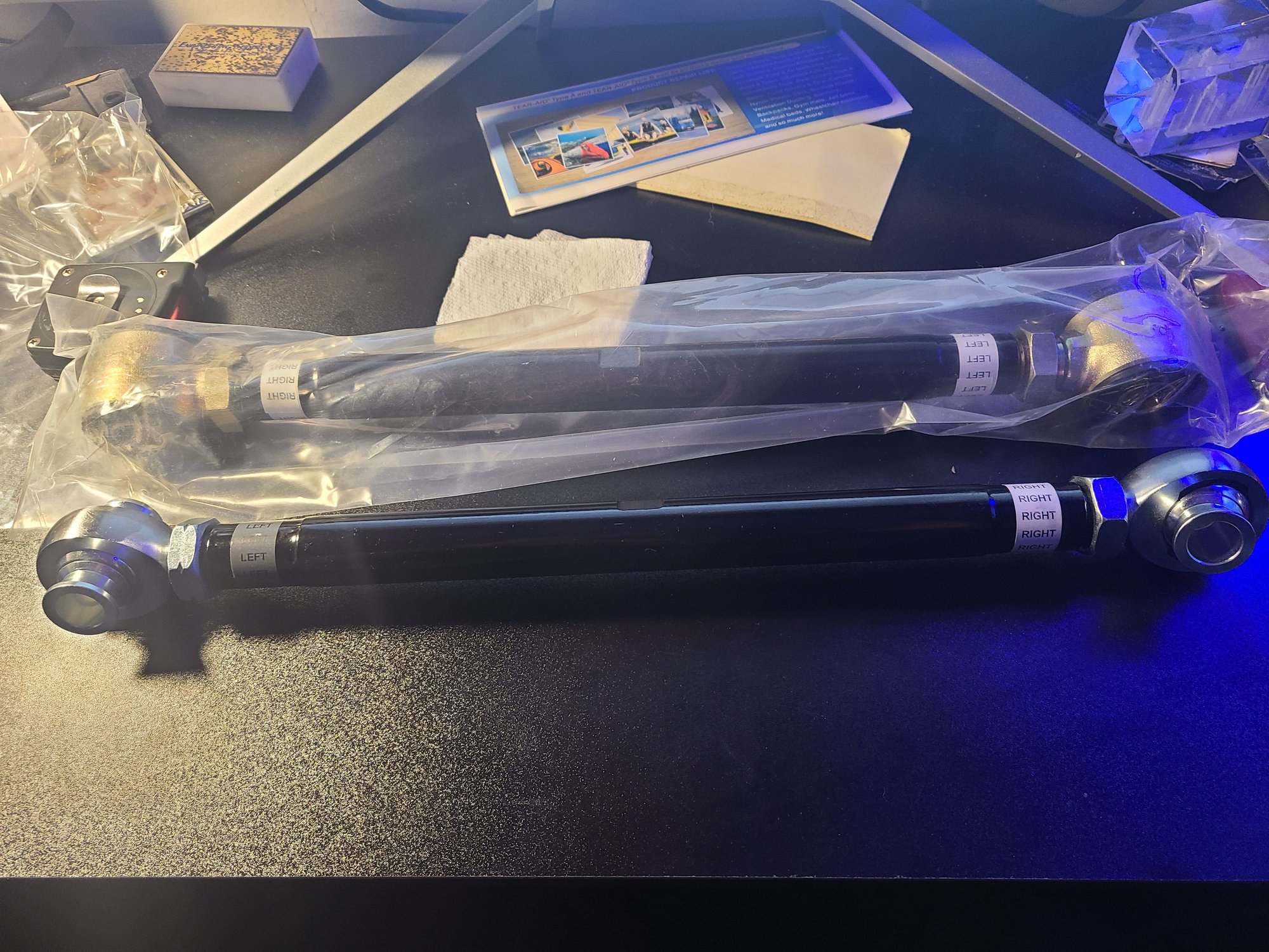

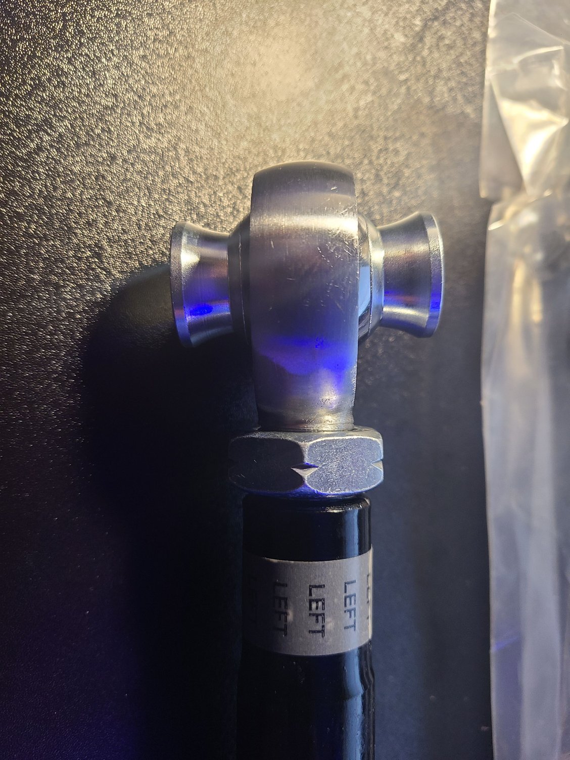

Got my heim joints today and everything went together well. I may have to grind a bit off the inserts, I'm not sure yet honestly.the with from eye to eye is 1 7/8" and my car is kinda buried in the garage right now for winter storage so I cant measure the wide of the openings.

3/4” Heim Joint Rod End Kit, Right and Left Hand Thread Heim Joint,2 Link 750” Chromoly Joints Panhard Rod End Kit

Got the boots in today... not bad for a $180 total
