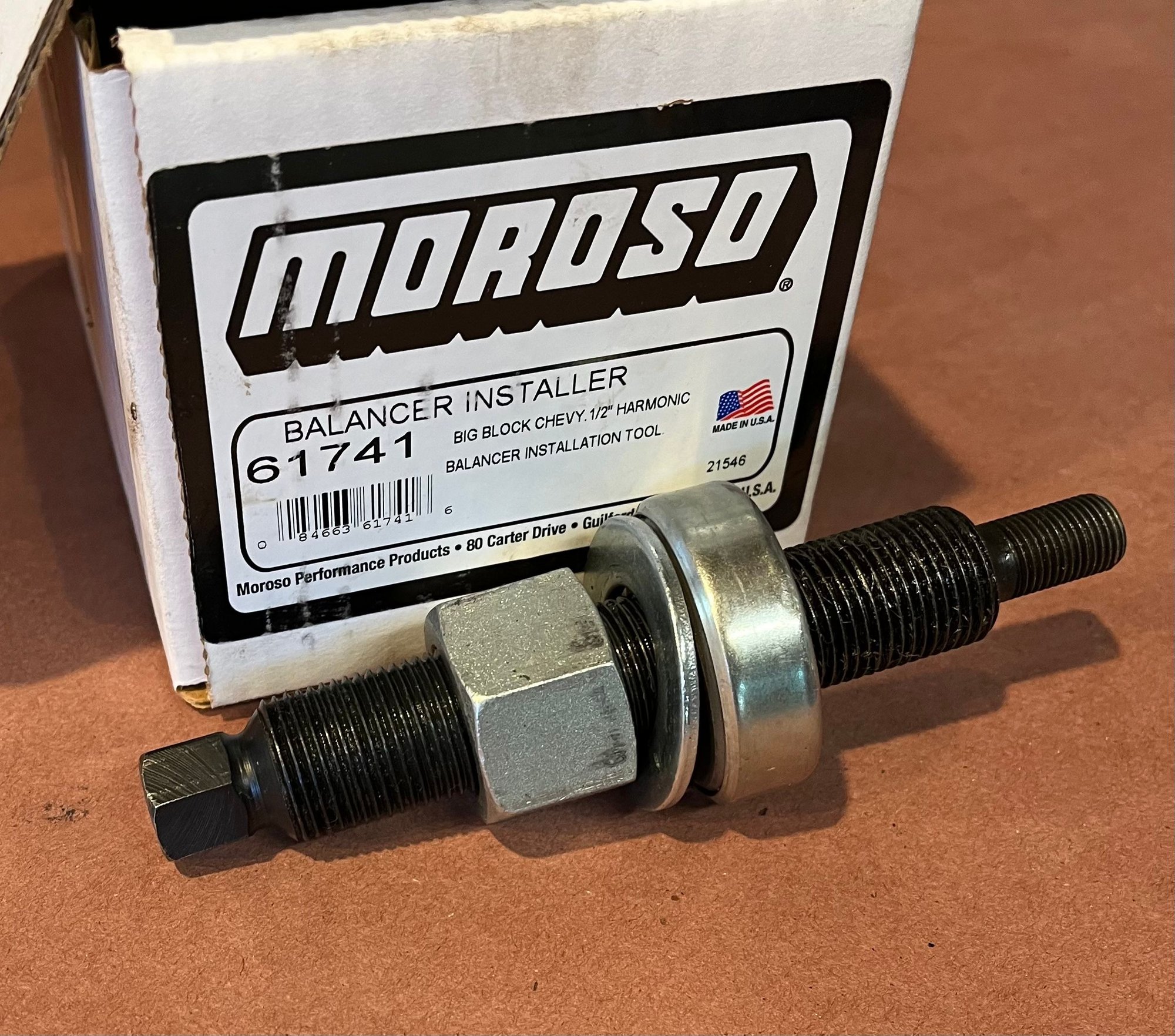

What I used on my 427. Moroso (USA) makes nice stuff.
