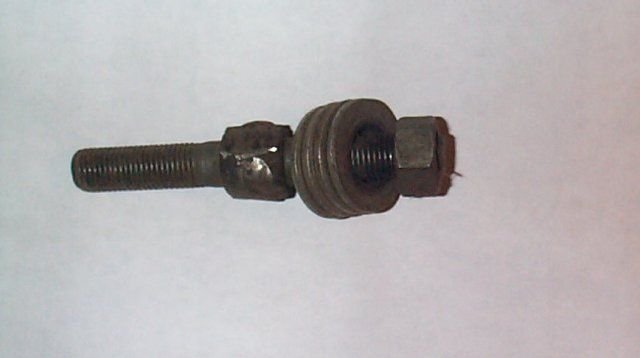

This is my very uncomplicated balancer install tool, two bolts welded together. Made it many years ago.

I already ordered the right tool but I’m interested how this works exactly? Bolt heads fit through balancer hole?

One end screws into the crank shaft. Place the balancer over the install bolt and start the balancer on the end of the crank. Bolt/installer protrudes thru balancer. Place washer(s) over bolt, spin on nut and tighten nut which will press on the balancer.
Depending on the length of the bolt you use, you might have to back off the install nut and add a few more washers during the process.

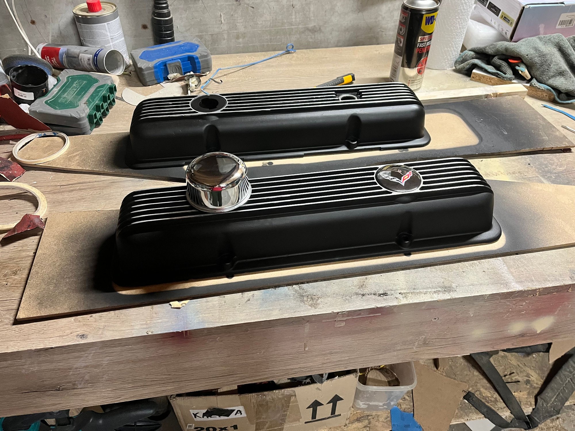

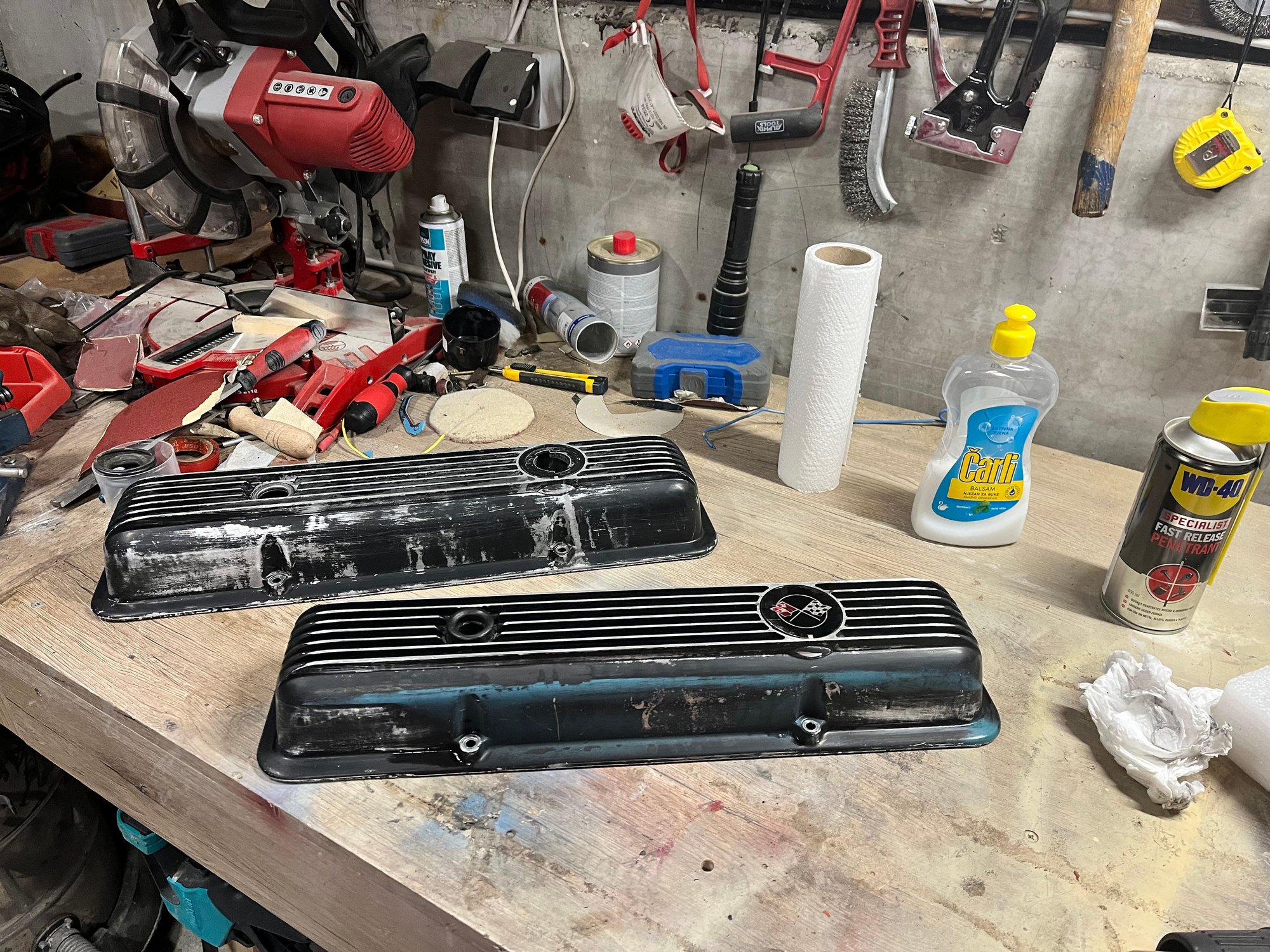

Here are mine, also baked in family oven, before and after the baking

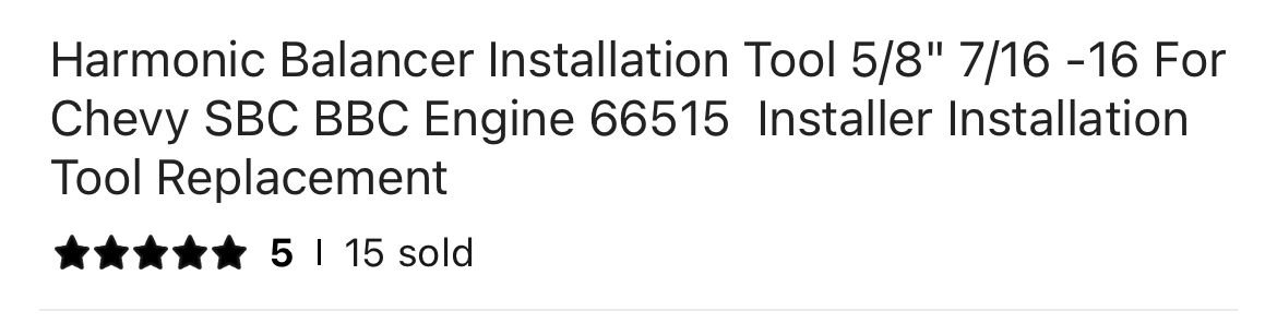

That’s weird cause this is th one I could rent and it says here:
And in my case this is the wrong one or there are two types of 66515, one with 7/16-16 thread and one with 7/16-20.
In any case I found that the one with correct thread is part number 6291-1.
