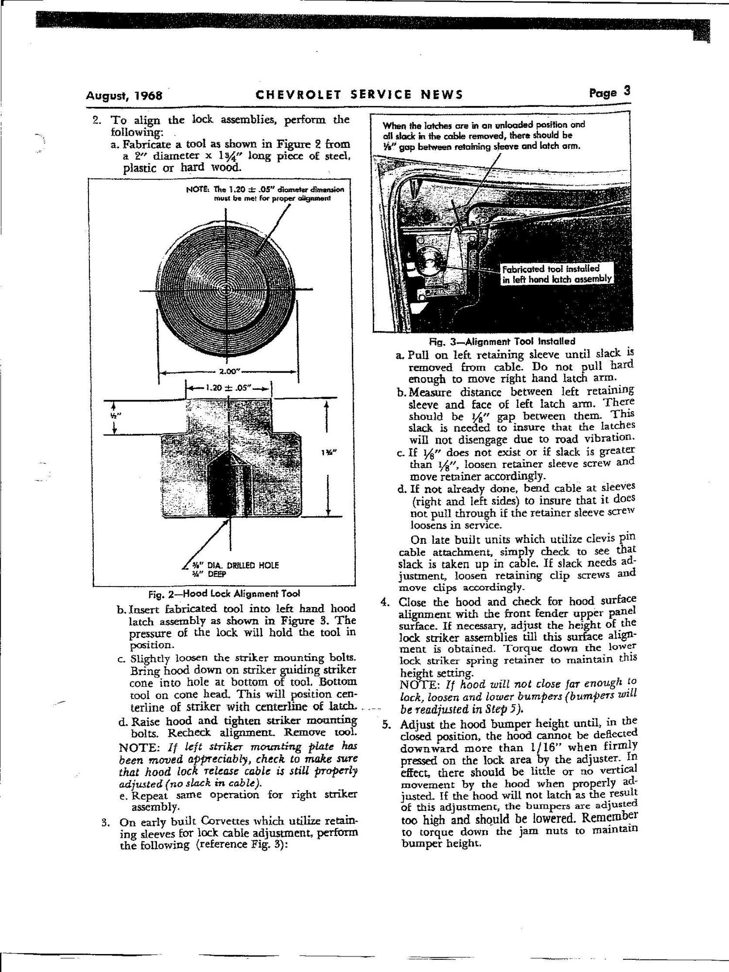

The pin and the hole they fit into must be adjusted first.
Then adjust the cables.
Build or build this tool.

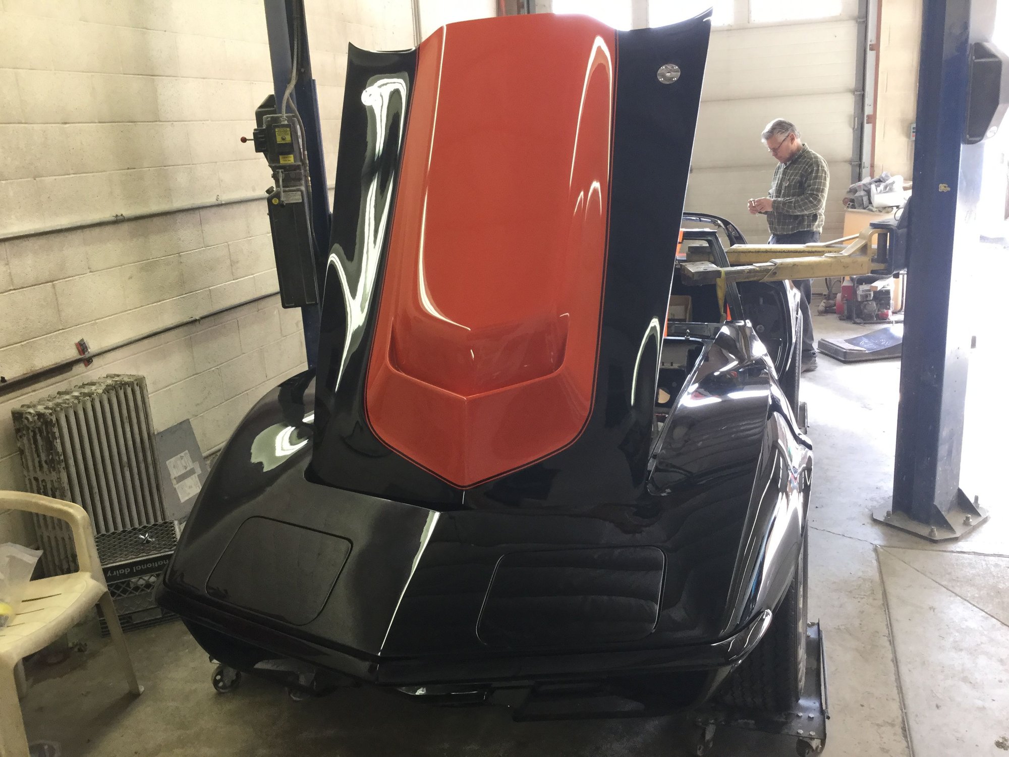

I love my tacky hood pins! Couldn't find a better picture. I did my pins so they were symmetrical and not in the factory passenger side location. Very easy to do.
