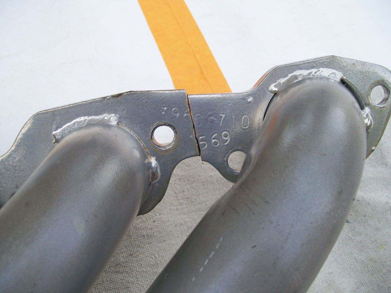

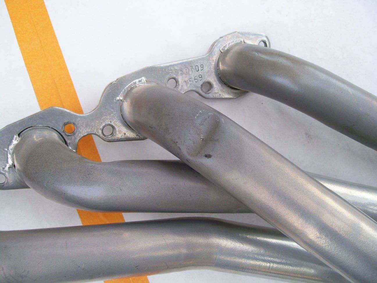

These- GM Part #s 3960710. and # 3960709
Thanks @Richard454! I'm curious to see how the OP will get those to fit on an LT-1 SBC. Those are for an L88 BBC.
Oops- the small block are 3977971 - LH SB Header 3977972 - RH SB Header
They both use the same side tube-3960713 - Side Tube
