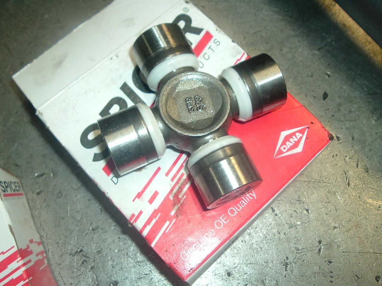

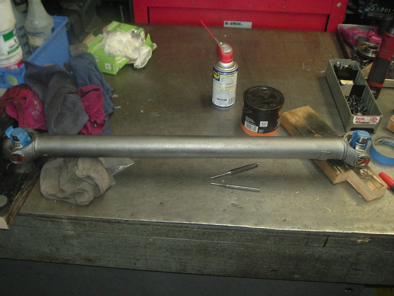

I'm installing new U joints in my drive shaft and having some....issues. I'm able to get the U joint in but i can only get 1 retainer clip installed. I'm using the bronze/copper clips, which is supposedly the thinnest, but i can't get both installed. I don't have a press so i'm using the hammer and socket method. I can't seem to get the cap far enough down to get the 2nd clip on. I'm whacking it pretty darn hard but i doesn't seem to be moving much. It also seems to cause the joint to bind a bit and become harder to move around the more i whack it. Any tips or tricks besides just using a BFH and waling away?
Also, i have the 1330 Spicers which from everything i can tell are the correct joints for a 1970 auto.

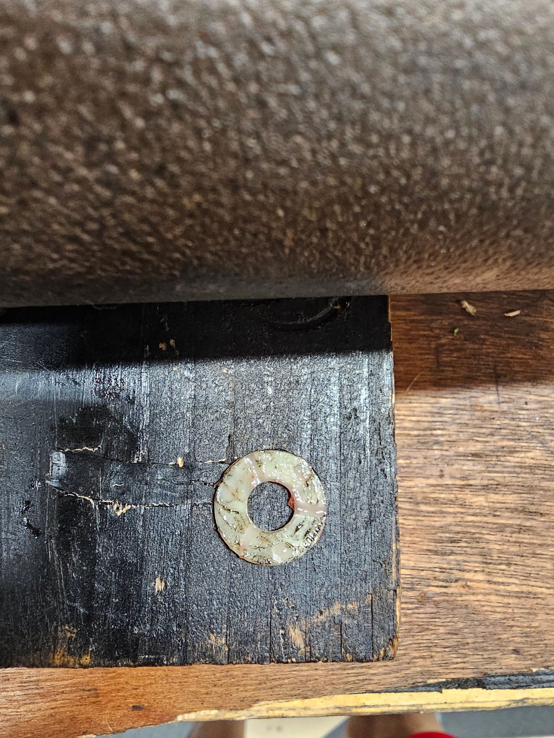

Here's the little plastic ring...thing.

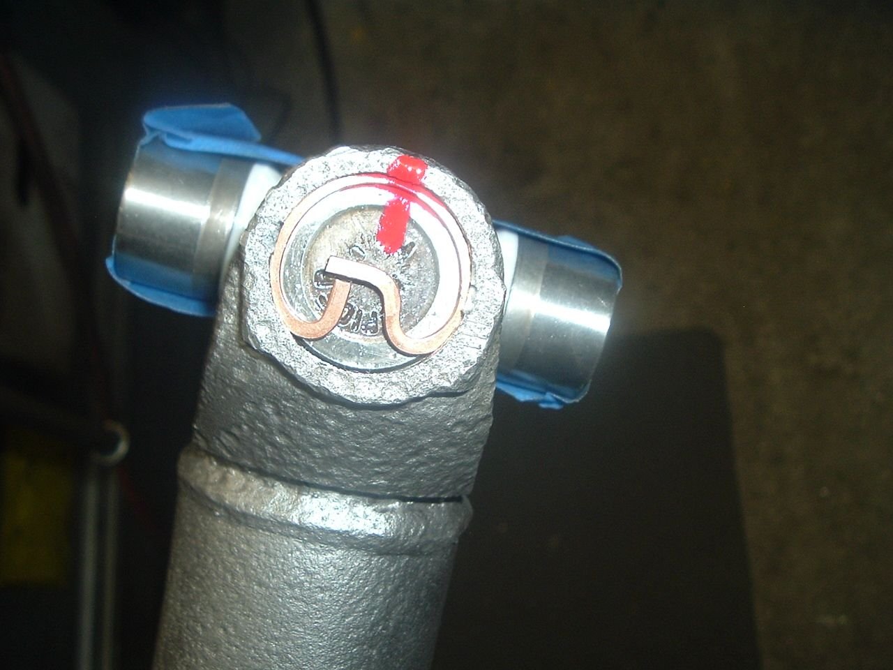

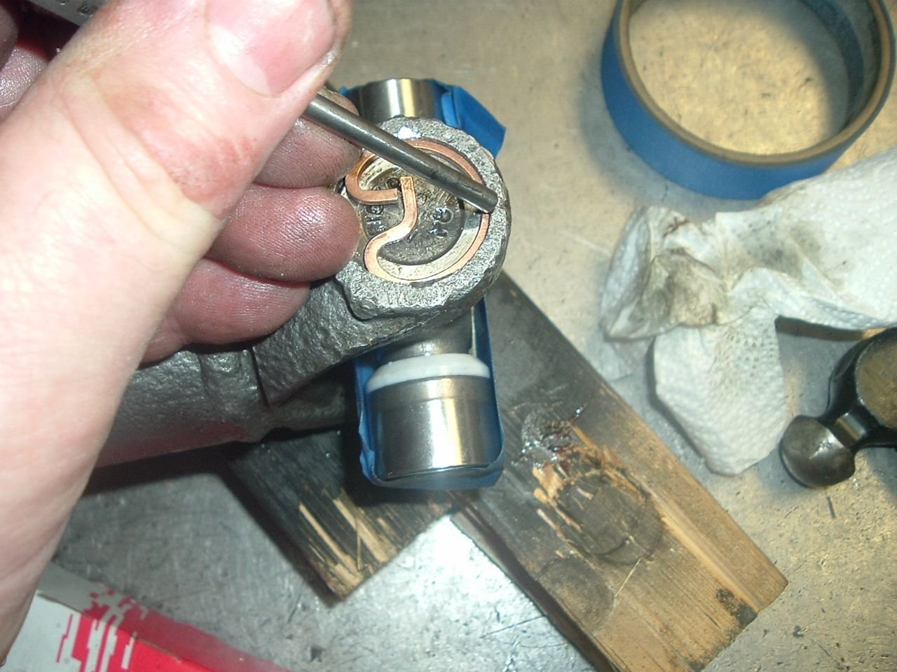

oh sorry, here you go. This is the inside of the u joint cap. You can see it on the very bottom here.

The plastic "washer" goes in the cap as you see. Very common for them to stick to the cross end when removing the cap. They can fall off. As long as it's in the cap, and only one, I run a little grease over the rollers to hold them in place-not a lot since the joints are pregreased.

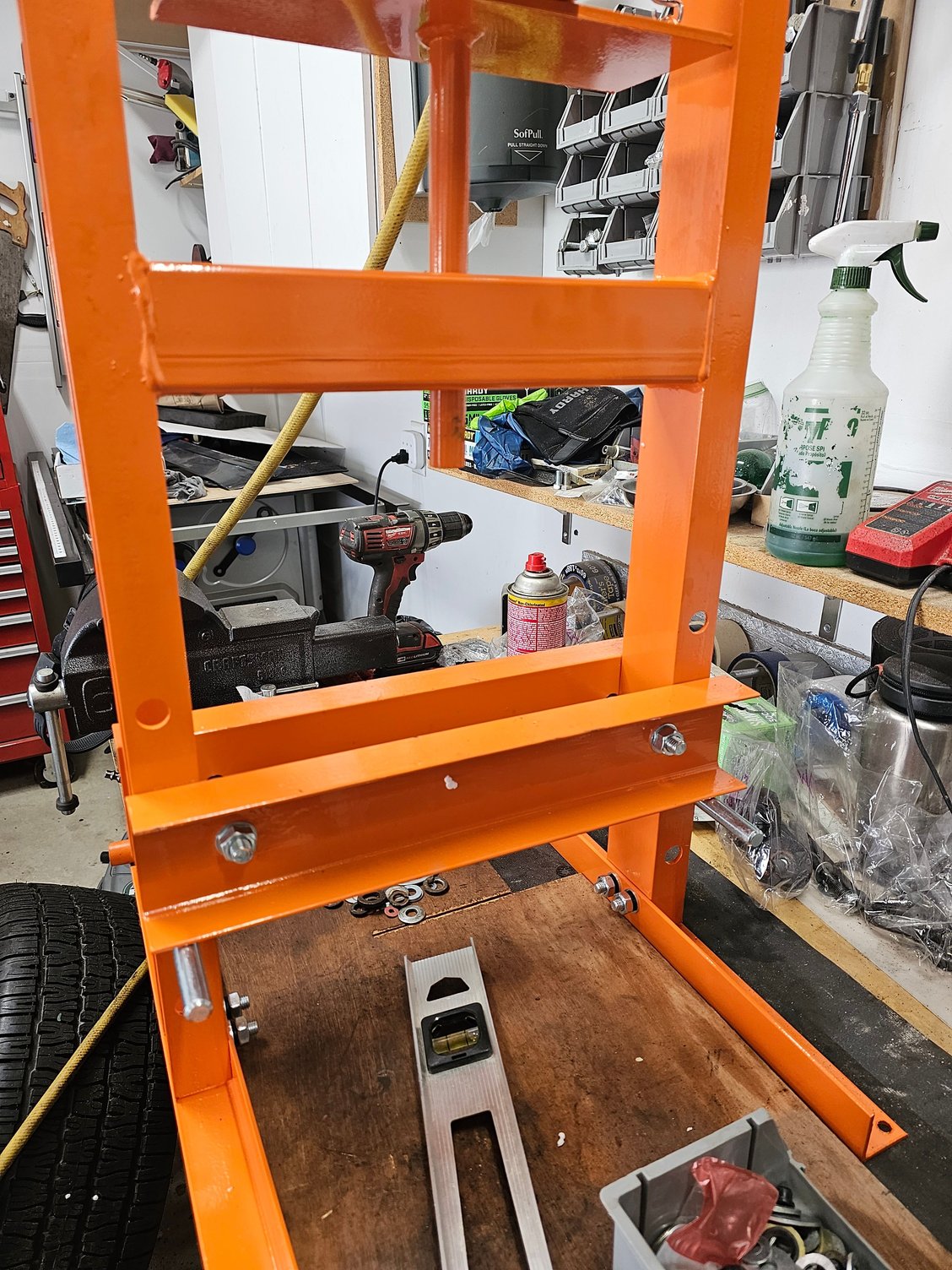

So i bit the bullet, kind of. I sprung for this guy here.
Its a small 6 ton press from Vevor, $105 and free shipping. If i'm going to get charged $150 for pressing U joints i may as well spend $100 and not have to worry about it ever again. I also needed it for installing the Delrin bushings in the rear crossmember.
U joints are all in and the Delrin bushings are in too, no issues.
