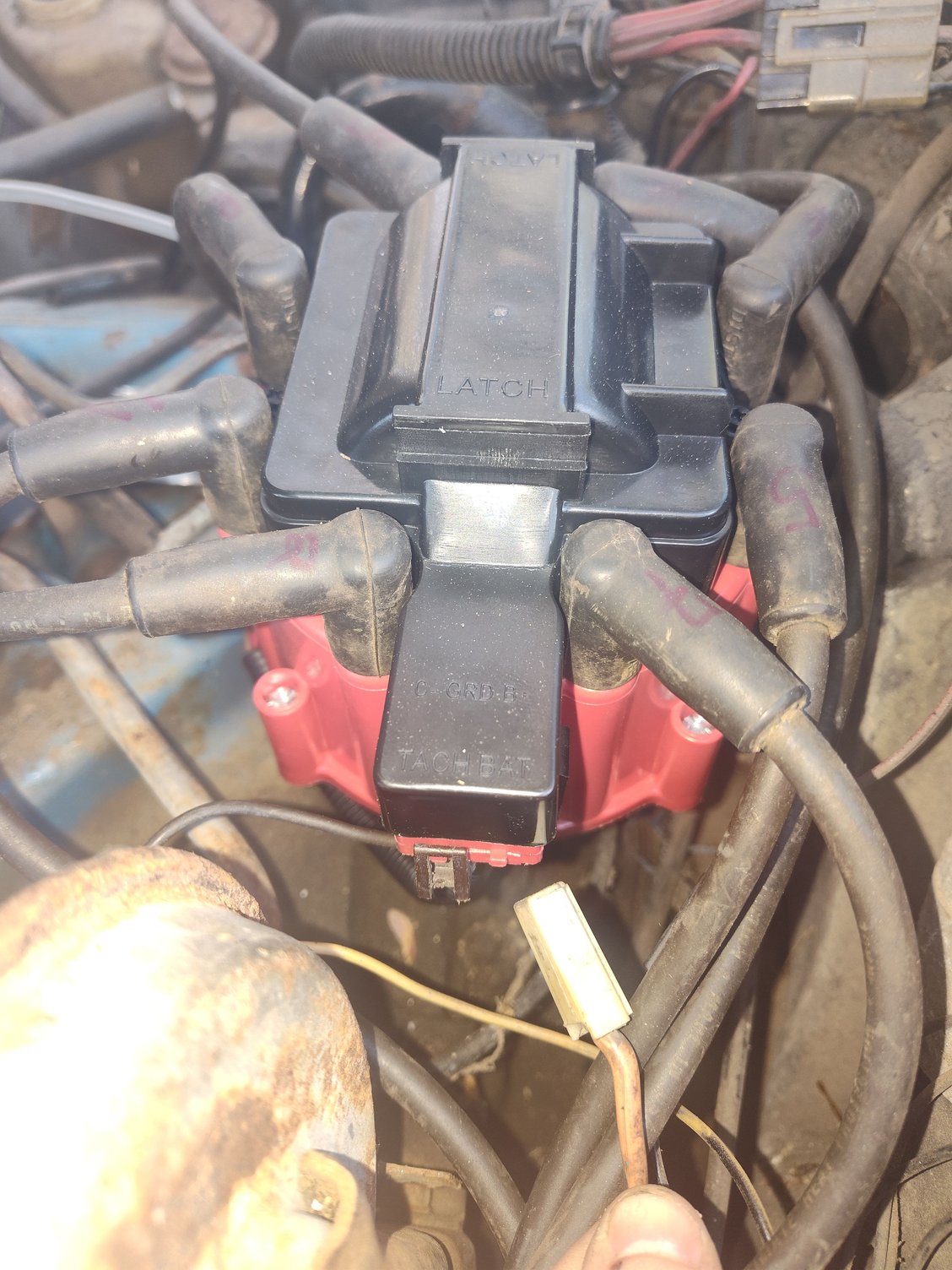

In the very first photo, the wire your holding should be plugged into the distributor, that will help immensely!
Does that wire get power with key on?

Did you just cross a river with that car?
Never seen so much condensation residue under the coil dust cover, in the cap and on the coil itself.
Also, swap out the little spring / bushing under the coil.
It does.

In the third picture you are holding a wire that plugs into the distributor. It appears that the wire has had it's insulation worn through and possibly exposing the wires. You cannot have anything shorting to the frame or there will be problems.
Before going to far be sure to remove the battery and charge the battery until it starts gassing which happens at around 2.5 (volts per cell) on most flooded lead acid batteries. If accessible remove the vent covers to allow access to the electrolyte level. If the electrolyte is low be sure to top it off with DISTILLED WATER only and then charge it until it gasses.
Clean the battery posts and the battery wires connectors with a wire brush. Measure and record the Battery voltage at the battery and then measure it again but this time using the engine. Use the bat positive on the starter for the 12 volts (+) and the engine for the ground (-). The numbers should be very close to each other. If not check the battery negative wire to ground and then the positive wire.
That distributor sure looks like it was used on a submarine.... I would imagine that the module is fried inside that distributor. I would find another DEI distributor for testing purposes. You will need a lot of new parts on that old distributor to make it work. On my C4 I have an HEI distributor and it uses a 5 pin module I think). This module is attached inside the distributor body and uses a thermal transfer medium to keep it from getting too hot. When they fail, so does your ignition system. I am betting the Ignition Module is toast in the original distributor.
The two fusible links referred to above are found down by the starter motor and it's wiring harness. These are the LAST RESORT protection GM installed. They do blow if something gets badly shorted. If you have no voltage at the fuse block this is frequently the cause.
