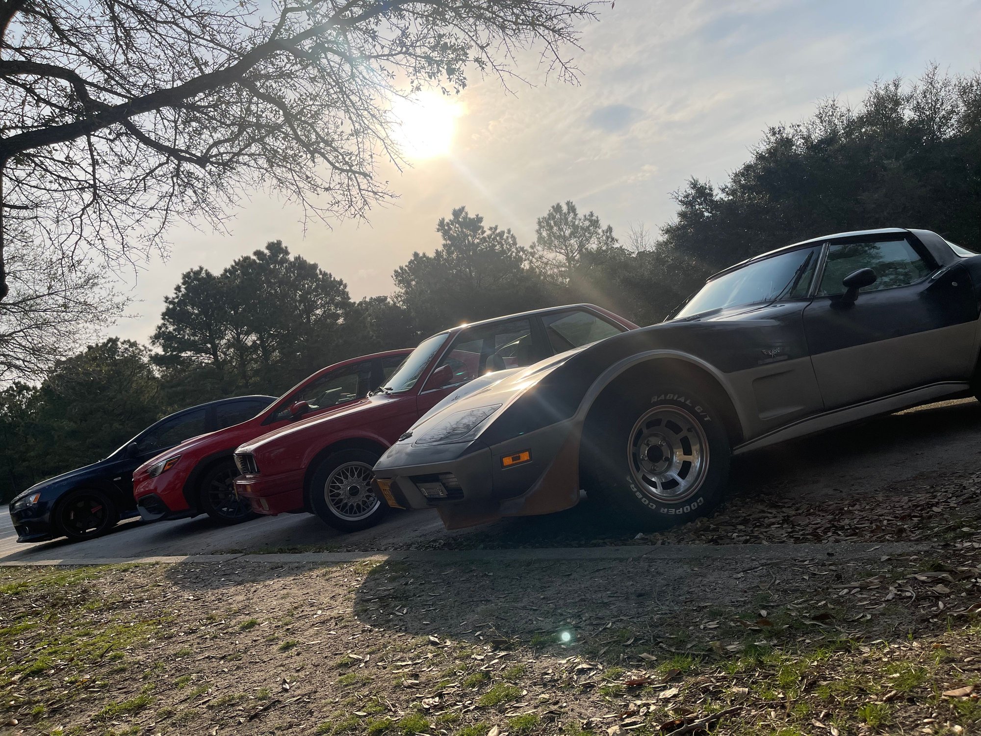

This was during the eclipse. Had to give the baby a photo shoot, because of course, right?
