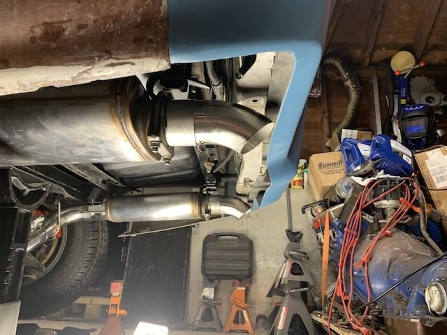

Last thing

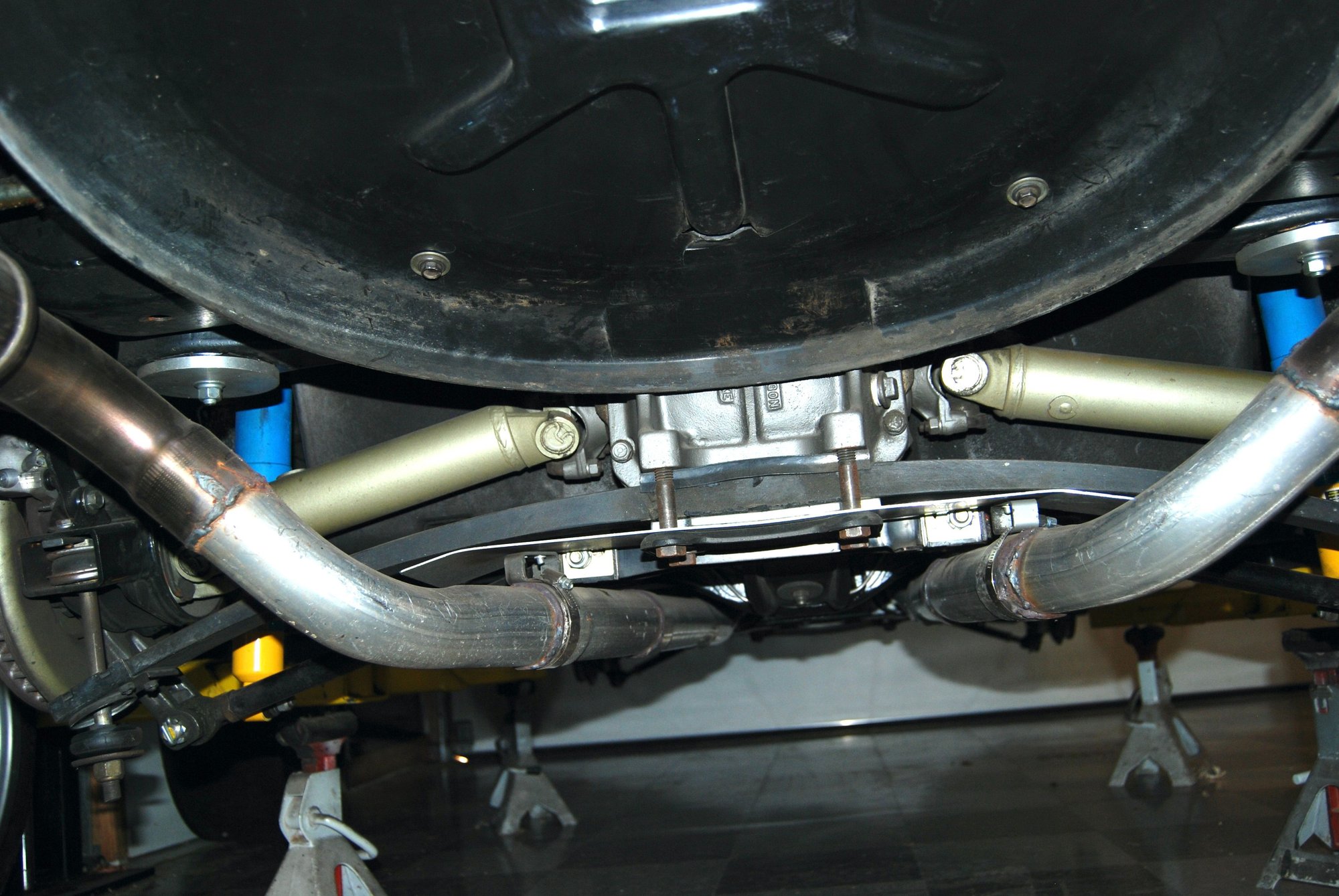

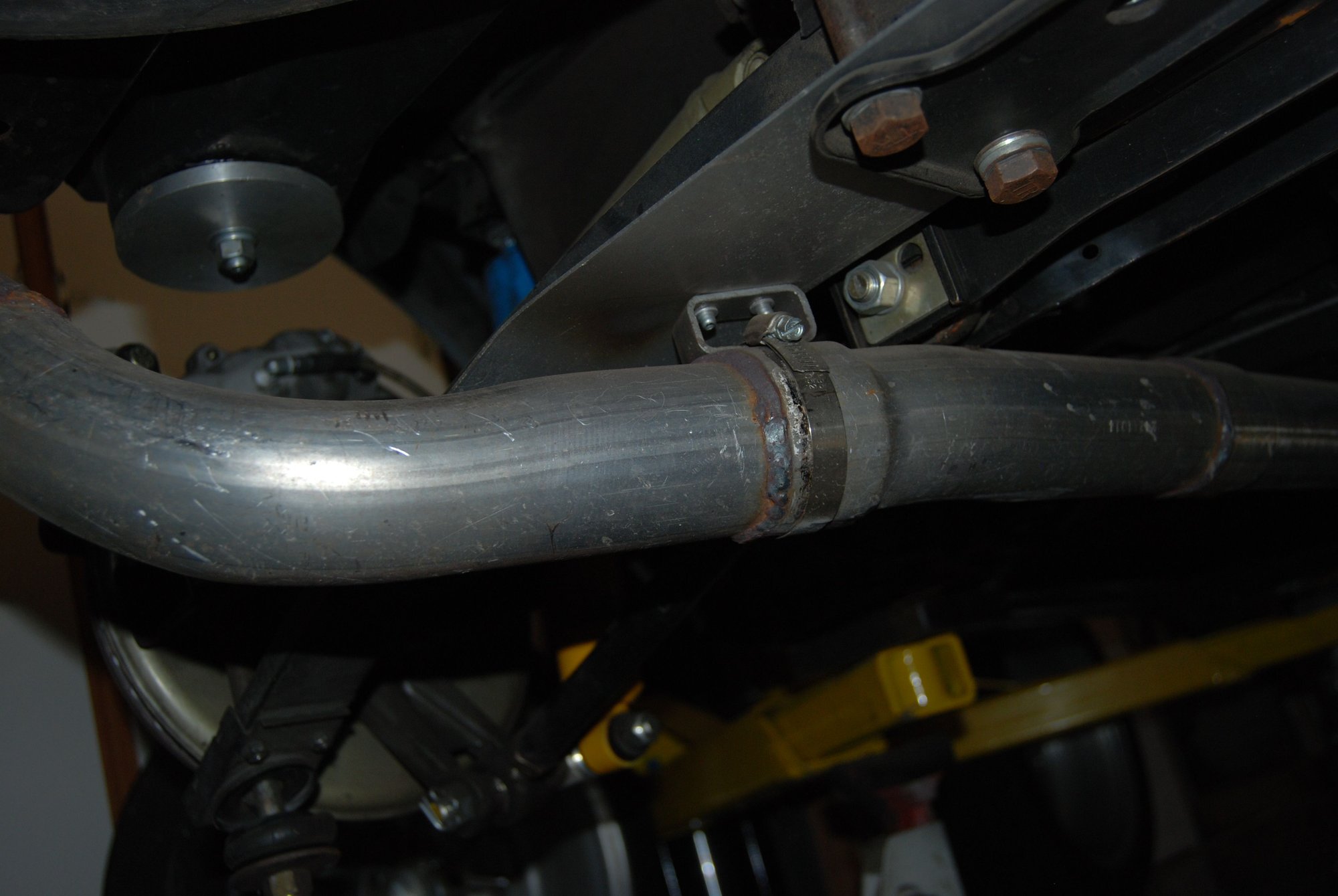

I supported the aft end of the system at a heat shield under my diff. Study this picture a bit to see what I did

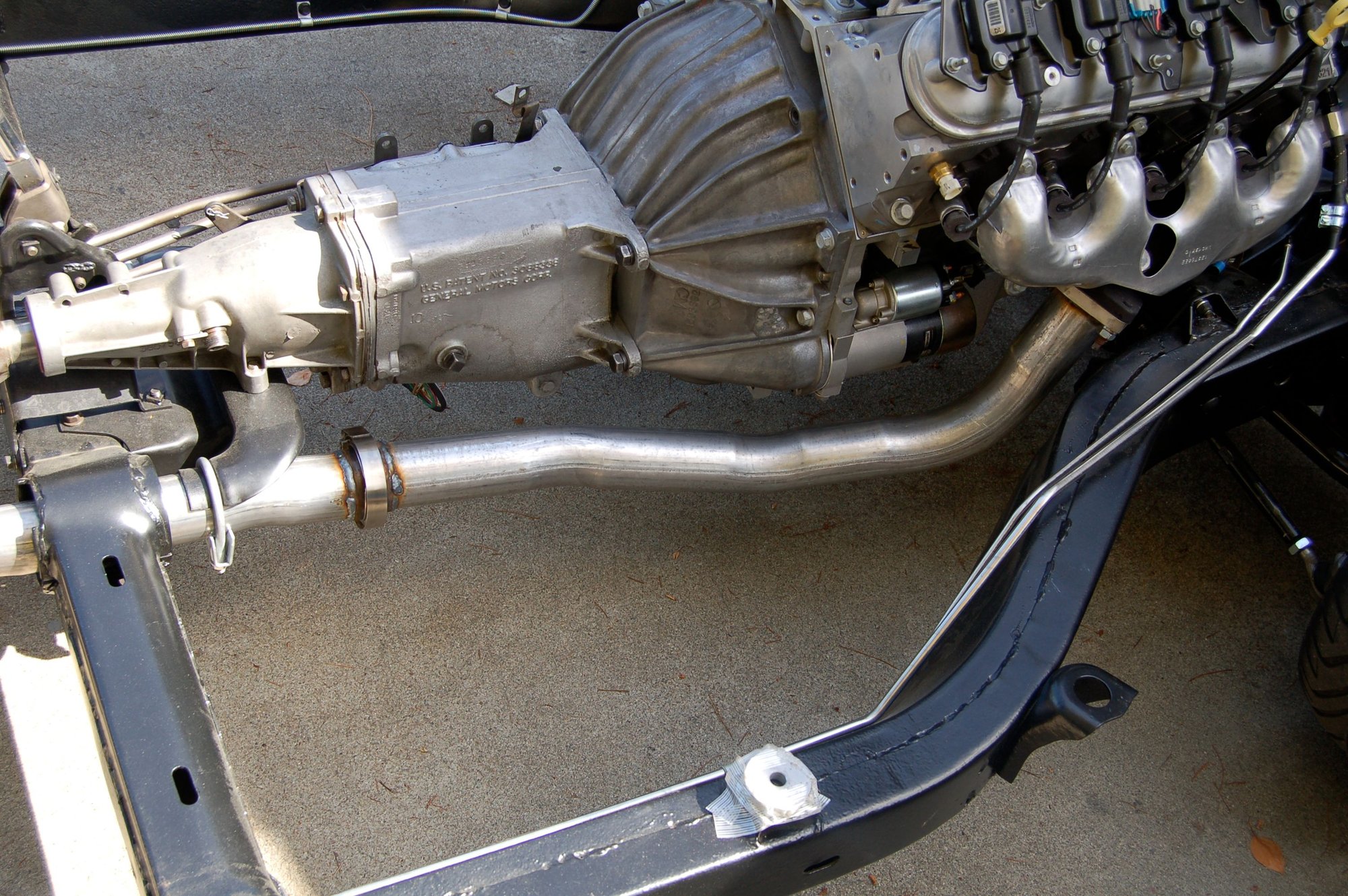

Modify your tranny crossmember to let the exhaust pass under. Check out this video.....At about the 5 minute mark. That BowTie Overdrives crossmember lets the exhaust pipes PASS UNDER the crossmember. This gives you a whole bunch more options and makes everything easier and straighter. I made my own exhaust-pass-under-crossmember to let the exhaust pass under but it would probably been easier (and cheaper since I ended up buying a plasma cutter.....I'm ok with that) and cheaper to take one of these BowTie Overdrive crossmembers and modify the ends to make it fit.

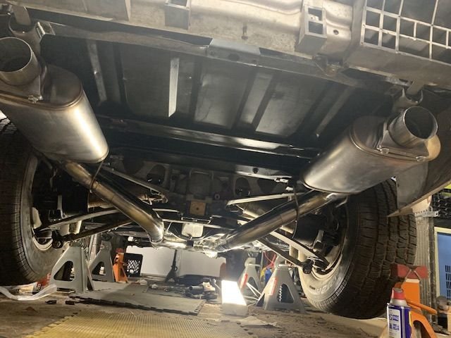

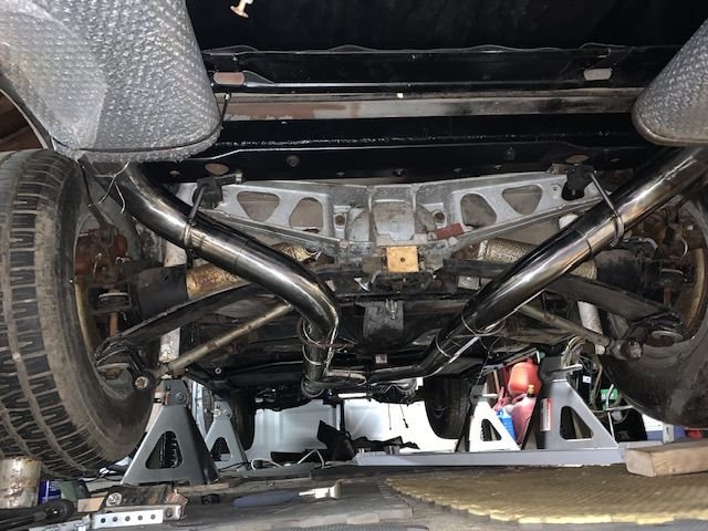

On my 78 I did: All 3" mandrel except mufflers are aluminized
  • bowtie Overdrive 700r4 crossmember
  • 82-92 firebird ebay long tube headers 3" slip collectors (304ss) $200
  • two flowmaster 200 cell high flow 3" cats (304ss) $160 total
  • short sections of 3" stainless with 3" Vbands (all 304ss) $50
  • Speed engineering universal 3" 304SS Xpipe with 45* legs $100
  • two 12-18" of straight 3" 304ss pipes $20
  • two 90* 304ss bends into two 90* 304ss bends $40-50
  • right into two 3" dynomax ultra turbo mufflers with hidden turndowns at the rear bumper. $80
originally I had no cats and 3" straight through magnaflow knock offs. It was too loud so I went with the dynomax turbos and its much better. I figure the Cats will help a little with sound but more for the exhaust smell.

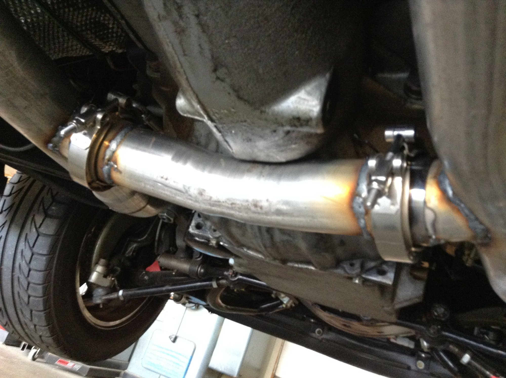

I posted some pics, but you can do it all in 2.5" for cheaper. I did 3" bc I had the headers and most of the exhaust piping in 3" already but its not that loud. The turbo mufflers really make it nice. A 2.5" would easily knock a few bucks off.

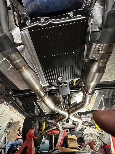

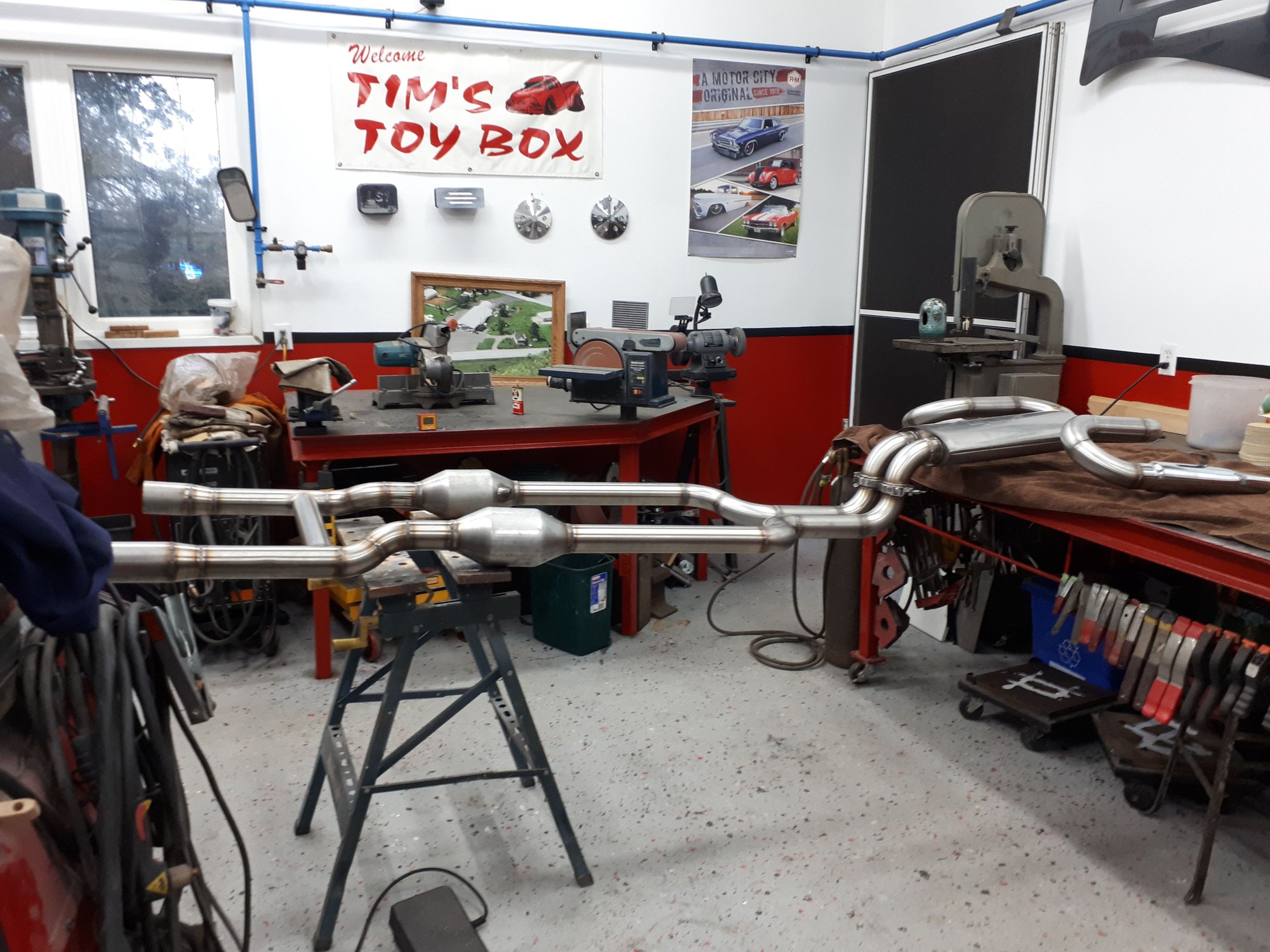

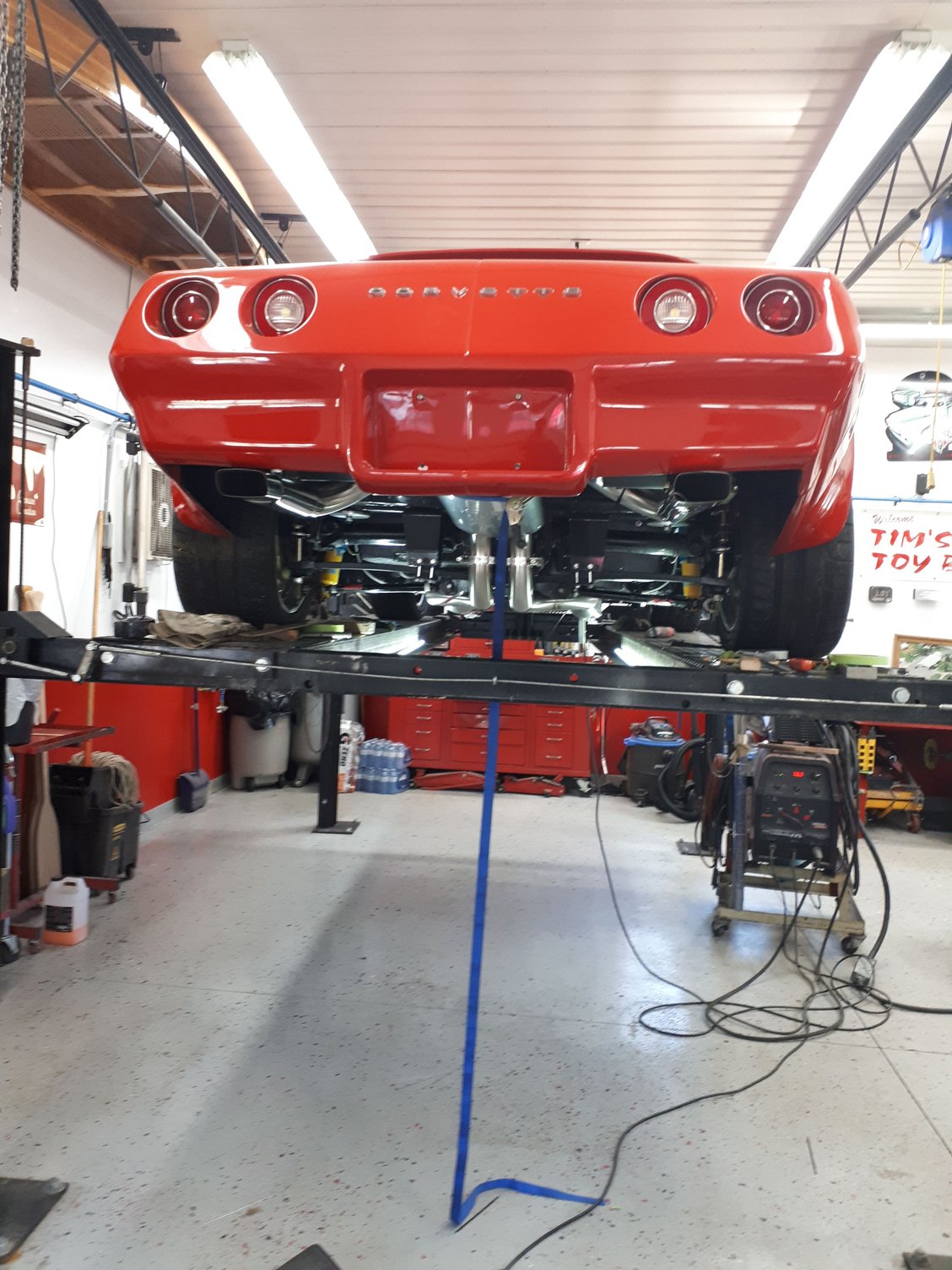

Here's a couple of pictures of what I did for my ls2 exhaust. I have long tube headers with 3 in collectors reduced to 2.5 through high flow cats back to a borla x pipe mufler. It's built with ss tubing using 90 deg elbows and 2 10 ft lenghts of pipe.
Old Apr 18, 2024 | 05:07 PM
carriljc's Avatar
carriljc
Joined: Jan 2001
Posts: 6,743
Likes: 1,385
corvette74
Whereabouts under the car do those cats sit?
Old Apr 18, 2024 | 05:36 PM
corvette74's Avatar
corvette74
Joined: Jan 2005
Posts: 343
Likes: 129
From: Napanee Ontario
They are about 6 in behind the g force trans cross member.

I really think that the tranny crossmember to let the exhaust pass under (Bowtie Overdrives part mentioned above) is the hot ticket. You can then run straighter pipes, or even route them as you wish, or even "ovalize" them for clearance, and not have to shove them through those crossmember holes immediately aft, and right next to, the tranny.
I would suggest it is well worth spending the money on crossmember and then the exhaust is easy peasy (and probably even cheaper since it can be almost straight)...... and if you're going to cut a Manual Crossmember then might as well make it to let the exhaust pass-under.

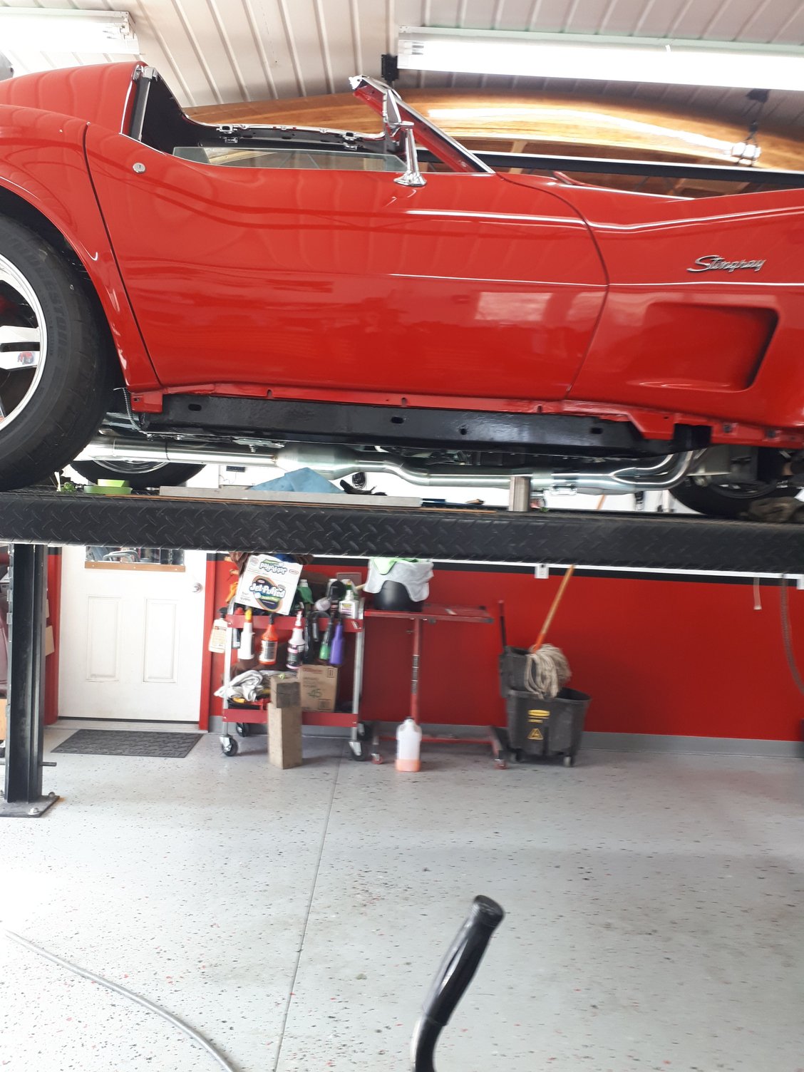

Question - do you find the exhaust hangs too low in this set up, it's definitely the low point of your car. I want to do long tube headers, but I'm definitely lowering the car and if the headers are going to hang a few inches lower, it may cause an issue.

Morning, I measured the ground clearance and it's 3.25". As for the headers I bought them from a member/vendor called speedhound. If I remember correctly he designed them when the LS engines were first starting to be swapped. After that I think it was Melrose that started to produce them.

Got it, that’s a fairly low clearance. Do you find that they scrape at all? And is your car at a stock ride height?
