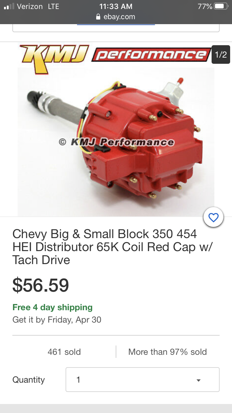

At the risk of jinxing myself, I’ll provide a counterpoint: I’ve got about 4,000 miles on a $56.00 eBay sourced (brand new) H.E.I. distributor with tach drive. Probably China made, I dunno. (KMJ Performance??). I did, however, take about 30 minutes before installing it to tweak the rotor contact so it just missed all the cap contacts while spinning. It was pretty far away before I did that.
To throw salt on the wound, I paired it with a $26 (!) set of extra long plug wires so I could run them underneath the headers, fully expecting the whole shebang to give me fits.
Darn if it didn’t fool me and has been running true for thousands of miles. <shrug>

Got a link for that dizzy? I don't even have a tach drive.
This is the screen grab from when I bought it in April 2021:
