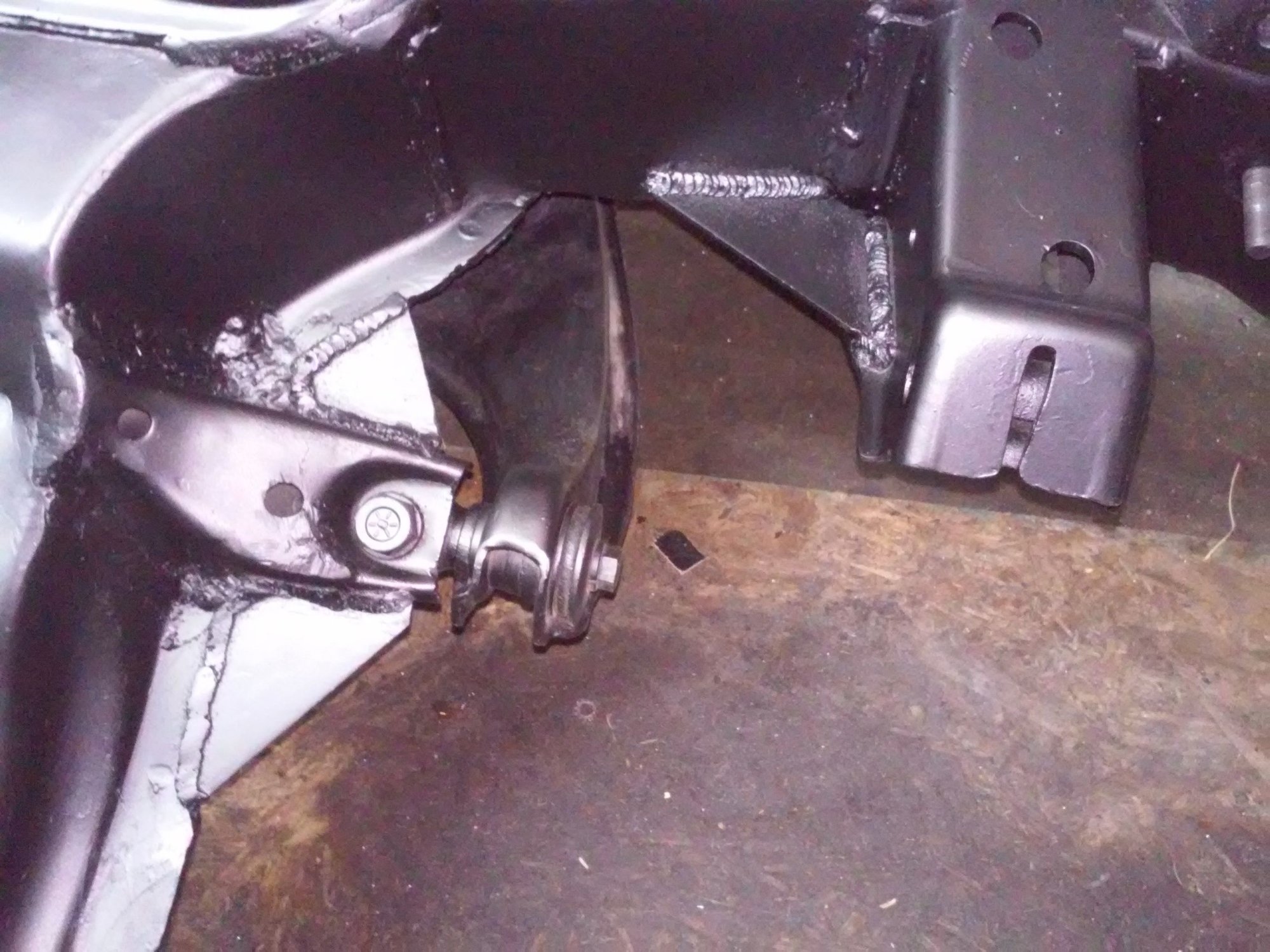

I added gussets to the lower A Arms and pass engine mount.The Borg .brace itself is all thats needed,no welding necessary

Thanks, I think I will look into doing something similar to yours. Mine had small cracks at the top of the A arm bracket, so I just welded them, but this seems like a good idea.
