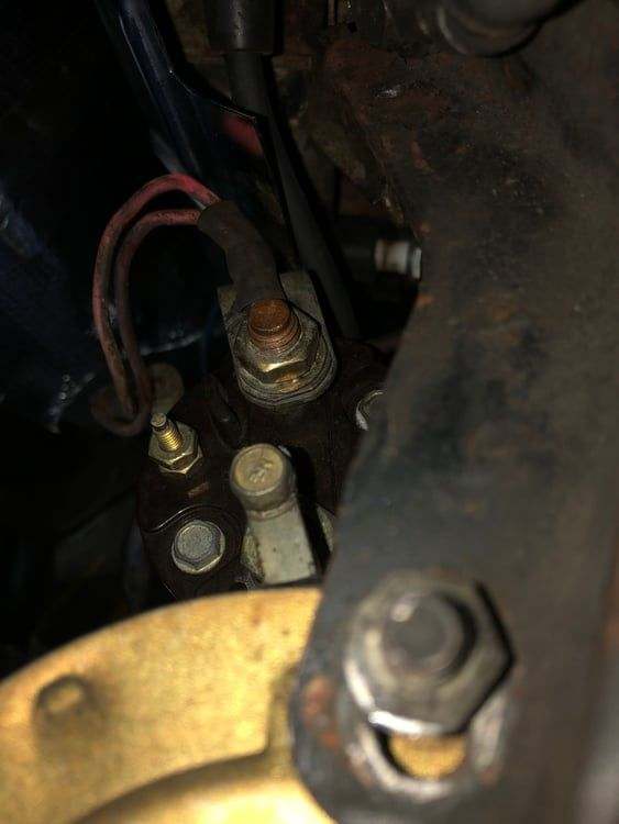

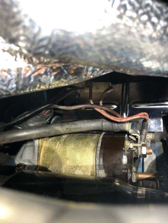

Post some pics of potential smoke area too…maybe someone will see something.
odd only ignition on still smokes..look close at main power wire..its very tight on starter with other hot wires..always thought too close..
here is a 79 l82 pics and thread if helpful
https://www.corvetteforum.com/forums...-starting.html
yeah it is really a big ol cluster of wires down there. I’m gonna go through em tomorrow and I’ll post some pics if I get stumped it seems to be coming from the top of the starter near the solenoid. I think something with the wiring down there could be off I’m gonna take all the wires off inspect em and see what I see.

I'd be shocked if it's not the starter extension harness. My 80 came with the insulation cooked off of the fusible links, but was still running. Here's what a new one looks like. @interpon's images show the starter end of this.
https://www.zip-corvette.com/79-w-ac...w-aux-fan.html
