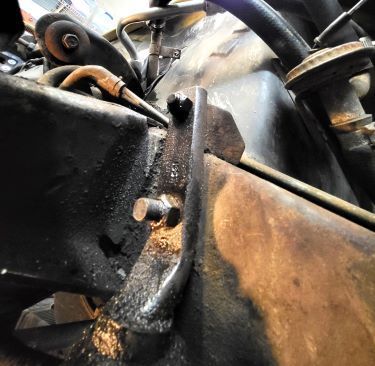

Went to remove the idler arm, and got 2 turns on the lower nut, then the bolt started free spinning. Gotta figure out how to reach the back of that bolt, and the frame has no access, Drill a hole on the back? Sigh..... Just having too much fun with this.

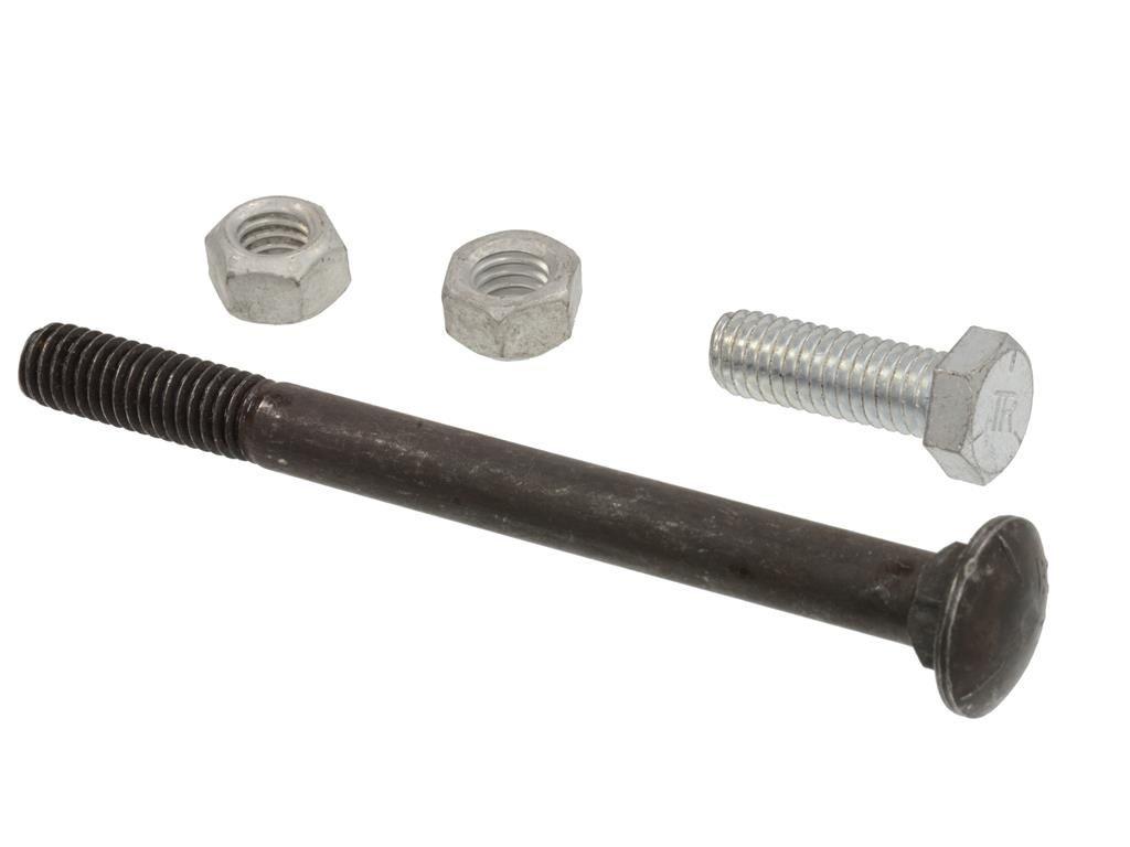

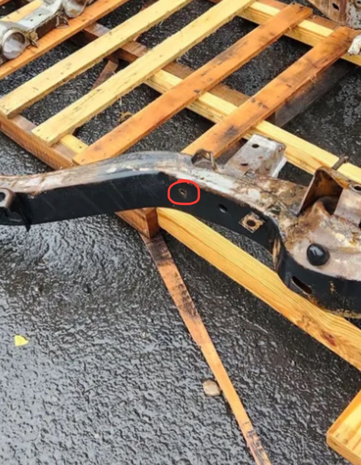

The idler arm lower bolt is a carriage bolt. It goes through the frame in the passenger wheel well.

Dang it! You beat me to it. Went back out after having some tea and looked at it through the fender well. Nice rounded head bolt that I can't get good enough grip on with the vice grip. Should be easy enough to tack weld it in a couple of spots to keep it from spinning. (light enough welds to easily grind off when/if I replace that arm in the future.
Thanks for the quick reply

see post above your last.. can't you pull (or push from back) on nut while unscrewing? the carriage should hold it unless stripped.. clean the threads so its easier

I only got two turns on it when it started spinning. Looked at the carriage bolt head, and there was no discernible gap between the head and frame. I'll probably tack weld it to get the nut off, then replace the carriage bolt with a regular, hardened bolt that fits the hole.

I like the tack weld idea better. If the threads on the bolt are stripped off and not just the nut. I would replace with the correct carriage bolt. It's done that way so the tire doesn't get cut up on full lock.

I understand that, but I have always had a great hatred in my heart for carriage bolts. Probably something to do with the Great Cucamonga Carriage Bolt Incident of 1875. Still gives me 'tha shudders' even thinking about it.
Edit - I just got the "done that way so the tire doesn't get cut up on full lock", so having a hex-bolt head facing the tire might not be a good idea...... Tack weld it is!!!!
