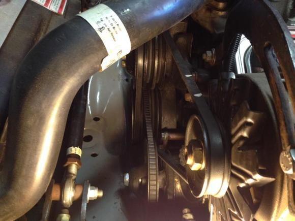

Engine mounts are in. Idler arm down. Oil pan off/cleaned/painted. Cam out. Front of engine cleaned/painted. Going to scrape the OEM oil pan gasket tomorrow morning and get to putting it back together.
The timing chain was tight - no slop. Really starting to believe the motor was babied. Cam lobes look brand new, journals are smooth and shiny. Lifters were pretty much perfect. With 52K miles on this car, I am happily surprised.
