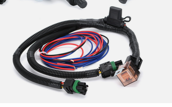

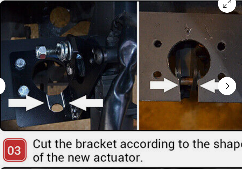

The cheaper kit-
It's a Chinese copy of what Corvette Forum members designed over 10 years ago.
When the kits came to market a year ago- they were $400- now they are on fire sale-I'm guessing
there is not such thing as a bad product - only a bad price.
The original design used Miata motors- which were nice quality pieces but in the past 5 years or so - tough to find (no longer in production) and getting expensive for good used ones.
The motors in the Chinese kit are knock off- with lots of plastic parts
-No tech help- no instructions
-Requires cutting up your headlight supports-
-Splices into the parking light - so the headlights do not function as originals
- No terminals on the power wires
and a big issue
-The harness is a fire hazard-
1) the wire is not rated for underhood use (SAE J-1128 rated for 256ºF)
2) you always fuse at the source of power- the fuse is designed to blow before the wire melts-
clearly the harness is not designed that way.
3) The clear case( poorly designed ) relay could possibly melt- resulting in a fire. The socket holder is not rated either!
4) The one I saw- wire was copper coated aluminum- a big no-no in a mobile environment
Trust me on these- years ago I worked for Kenwood-
Unfortunately they sourced a cheap fuse holder for the
entry level radio to bring the price down. After a a couple months Kenwood had to purchase 4 cars (3 brand new)
as the plastic on the fuse holder melted when the poor quality spring internally got to hot and melted the plastic- set them on fire!
Lesson learned-
