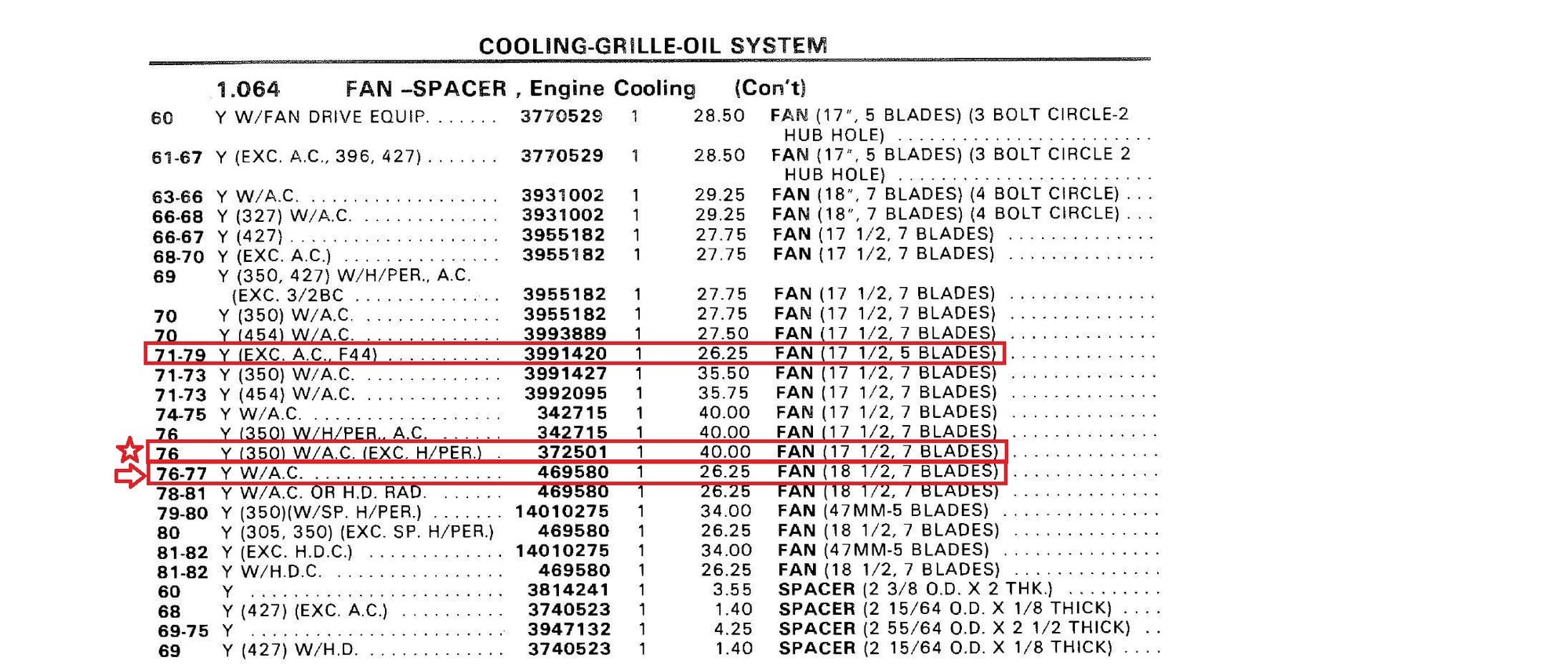

On a 1977 how many fan blades should it have? Non Air car.

Looking at the 77 AIM UPC 6K Sheet 1 there were just 2 different fan blades installed...
My guess would be a manual transmission L82 would have received the 5 blade fan A/C or not...
Part number 372501 was superseded to 469580 around 6/76 as per the AIM...
that makes sense.. thanks.. i find it funny too like my 79 L82 HP manual that is says 47 mm.. which i assume is 470mm 18.5 inches as they mix up and transition to metric.. looks like bigger was better as the years roll on..interesting..
i think at least in 79 the L82 H/PERF drops to 5 blades regardless of AC.. must be extra HP.. also added electric fan just in case lol
