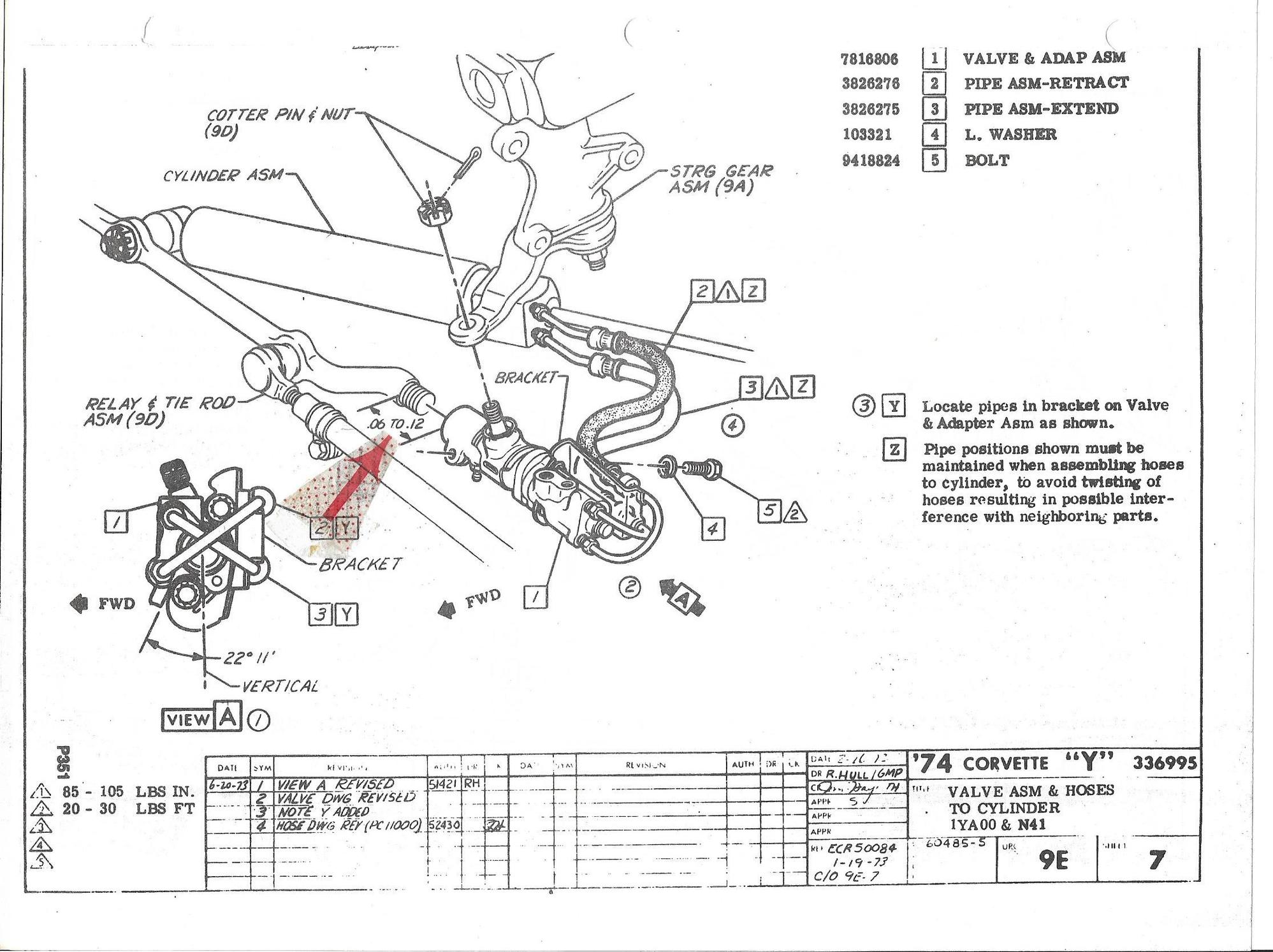

Originally Posted by Jerry1978
If I could jump on this and ask a related question? Can the valve be removed without pulling the cylinder and rod on the end? I have already replaced those parts and would prefer not to start all over.
Here's the valve and the other parts you will find down there:

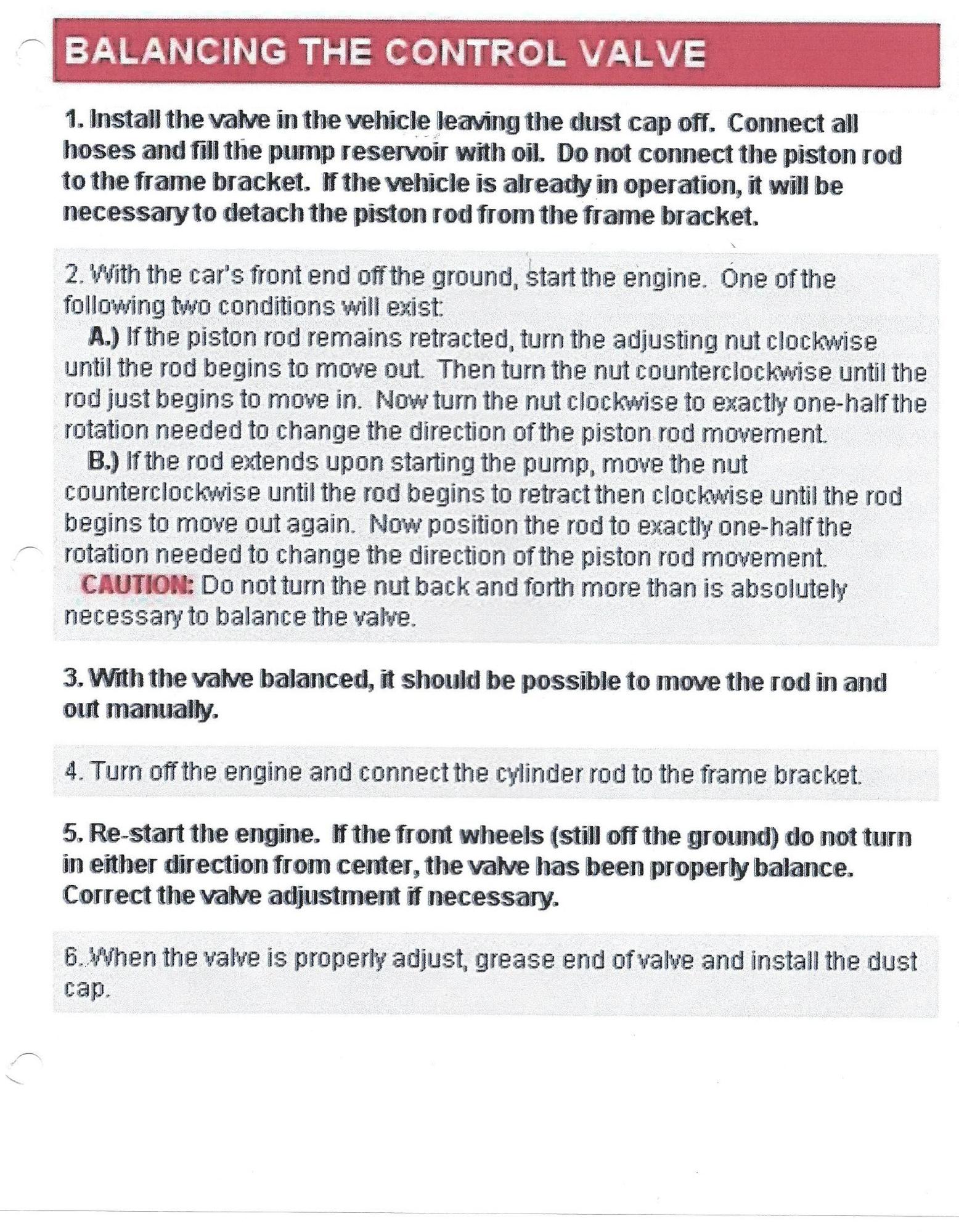

You will have to balance the valve after you install it:

Super helpful Peterbuilt. Thanks.
Got it off yesterday. going to break it down before ordering the kit...just to make sure the hard parts are still good.
Any guidance on the amount of grease to put into the fitting? The videos I have watched focus on not pinching the seal, but do no mention greasing it.
I grease the little sleeve thing. Other than that, don't over think it. It's easy.
