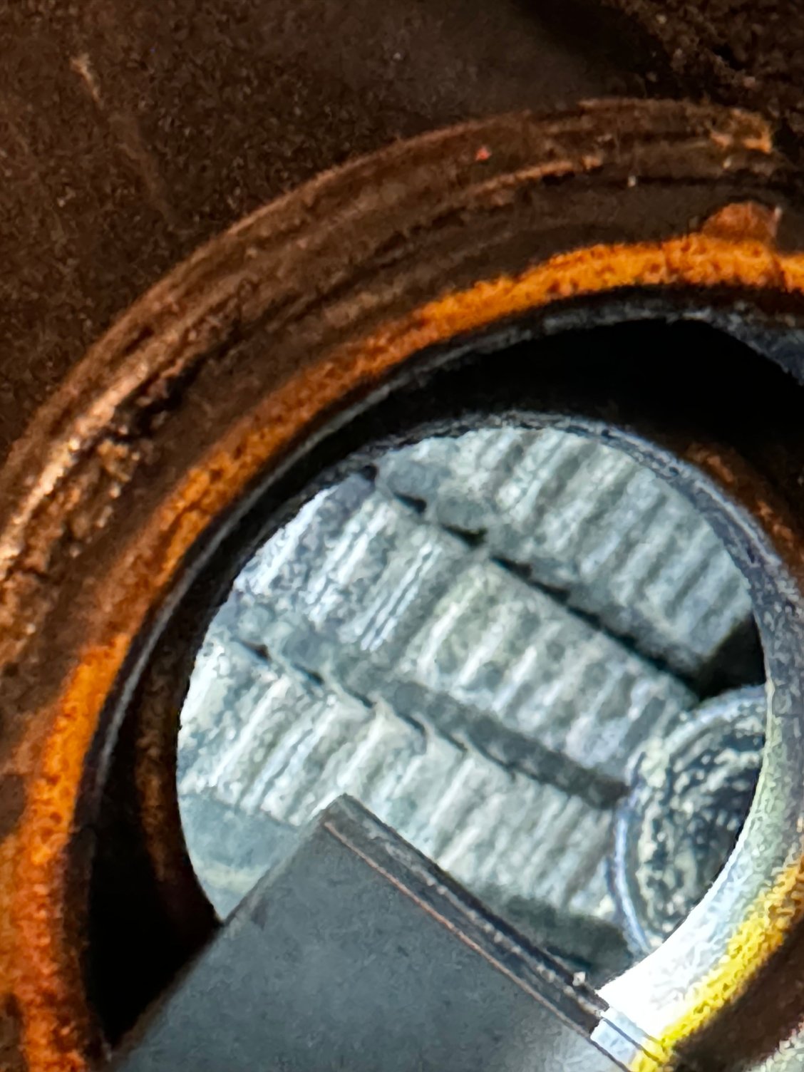

Originally Posted by Buccaneer
OK, you show the top radiator foam pieces, but what about the sides? You MUST have the side pieces in place correctly as well, which is actually more important than the top. Are those all the way down the sides with a snug fit?
I did the best I could to include the side foam pieces in the pictures. I'll see if I can get another angle of it. As you know there's not much space to work with lol.

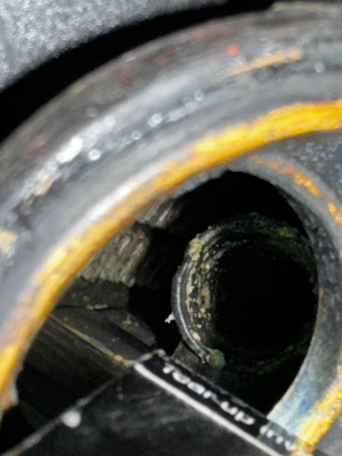

Not that it means anything but the radiator was replaced maybe 1000 miles before I bought it and I’ve put maybe 2k since I bought it. As far as I can tell no tap/well water has been in it. There is a little gunk as you can see in one of the pics but otherwise the radiator seems to be fairly clean.
Before I start driving it again I’m looking to run some of the radiator flush through it and try to make sure that there isn’t any gunk or sludge in the system.
The pictures don’t really do it justice. It looks cleaner than what it looks like. My phone had a difficult time trying to focus on the tubes. I’ll see about getting a better shot of it.

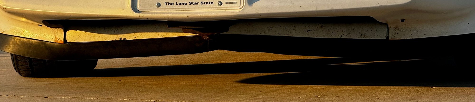

I got the new air dams in today and got them installed. Still waiting on new tubes to the water pump from the heater core.
with the new dams installed they look better, however, I’m concerned that they may be pushed back a little too much to properly redirect airflow to the radiator. When removing the passenger side it was easier to do than the driver side. The driver side near the nose was pushed inward making it difficult to get a wrench to the back. I had to use a pair of pliers to bend it out a bit to get the wrench on the bolt. It bent back on its own and makes me wonder if it’s normal or not correct. See the pics below.

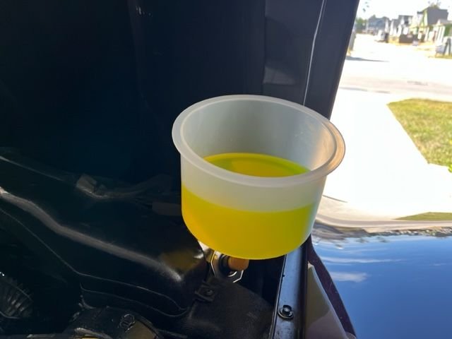

Red flag here is Rad was recently replaced . Most don't get the system burped correctly. Get this funnel and let car idle letting the air bleed out. With the heater on max...

I already have one and when I lost coolant before I made sure to use it to burp the coolant. I’ll be sure to use it again when I get everything back together here in a bit.

Sometimes it takes more than one try. That's the mistake many make. My 80 did. And most recent my son's 350 Z took 3 times. I have an Air Lift tool as well I used on Vipers and later C4's. On these older cars I don't mess around with old parts. If I'm changing the Rad the water pump, all the hoses if their old and T-Stat gets replaced with (2) 5/64 holes drilled in the t-stat to help. Barring a leak, obstruction from debris etc. I haven't had one yet I could get to run below 195 in summer.

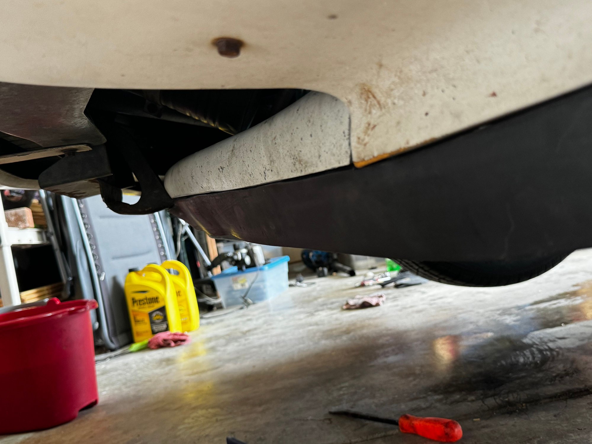

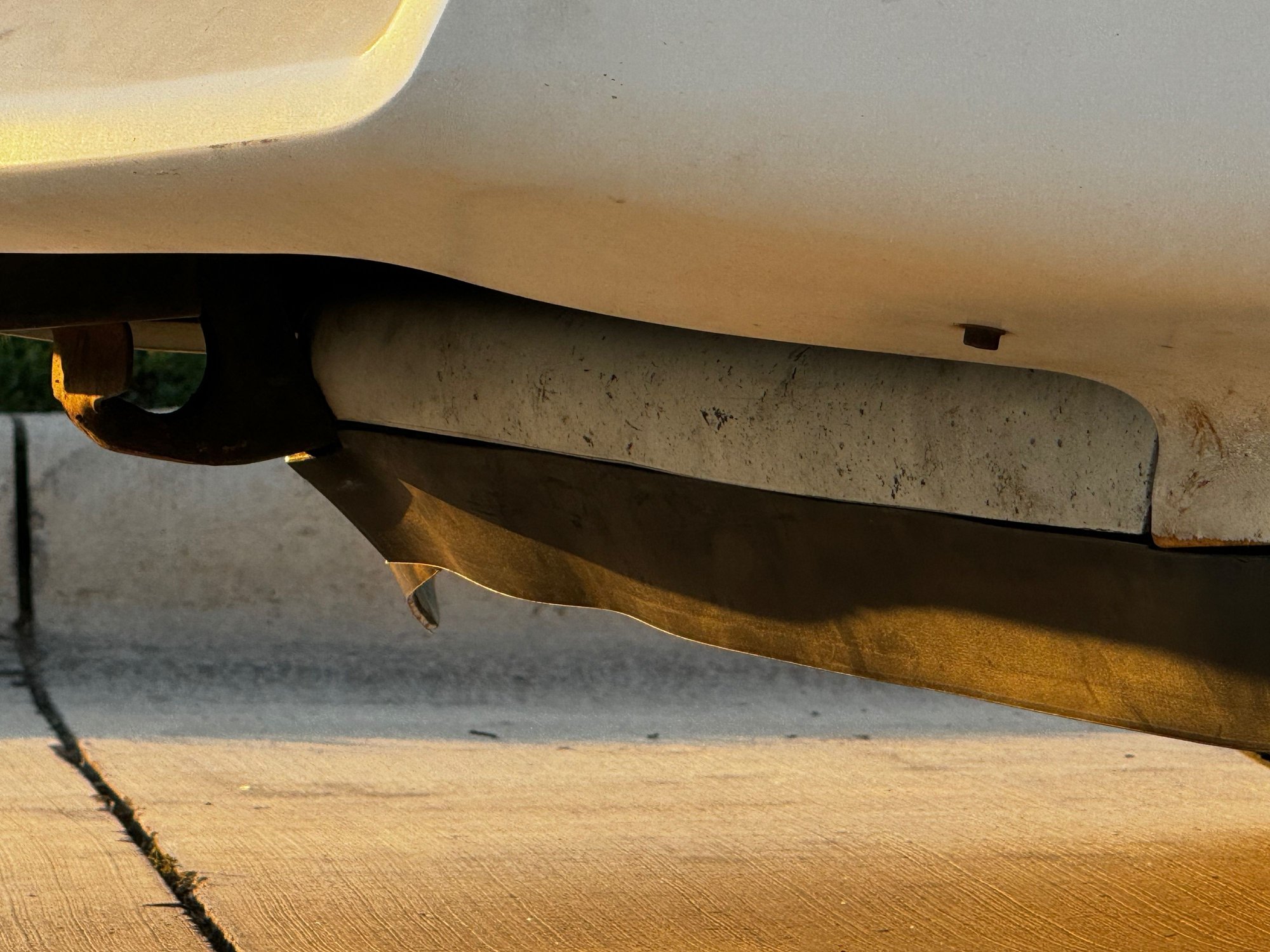

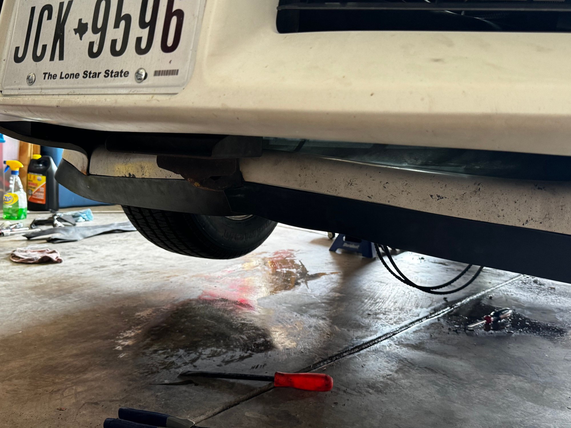

Now I'm not familiar with '82 front ends at all, but to me it looks like your lower valance is "pushed up" and that the "air dam" isn't angled the correct way. Could you step back from the car and take a few pics from about 6 feet away so we can see what's going on there. That rubber air dam should be angled forward IMO.
I'm pretty sure this is your issue, and some attention should be put here....

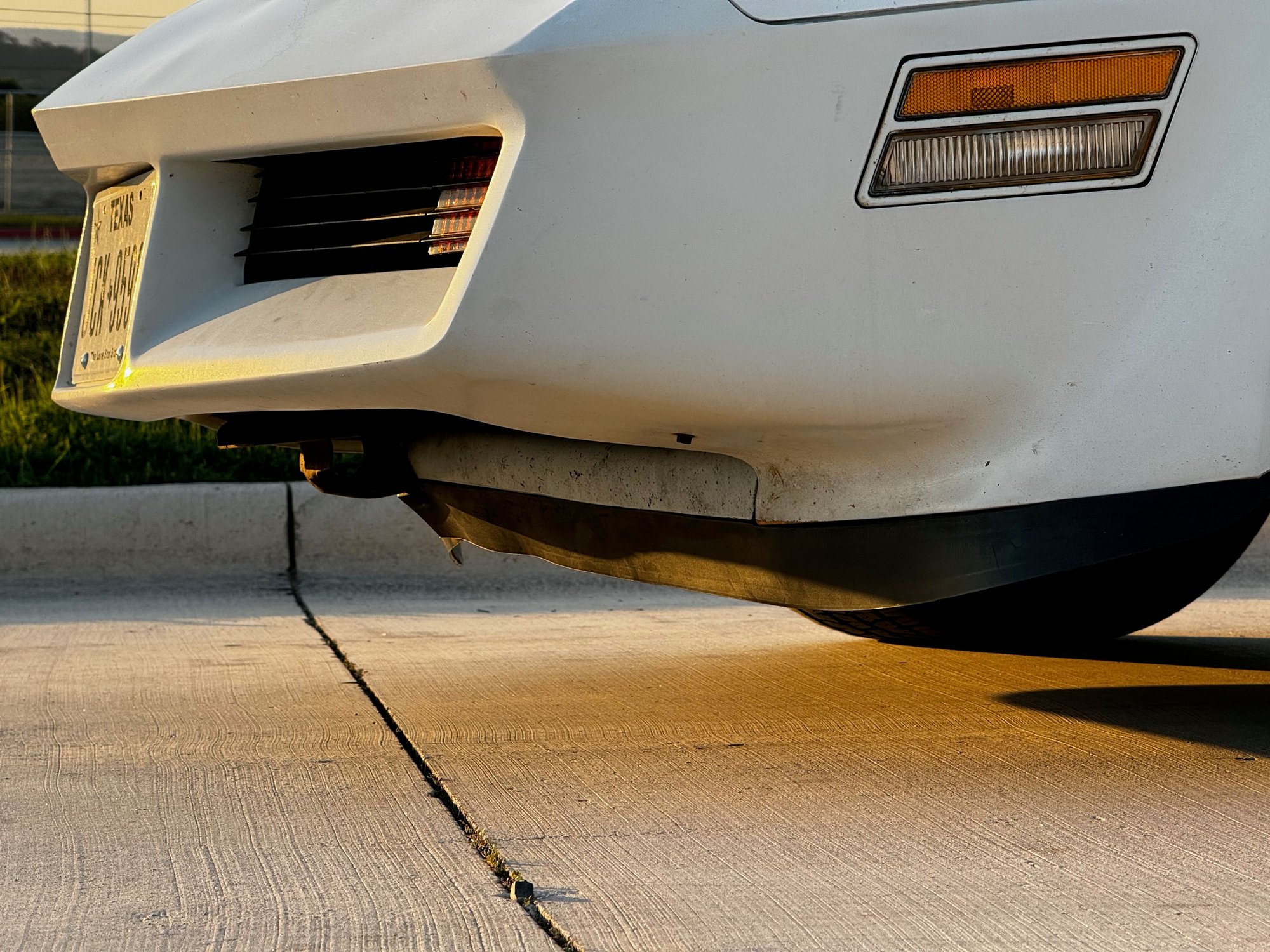

I've honestly been thinking he same thing however, I have not been able to find many pictures of the air dam/valance to begin with. If anyone else has any I would be curious to see how the air dam looks for one that's working correctly. I do feel as though the valance is almost bent in the middle and not "scooping" the air. Could anyone else share a pic or two of your air dams? I know not everyone has an 82 but would be curious to see how it's supposed to look.
I was finally able to get the Vette back on the road after a week of it in pieces. I let it warm up for about 10 minutes while also topping off the coolant/burping. I then took it out on the highway for 10ish minute ride out to a gas station. I noticed that the temp needle was again moving closer to hot rather than coming back down. I am waiting for an IR gun to help verify that the temp is actually creeping up and not just a bad sending unit.
In the meantime, below are the pics of the air dam in it's current state and a bonus sunset pic.

Thanks! Definitely seems as though my air dam is bent back a little. I'm going to see about getting a heat gun to bend it back. I also feel like the tongue/hook that holds the valance up may be bent too far inwards.
