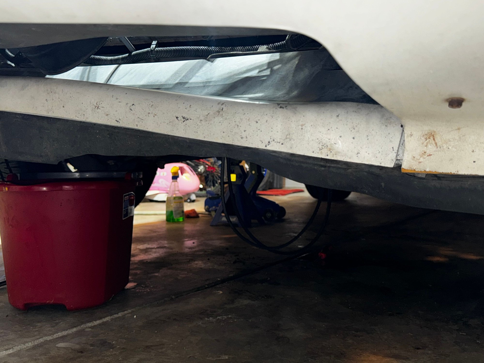

I am about halfway through the repair. Water pump is definitely stock so I'm glad I'm getting it replaced. I can only imagine how many more miles I would have got out of it. I dug the spring out of the old lower hose and re-installed it on the new lower hose (Gates) to help prevent collapsing.
Shown in the images below, the first two show the foam seals that are currently installed (If I had to guess, I'd say that they're not 100% properly installed, thoughts?) the next three pics show the air dam and the valance. Valance looks good to me, other than how at the nose it seems to point a little too far upwards in my opinion. Meanwhile the air dams are not in good shape, currently waiting for new air dams to be delivered.
Passenger side radiator foam
Driver side radiator foam
Drivers side valance
Driver side air dam
Passenger side air dam

Not to knock fixing things that are broken, and the air dam is certainly a critical component of the system, but before you throw more parts at the problem...
Have you independently confirmed the actual operating temperature with an IR temp gun?
Good news on an intact lower radiator hose spring! I don't know where to find those for sale, other than ordering from McMaster-Carr.

Any chance to get pic of inside radiator holes, you might just be marginal on that.
seals to me look good. Spoiler wont hurt
pressure check cooling system?

OK, you show the top radiator foam pieces, but what about the sides? You MUST have the side pieces in place correctly as well, which is actually more important than the top. Are those all the way down the sides with a snug fit?
