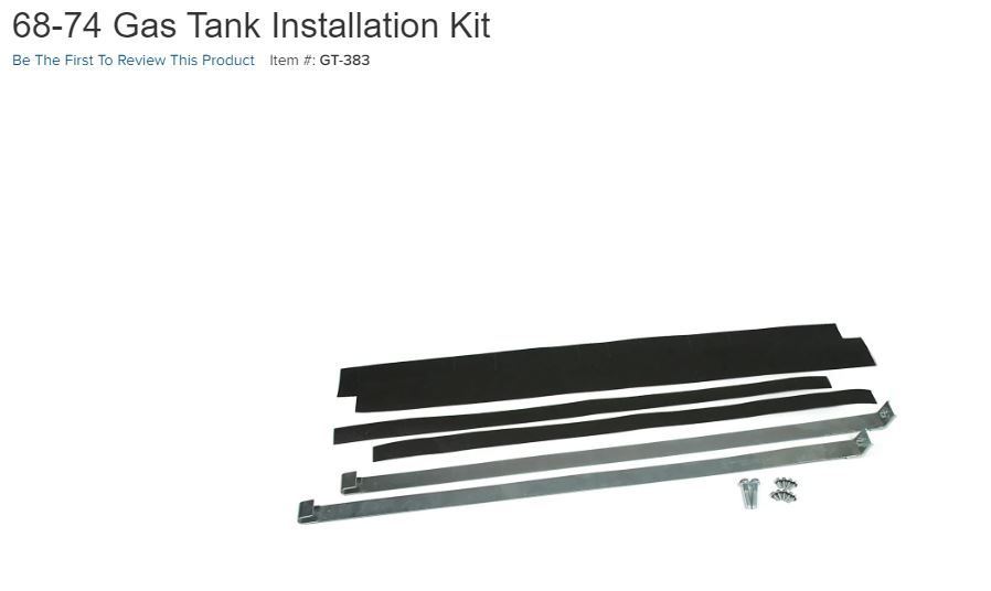

I’m getting ready to install my fuel tank on my 69 and I have some questions. I’ve got the anti squeak strips that go under the tank but I’ve noticed some advertised that appear to go under the tank straps. When I removed the old tank, the only strips were under the tank. None under the straps. Can anyone shed any light on this? I want to ensure I do it right when I install the new tank.

My tank straps had what looked like tar paper between them and the tank.
Appears a kit is sold and looks to have both the tank and straps anti-squeak strips:

Recently had the tank out of a 76. No tar paper on the straps. Had my tank out on my 77 a few years ago. No tar paper on the straps. Perhaps some years have them, some don't?

If it helps with what to do, my 69 had the tar-paper-like straps, top and bottom. Don't know why the difference. No pictures though, simply what I remember.
