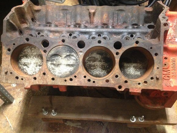

ZQ3 cast flat top 4 eyebrow pistons.
1970 ZQ3 350/300 stock short block.
To 73 l48
