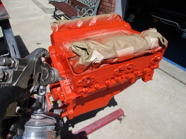

Paint your Chevy Orange engine with good, catalyzed Urethane after doing an epoxy primer on it. All you have to do is request my "Paint Formulas" tech paper, but since you haven't, here is the section dealing with Chevy engine paint:

4. On to the engine. I see guys with nice ‘Vettes using paint out of a cheap spray can that they bought at the local parts store. People with nice ‘Vettes who use spray can paint on their engines should be charged with Vette-abuse, and sentenced to restore Honda Civics for life. If you want your engine to look perfect, to be the perfect, correct color, and to have a durable, lasting finish and shine, you want to shoot it with catalyzed urethane enamel. Here is the factory-correct color code and the whole mixing formula:
PPG Delstar Chevy Engine Orange, DAR #60524 H (Delstar product line has been discontinued, but some stores may have residual inventory of this):
Mixing Formula (1 qt, cumulative):
Color Units (cumulative)
DMR 400 4.0
DMR 405 160
DMR 464 660
DXR 495 680
DMR 499 1250
Mix the paint 8:6:1 Delstar/DTR601 Reducer/DXR80 Catalyst and shoot it with a paint gun. If you have a new engine back from the machine shop and it’s bare metal, prime the entire engine, block, heads, etc. with PPG DP40LF Epoxy Primer mixed 2:1 with DP402LF Catalyst.
PPG Omni MTK (Acrylic Urethane) Chevy Engine Orange, color code MTK 60524 D
Mix the paint 4:1:1 Omni/MR186 Reducer/MH167 Hardener and shoot it with a paint gun. If you have a new engine back from the machine shop and it’s bare metal, prime the entire engine, block, heads, etc. with PPG DP40LF Epoxy Primer mixed 2:1 with DP402LF Catalyst. You won’t believe how good it will look.

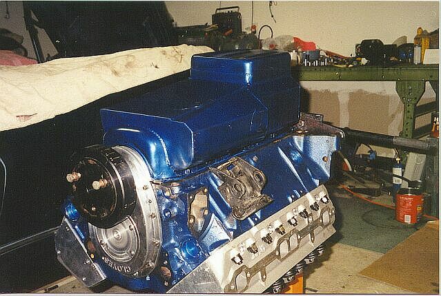

This is my 396 stroker motor. Picture is bad because it's 20 year old! 8 quart stroker pan. Solid roller with Dart 227 cc race ported heads

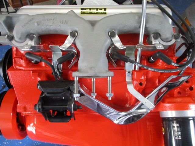

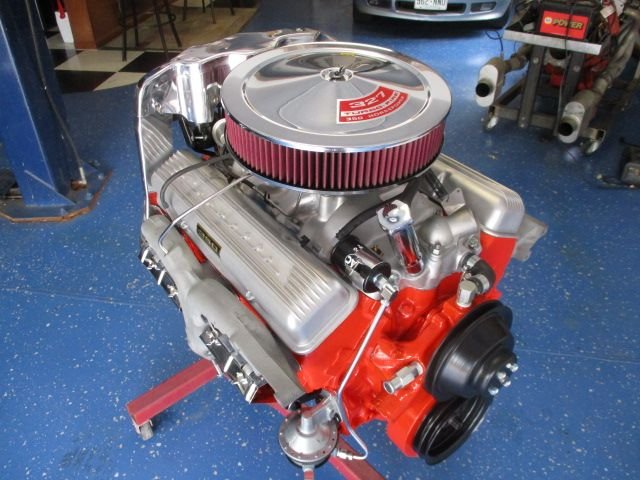

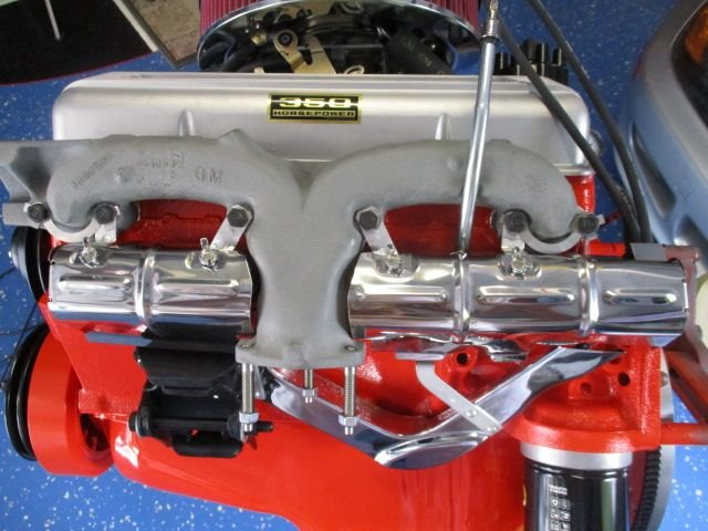

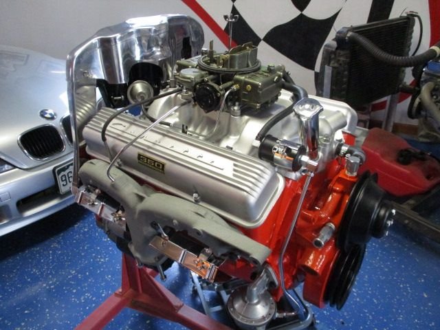

An L79 engine I recently built with the "DP" epoxy primer and high-gloss catalyzed urethane Chevy Orange paint. Have you even seen an engine more ugly..?

Lars,
Did you forget to put masking tape over the stamp pad before paint? NCRS would ding you hard for that. -LOL

Originally Posted by lars
An L79 engine ...Have you even seen an engine more ugly..?
Au contraire! I think it's BEAUTIFUL!
