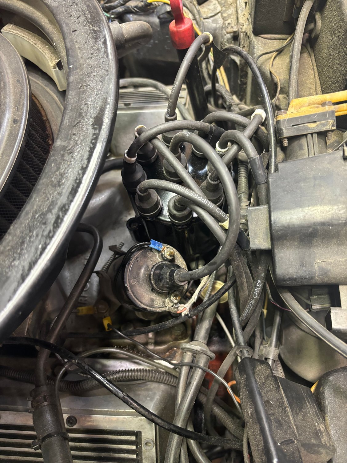

If you have headers look for spark plug wires that are burned
Old Jun 4, 2024 | 09:00 PM
Bikespace's Avatar
Bikespace
Joined: Mar 2017
Posts: 11,948
Likes: 4,506
Backfire (soot in the air cleaner), or afterfire (detonation of fuel in the exhaust)?
Please post pics! Perhaps your distributor clamp loosened up.

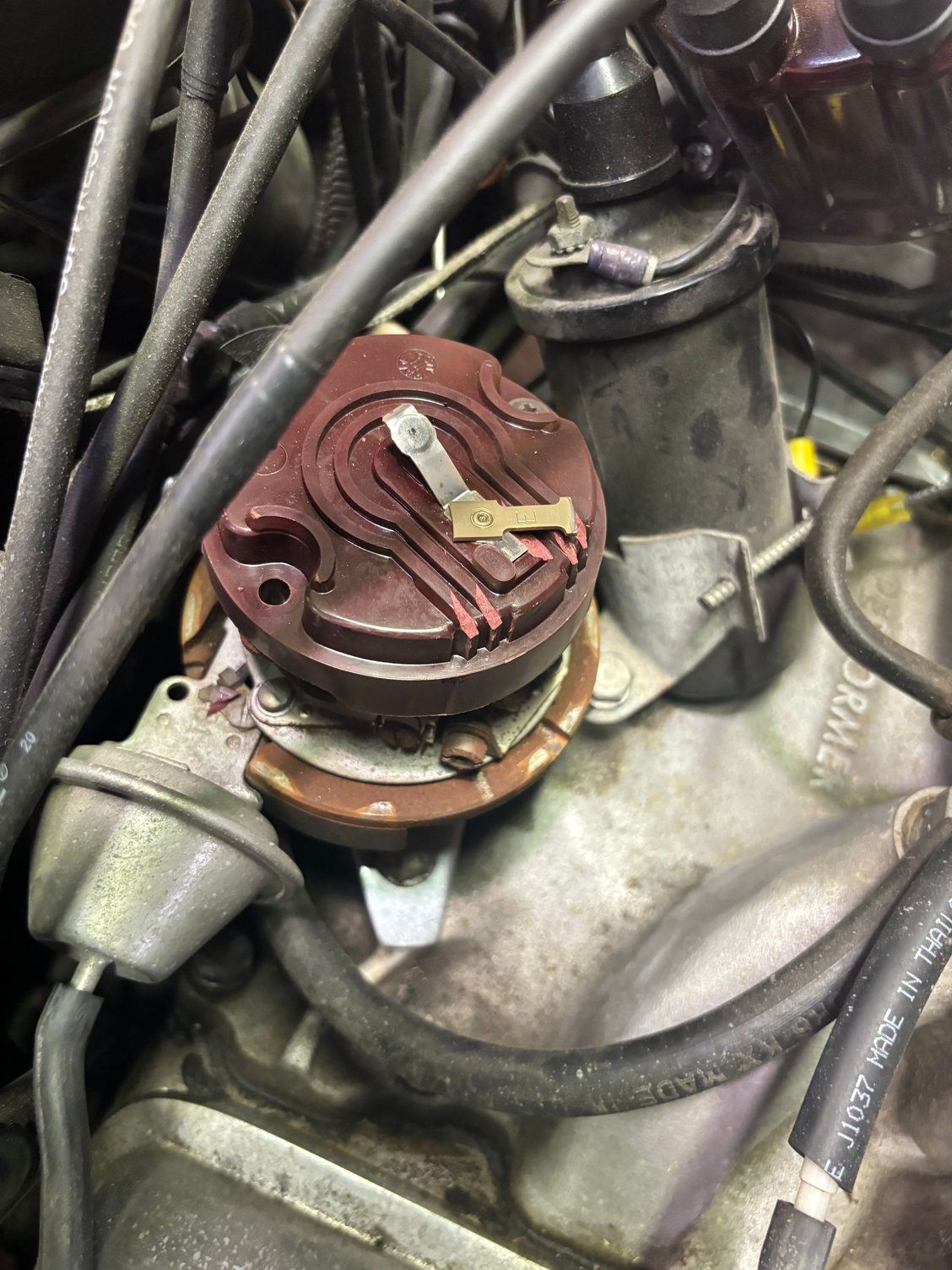

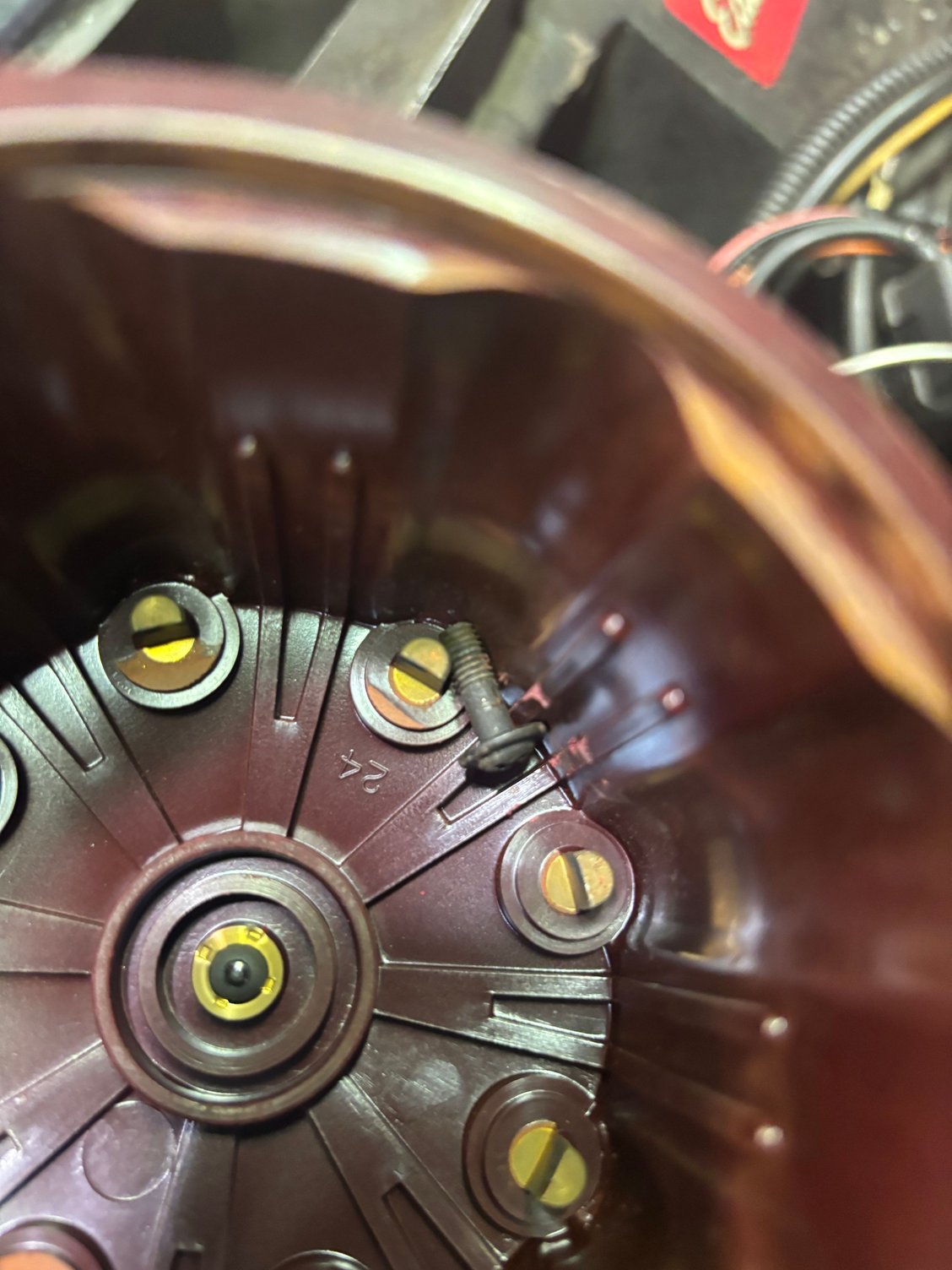

Found the issue:
one of the screws that hold the rotor in place worked itself out and messed up the tip and the cap
never seen this before

While you are in there I'd replace that purple connector on your coil. Appears it's not a ring terminal but one that is open on the end and just held on one side by the nut.

All back together and running good again new cap, rotor, and points from Summit Racing. I put a touch of thread locker on the screws so it doesn’t happen again.
