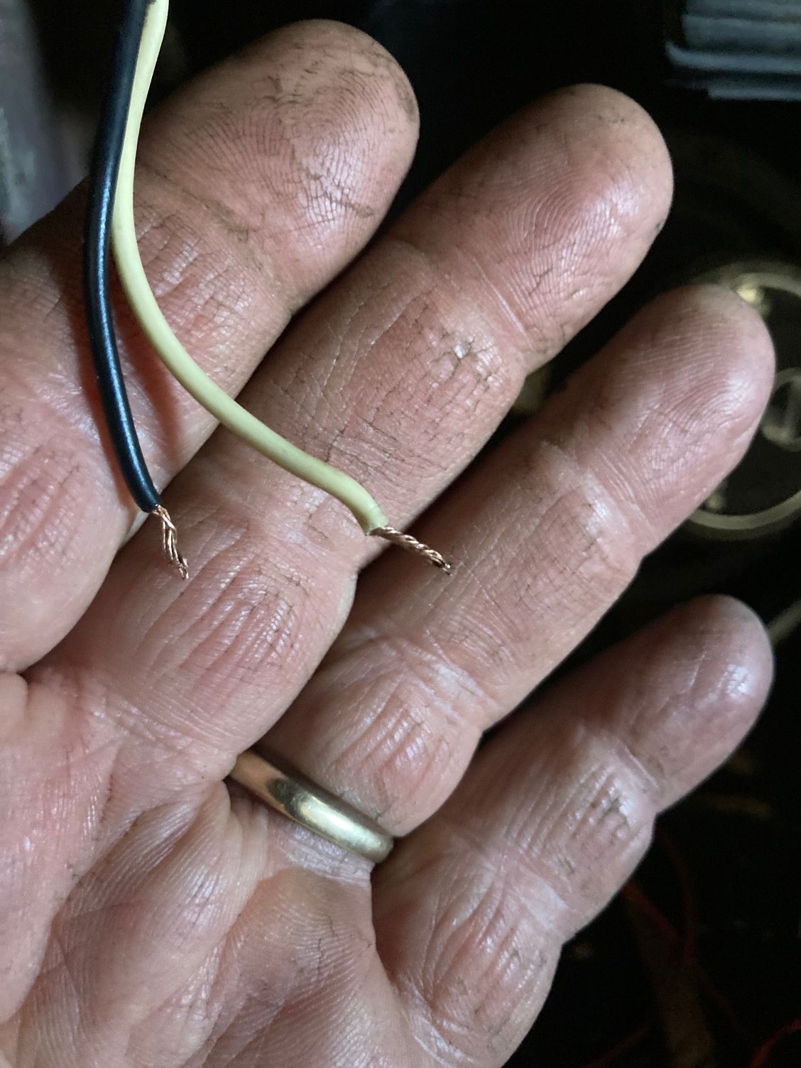

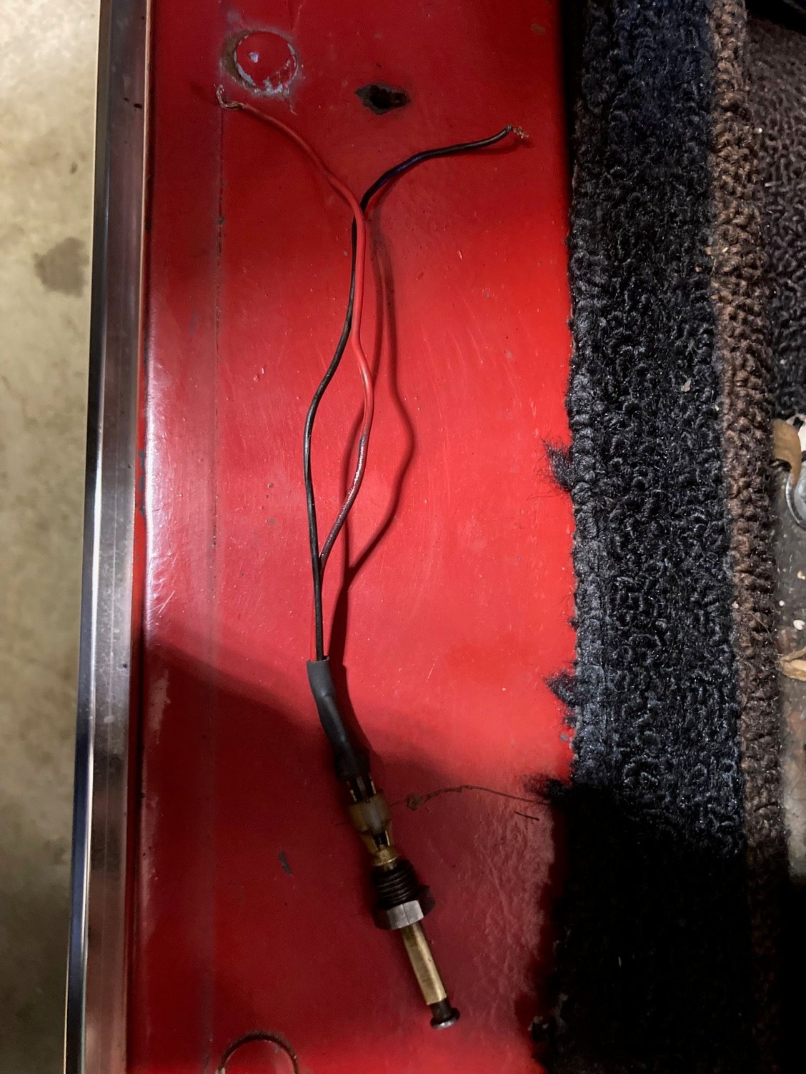

I have two driver side switches that function as they should when tested for continuity.
When i install them nothing happens. Actually nothing happens when i touch the two wires together.
I thought, this may be the problem, that the jamb switch, when the door is open, creates continuity from one wire through the switch to the other wire which turns on the light.
What did happen, and i dont want to try this until someone helps me because i dont want to blow a fuse, i noticed when i pulled the wires out of the car to test, one of them hit a ground(i assume) and the lights lit. I dont want to do that again.

When i put my meter, setting on V, on the black wire from the car, the warning buzzer goes off -i guess indicating the door is open?
When i put my meter, setting on V, on the white wire from the car, the courtesy lights go on.
Maybe my switch is not grounding out? Thats the Next thing i will do.

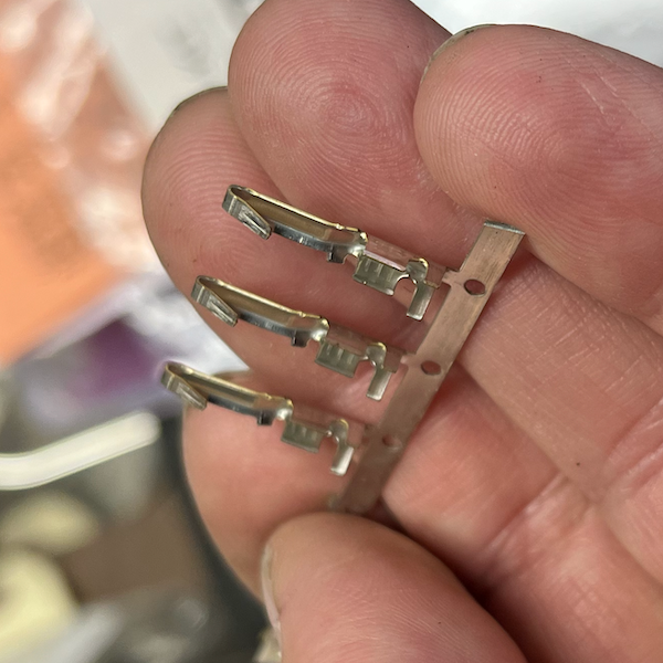

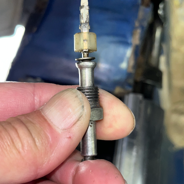

The A-pillar that the switch screws into provides the ground through the body of the switch. The wires are secured in the white plastic cylinder with just the tips of the terminals exposed. When the door is opened, the tips contact the washer looking part of the main body and complete the ground connection. The problem happens when the tiny clip on the terminal becomes loose and doesn't keep the tip of the terminal exposed. A new switch won't fix the issue, but you can buy new terminals. I got mine on eBay because the mailing costs were much less than regular vendors.
When you touched the wires to the A-pillar, as you pulled them out, you completed the circuit the same way the switch does. You didn't and won't harm anything.

Good information, I thought it was a complete molded unit. I am going to rebuild mine. Thanks
