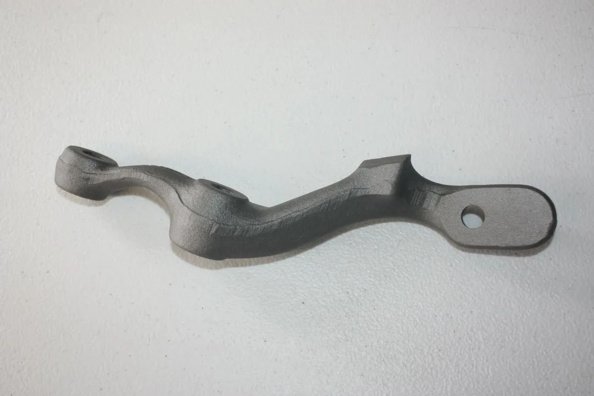

For those unaware, GM put plugs in the outboard holes on the double-hole knuckles when the car was a power steering build. If you think you only have a single inboard hole on an early/mid-C3, look closely for a metal plug. The two holes provide different steering ratios but faster ratio (inner hole) comes with higher effort on a manual steering car.

I am aware of that but these have no hole or plug. Solid like Mooser's pic above. Thank You.
