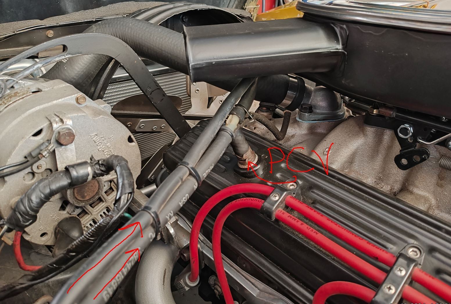

Pretty sure that is the suck side, and if pcv working ok a breather should be ok.

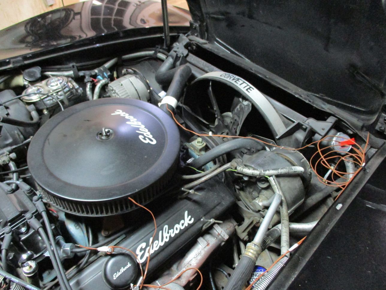

I converted mine from Edelbrock garbage, back to stock-ish, before yanking for an LS swap. Appearance was never a concern. Somewhere I have some plots that I made that show the benefit of the dual snorkel CAI, at least for stock-ish cars. I don't know what the upper bound is, but someone could do that experiment by measuring the pressure drop at the carb intake.

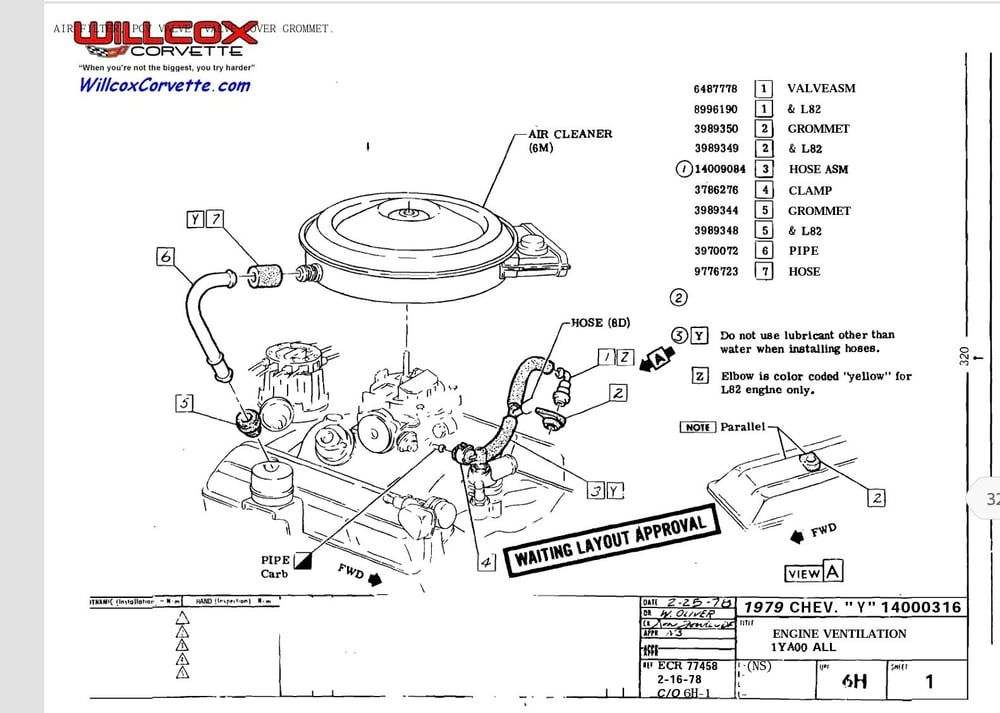

And now I've seen a picture of what the ducting/hoses for the cold air intake looks like. That whole thing was missing when I bought this corvette. I'll bet an after market one isn't cheap.
Cold air intake image

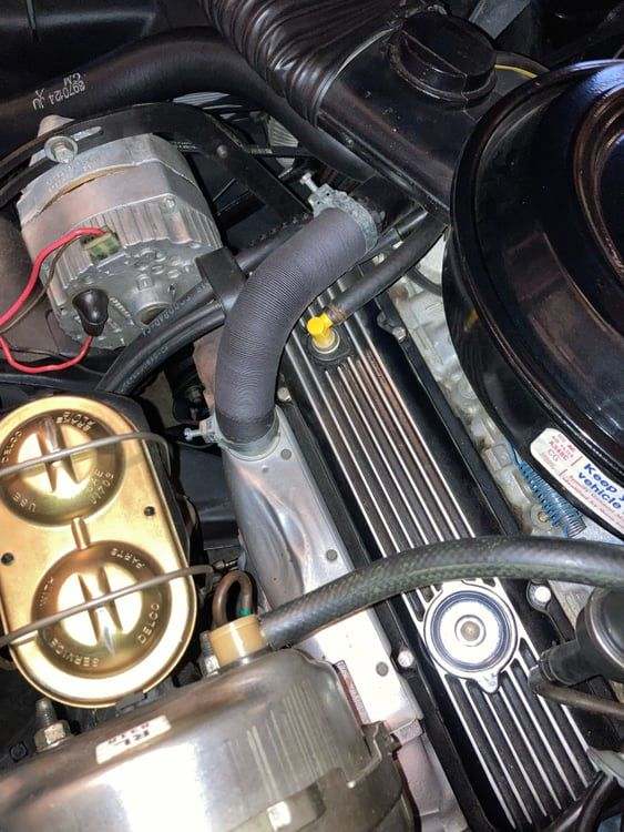

What does your driver's side valve cover look like? pic?

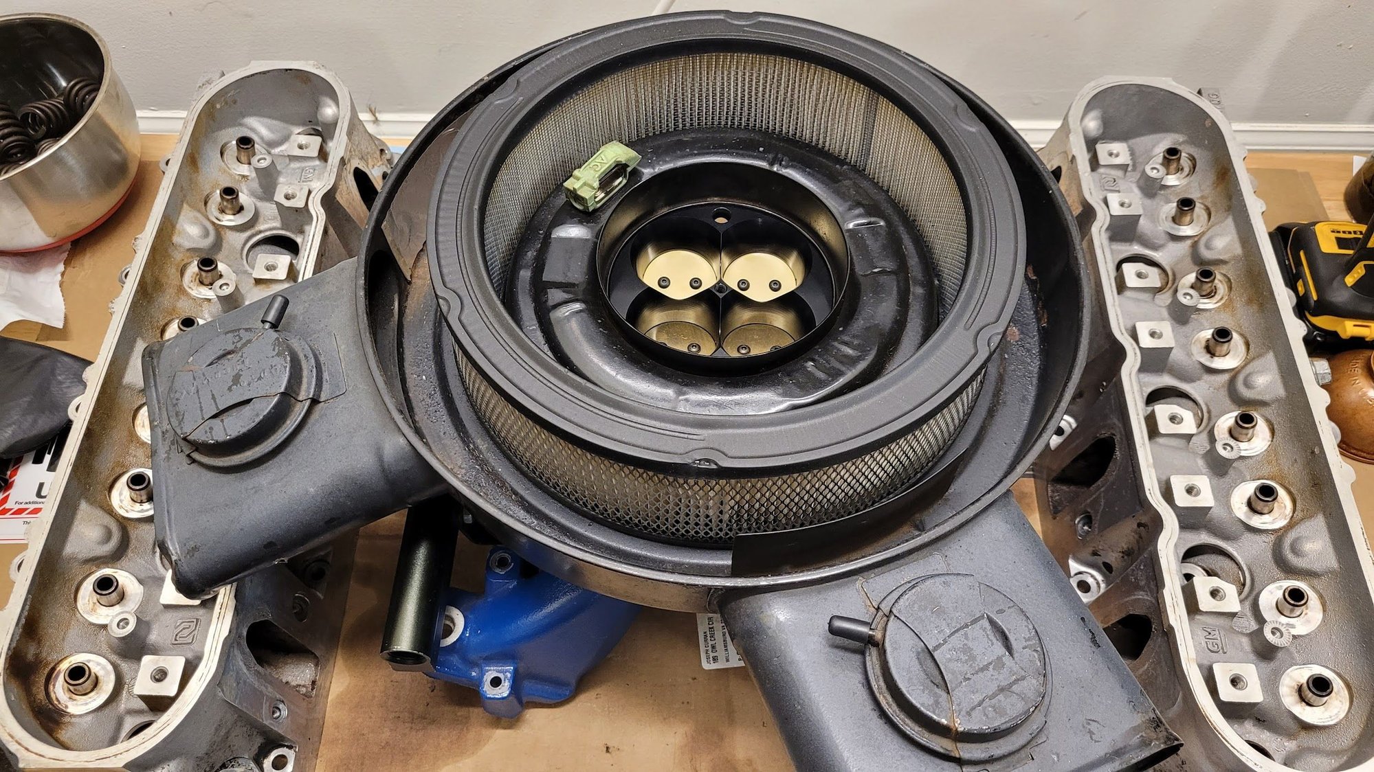

Here is the setup on my '71. Stock Dual Snorkel air cleaner
Passenger side
Passenger side
Drivers side. Hoses come from the charcoal canister in the fender (Evap emission system sucks fuel fumes from the tank through the charcoal canister and into the intake through carb vacuum ports) and one line is "T"ed to the PCV valve and ends up at the base of the carb.

BKarol: Driver's side looks like the pic Interpon posted.

Before and after in my 79. Don't mind the thermocouple wires, the experiment they supported proved to me that the L82 CAI system is worth it. I just need to dechrome a bit now.

My 78 L82

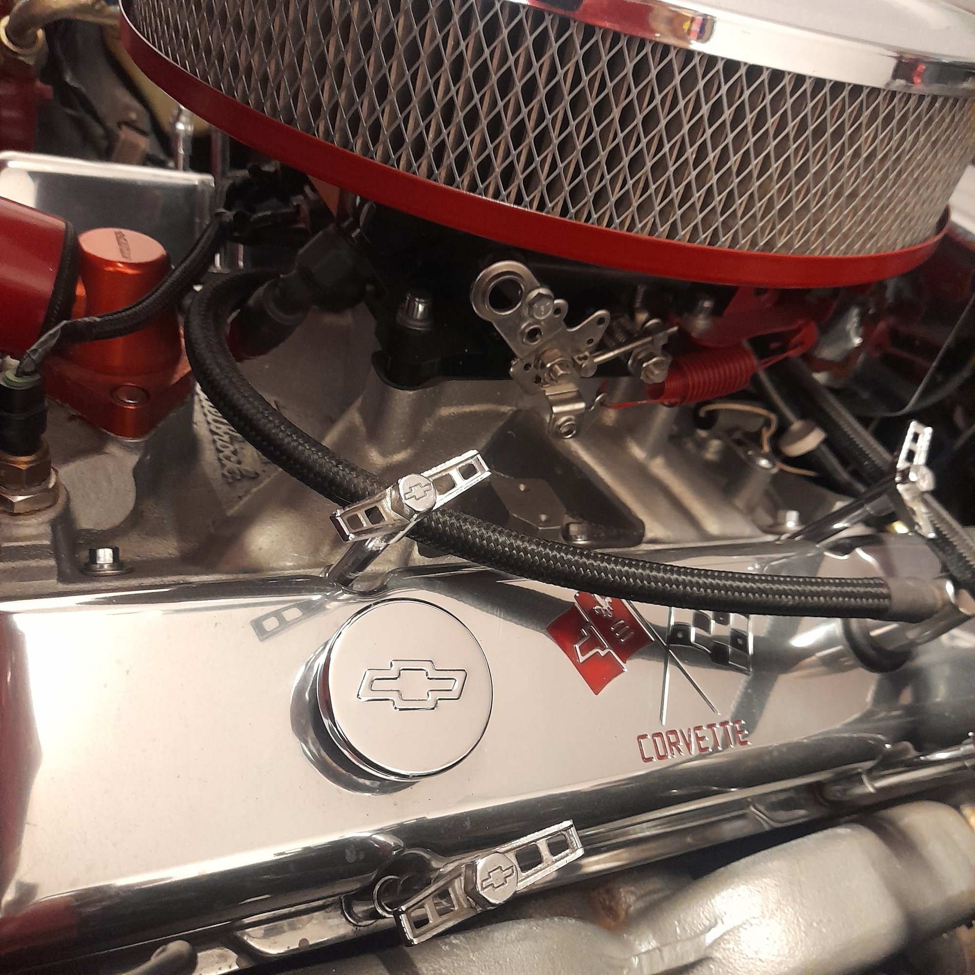

I thought I'd post up my solution. 77 Vette. Lost the factory ugly airfilter years ago.
Drivers side, GM Performance PCV routed to base of throttle body.
Factory breather tube covered with sleeving to match other lines on engine, routed to bottom of aftermarket airfilter base.

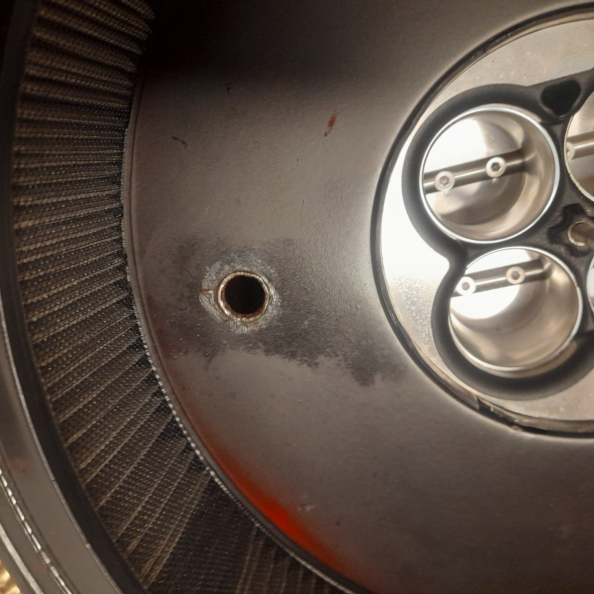

A view of the inside of the airfilter, yup a bit home made. But functional installation of a steel nipple to connect breather line. To those who say sucking oil into the carb is a bad thing. See any oil here? Haven't had this cover off in months. No I didn't clean a thing.
Now I realise that I could put in a breather cap that would likely spit oil on my valve cover. And some may prefer that. I prefer this. The air is filtered as the fitting is inside the main filter.
