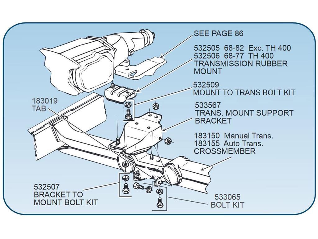

So I got my 69 stripped down as far as I am going. Harmonic balancer and forward are out including radiator. Driveshaft back is out. My exhaust hanger needs changed and I wanna get the tranny mount and bracket out to clean up etc. can I just use my HF motorcycle jack to put upward pressure on the tranny and loosen bolts back and forth...or will that put too much torque on the engine mounts? Maybe loosen up engine mounts a bit first?

Yes you can. If your motor mounts are ok you won't harm them. It would be a good time to eyeball them anyway.

Once you unbolt the rear trans mount you only need to lift the tailshaft 1/2 inch or so to pull out the old mount and exhaust bracket. Super easy.
Will that allow me to get the whole mount bracket off too?
Old Jun 16, 2024 | 02:07 AM
4-vettes's Avatar
4-vettes
Posts: 13,238
Likes: 7,828
Cruise-In VIII Veteran
Yup.
