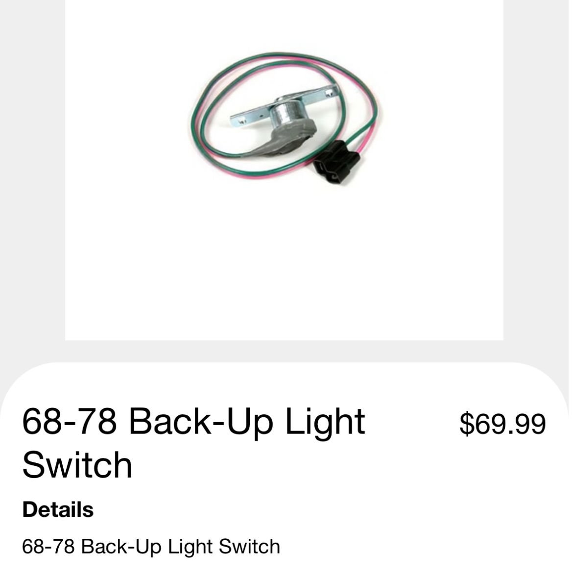

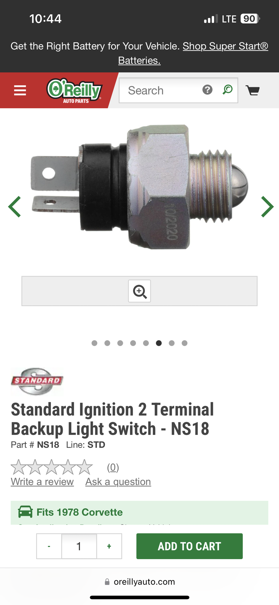

My back up lights/middle two tail lights do not light up. The fuse is intact, the turn signals work, so next I traced the wires back to the transmission. From what I can see the green and pink wires are connected to this, “backup safety switch”, (First picture). I assume somehow the previous owner installed the wrong switch. Can anyone confirm that the first picture, which I found on O’Reilly’s site, is the wrong switch. Do I need to purchase the switch in the second picture? 1978 Corvette with four speed manual.

. The second switch is for the backup lights and bolts onto the case and has a rod connecting to the reverse lever.
Are you sure the wires run to the first switch?
Correction to above only for the L82, L48 uses first switch

Yeah, I don’t have the second switch anywhere on the transmission.

If you have the L48 engine, the first switch is correct

It did originally did have the L48 in it but at some point the previous owner put a 400sbc in it. Think I should replace with the same type switch that is in it or mount the other one onto it? Not sure if a different engine would affect it working or not.

Engine has nothing to do with it. Test the switch by jumping the two wires connected to it with car in reverse key in run position.

I did, nothing happens. Thats why I assumed it was just the wrong switch (a lot on this car has been “done poorly” by the previous owner) but I guess maybe it just went bad.

connect the 2 wires to gether to see if you get the backup lights to work...do you have an automatic or a standard transmission? Just saw you have a standard, yes you need the second switch. You also need the shield and the linkage for it as well as the clips to holethe linkage together
https://www.keenparts.com/CorvettePa...&diagram=34016
https://www.keenparts.com/corvette-p...370125&year=C3
still looking for other parts for you

If you read through the thread the L48 appears to have come with a Saginaw transmission which uses the two prong switch.

Got busy and was just able to mess with it today. I replaced the two prong switch and it works again! It sucked getting a wrench on it, but it’s all good now! Thanks y’all.
