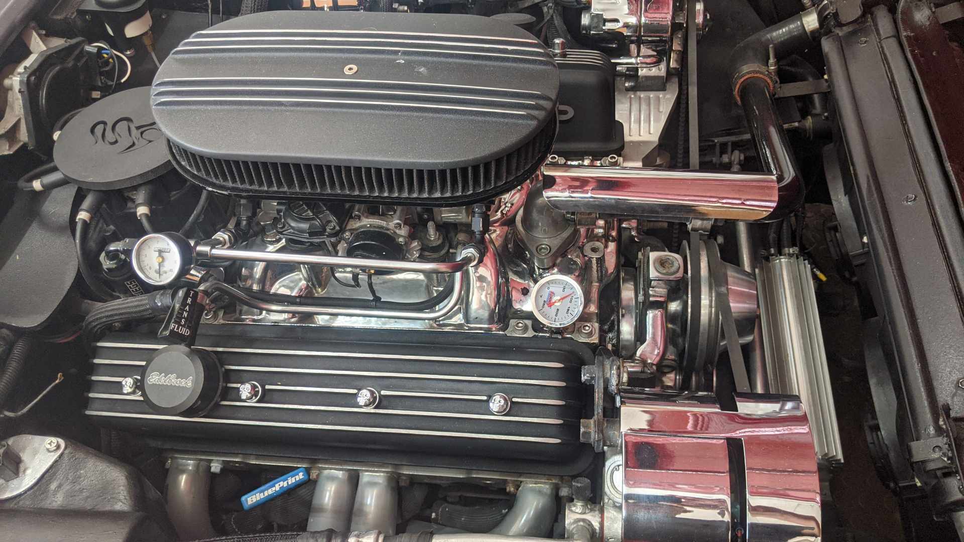

79 temp gauge seems to be reading high. Verified with a temp gun. Whats most likely the problem, gauge or head sensor. Or is it 50/50?
Car has always ran on the cool side. (Dewitts radiator with electric fans) I have a direct screw-in liquid filled gauge ordered to double verify.

Sorry, the way I worded it was confusing, Temp gun reads 180 and gauge shows close to 220.

Added a temp gauge directly to manifold and idled car without fans till interior factory gauge hit little over 220. Manifold showed around 195-200. IR gun was lowest of all 3 and I don't put much trust in it (Its a cheap one).
Both gauges matched close till car got warmed up well.
I'll keep a eye on it but it seems car temp is fine.

I have that same log cooler you are using...I use mine to cool my fuel...Im switching to an electric one this winter

Might sound crazy but I use it as a PS fluid cooler. My Borgeson is almost touching my side pipe headers. I have a heatshield between them but added the cooler hoping it would do some good.

Well dummy finally figured it out. It was just a stuck thermostat. Only reason the car didn't run too hot was that the thermostat had holes drilled in it. Just enough flow to keep car around 220 head temp and to make me think it was something else. Anyway I replaced it and car is back to running on the cooler side. "Keep It Simple Stupid"
