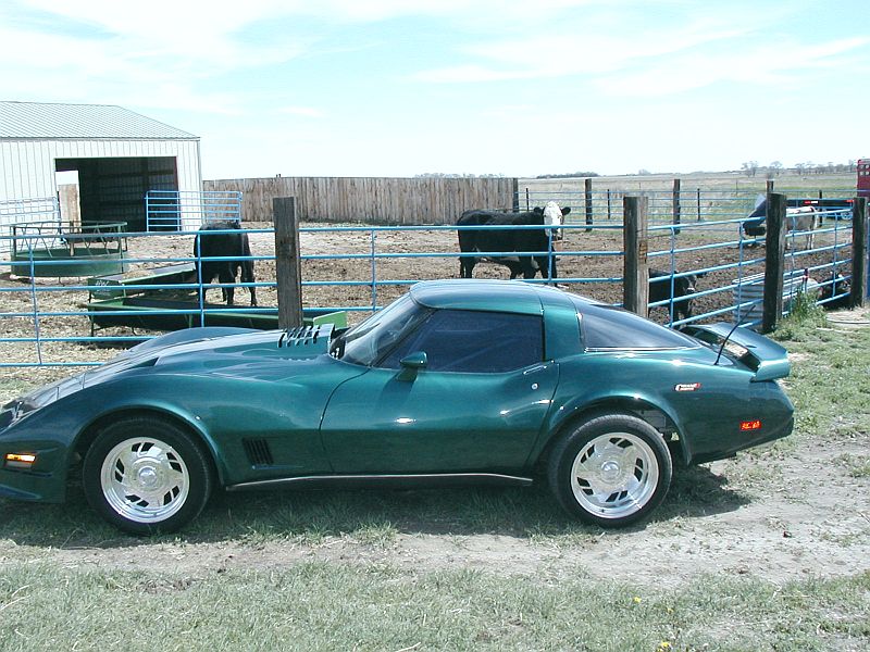

I have Centerline 17 inch wheels that i bought 30 years ago. The problem now and even worse in the future is limited tire choices. My street 17's are 255 or 275 fronts on 9 inch wheels and the rear I started out with 285 and then 315 on 11 inch width which is about the max without adding fender flares. Then I added flares and went to 17X13 width and 345 rear tires.
old picture with 315 rears before flares, I just put a couple of bails of hay on the rear and haul them out to the cows.
