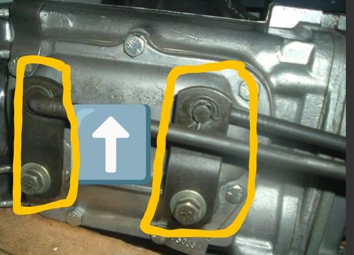

So I have a 4 speed super t-10 I'm putting in my 68 from a 77 Camero z28, it's temporary so I can drive the car this summer while I save $ for a Muncie m20/m21.
Which way do the levers go, up or down?

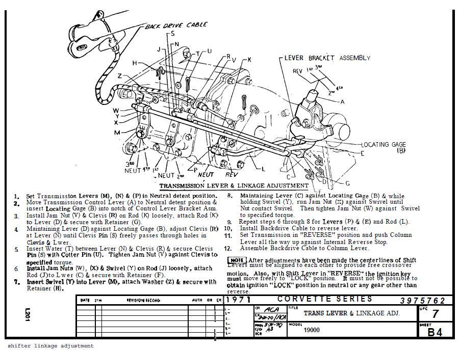

This is the setup for a "71 muncie. Not sure about the T10. This is form the AIM. Assembly Instruction Manual. It's the book the factory used to assemble and it a must.
You might need to make the index tool (my homemade one shown)

Thanks theandies! I have an aim for my 68 I just didn't know if the t-10 was different either. It's in the car and the shift lever things are up

Originally Posted by Mdbirk
It might be, I used it as a reference, that picture is actually from Google. So do the levers go up or down?
All go up
