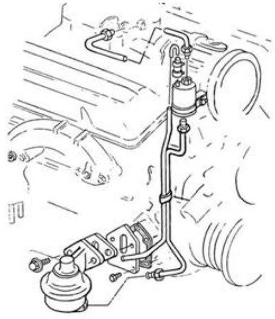

1969 350/350 came with only 2 lines on the pump. The return line connected to the fuel filter which had 2 outlets a 3/8" and a 1/4". The 1/4" had a short hose connected to a pipe which ran down to the frame rail where the return line is located. If you have a 3 port pump it is wrong. Google GF432 fuel filter.

Do you think your Corvette was originally set up like this?:
That's correct for a 69 350/350 but the poster doesn't appear to be aware of that.

I think it was. This is my third 69 vette and the other two were exactly like the drawing. Ive had this one for ten years and it came without the filter shown. .I can not find the pictured fuel pump on line.
