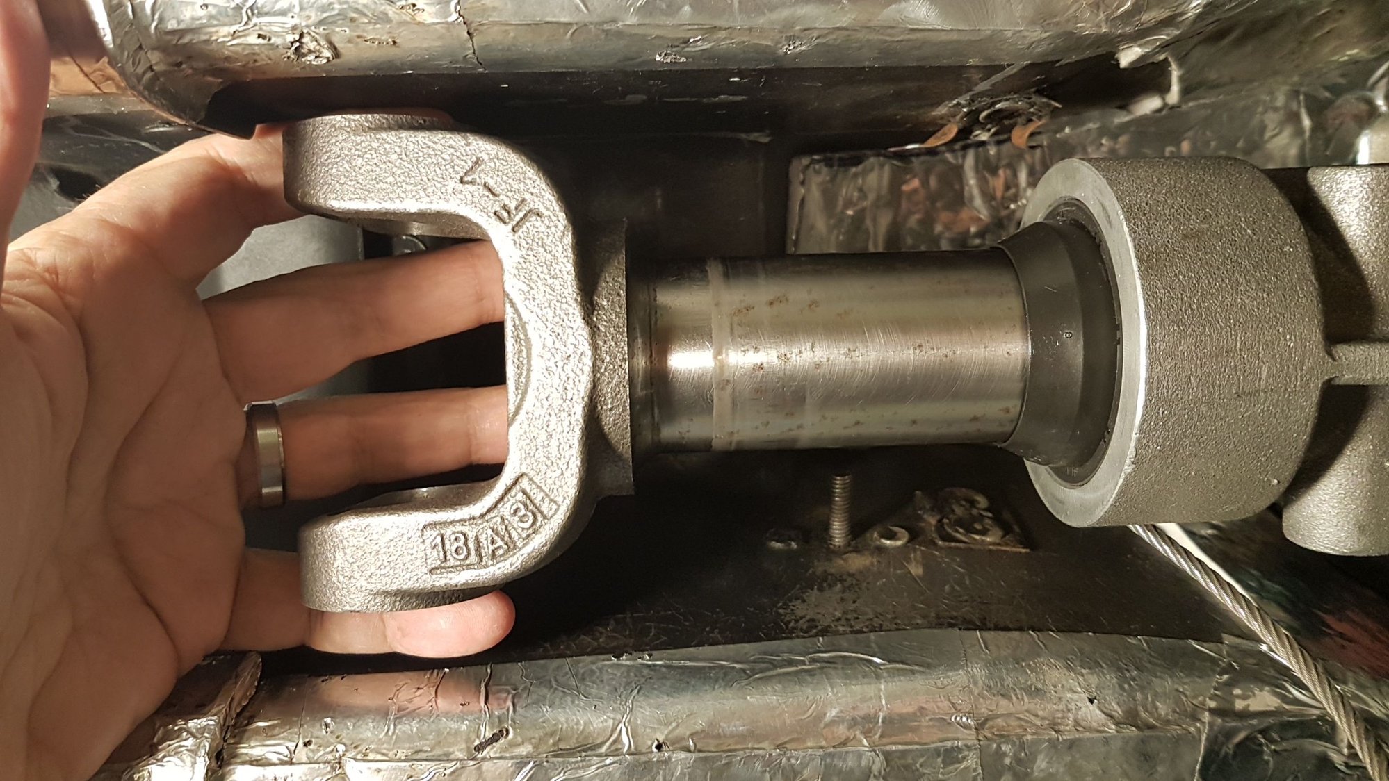

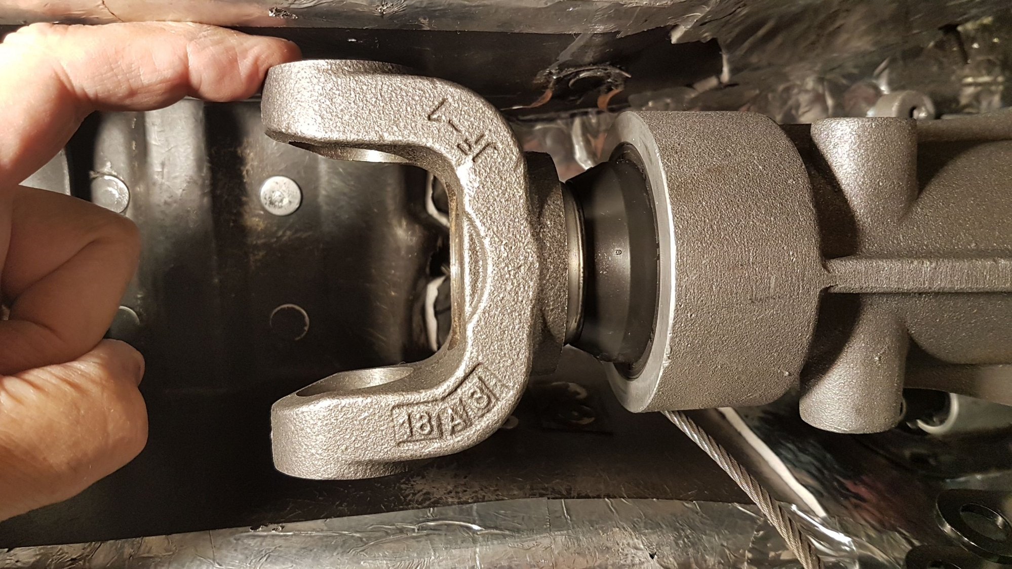

The 6-speed install might have worked without the tunnel modification as long as the engine and trans didn't move. But we know that doesn't happen. So I gave it just a little extra wiggle room by cutting and patching the tunnel.
1350 Slip Yoke fully retracted. Tight clearance!
Slip Yoke fully extended. Tighter clearance.
Window in Tunnel on passenger side.
Aluminum sheet metal pop riveted in place.
A little extra clearance on the passenger side.
Less than a "finger" clearance, but it works fine.

How do you plan on getting the driveshaft in without the front being a split yoke?
How close is your parking brake cable? I moved mine to be sure I had enough room
The slip yoke shown was just an ordinary cast "test yoke" supplied by the good guys at Silver Sport Transmission. They allowed me to return it without a restocking charge
Once I proved that a 1350 u-joint would work, I bought a quality Mark Williams forged split yoke for the final assy. Same quality at the rear end with a 2-1/2" CrMo driveshaft in between.
I don't remember the parking brake cable being a problem. The cross member supplied by SST may have the brake pulley in a slightly different position. The picture shows the brake cable on the slip joint because it's not connected.
