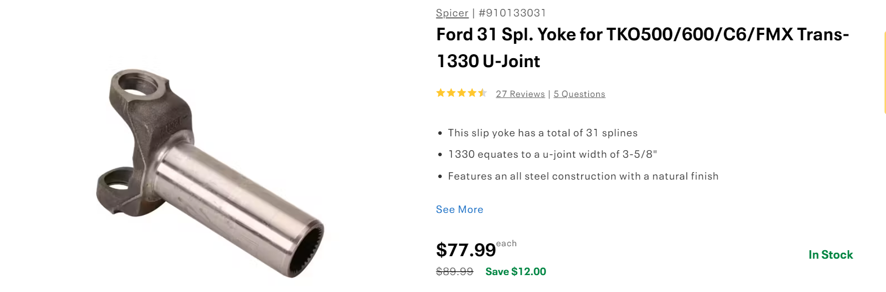

There is no 31 spline (Ford/TKX) yoke on the market that has a bolt together joint, for a 1330.
This is the biggest hassle if you did not buy the complete kit.
Inland has a 1 piece slip yoke, that's it, in 1330.
So are you looking for 1310 or 1330 u-joints?
You have a couple of options in 1310. I even have a part.
In 1350 there is a very expensive Mark Williams slip yoke out there that bolts in.
Try to get the whole driveshaft from American P?

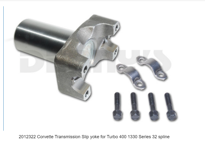

I heard of a guy who made a 1330 bolt together front u-joint setup.
I plan on talking to my local driveshaft shop about that one.
I will keep you posted.
I have 550 ft-lbs, so no 1310 for me.
I know the 1350 version is stronger and may be easier, but I am really trying to stay away from permanent body mods.
I'm OK with a few bolt-on mods.
This is the Corvette version of the TH400 yoke, which bolts together. I will ask my driveshaft shop if they can flip this around and weld driveshaft tube to it. At least one guy has done this. Cut it down, weld on a sleeve, whatever.
